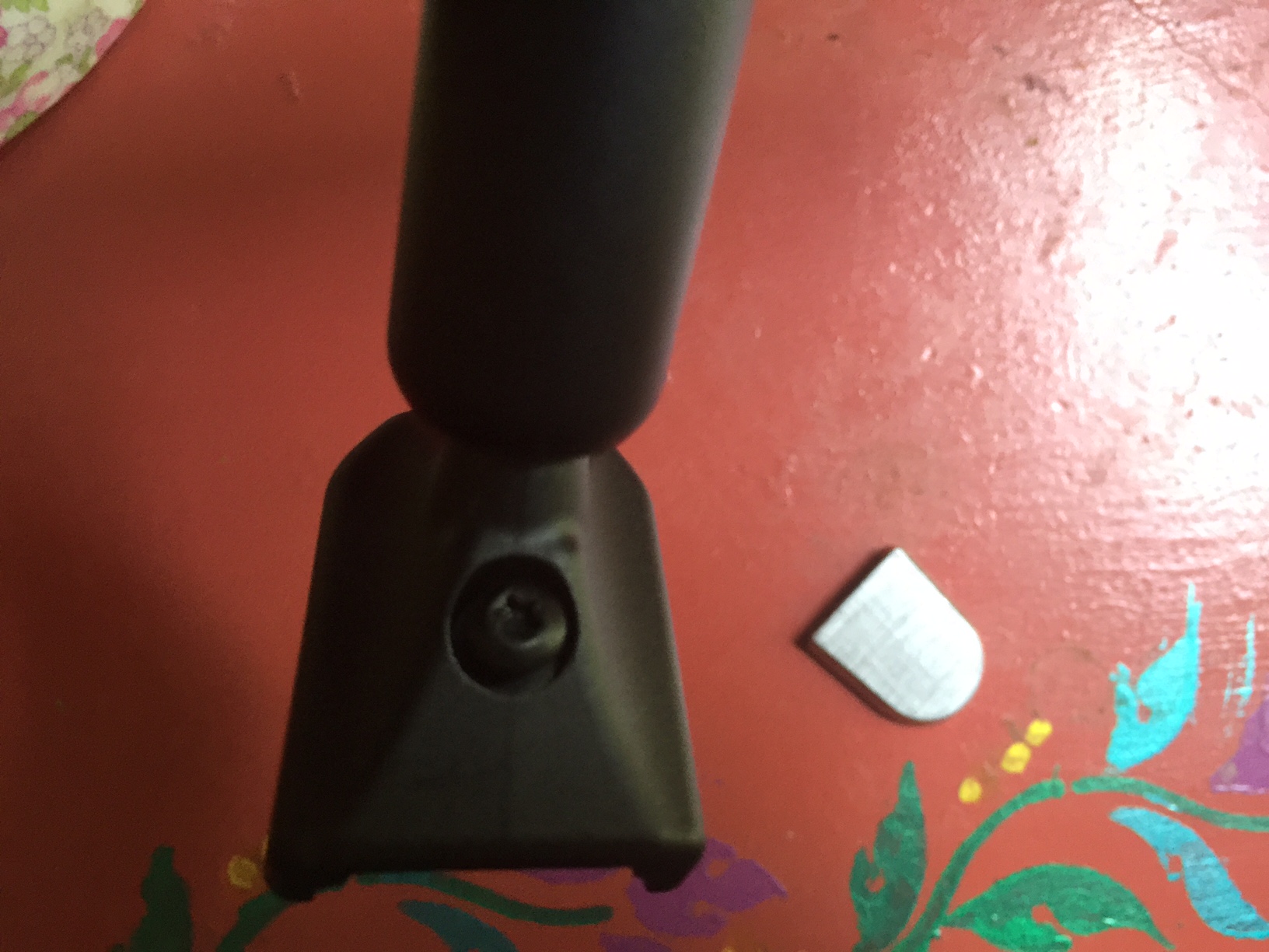

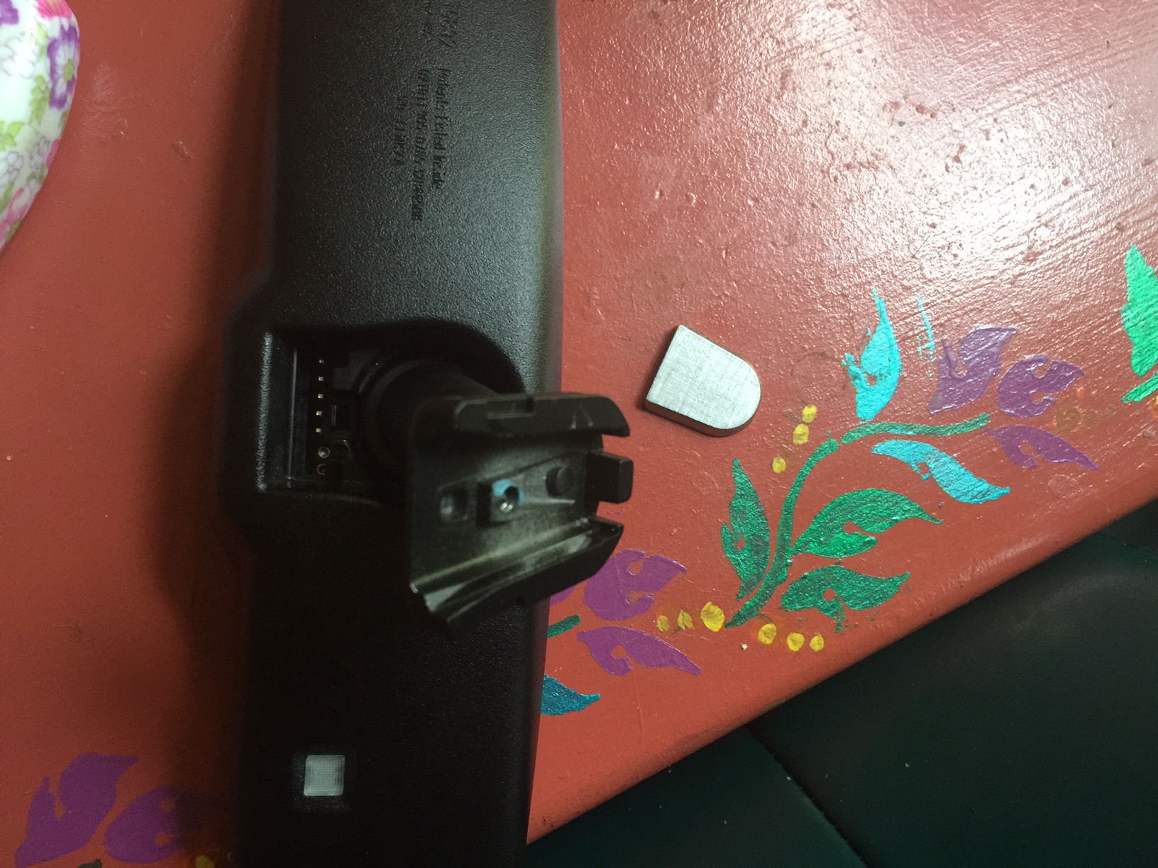

I have cleaned the glass, and am now going to see if I can get the "button" out of the mirror mount -- will have another look to see if the cord has any point at which I can disconnect it. If this all works, I'll post what I did!

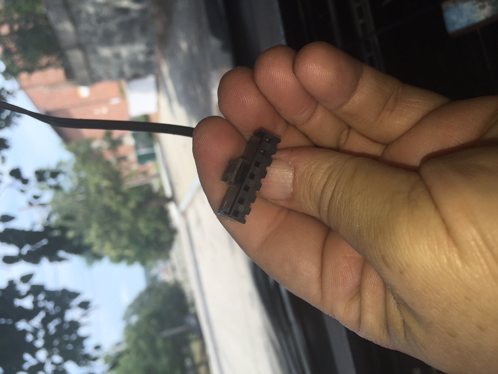

I was able to get this done -- assuming the adhesive holds! Turns out the "button" is held in place not by a sprint, but by a set-screw that takes an Allen wrench -- it actually is much preferable, as when you re-attach the mirror to the button, you don't have to use any force. The wire also turned out to be connected to a mini-wire-harness in the base of the mirror, easily removed with a little tab. Fingers crossed that it's a permanent fix (I used 3M rearview mirror adhesive).
