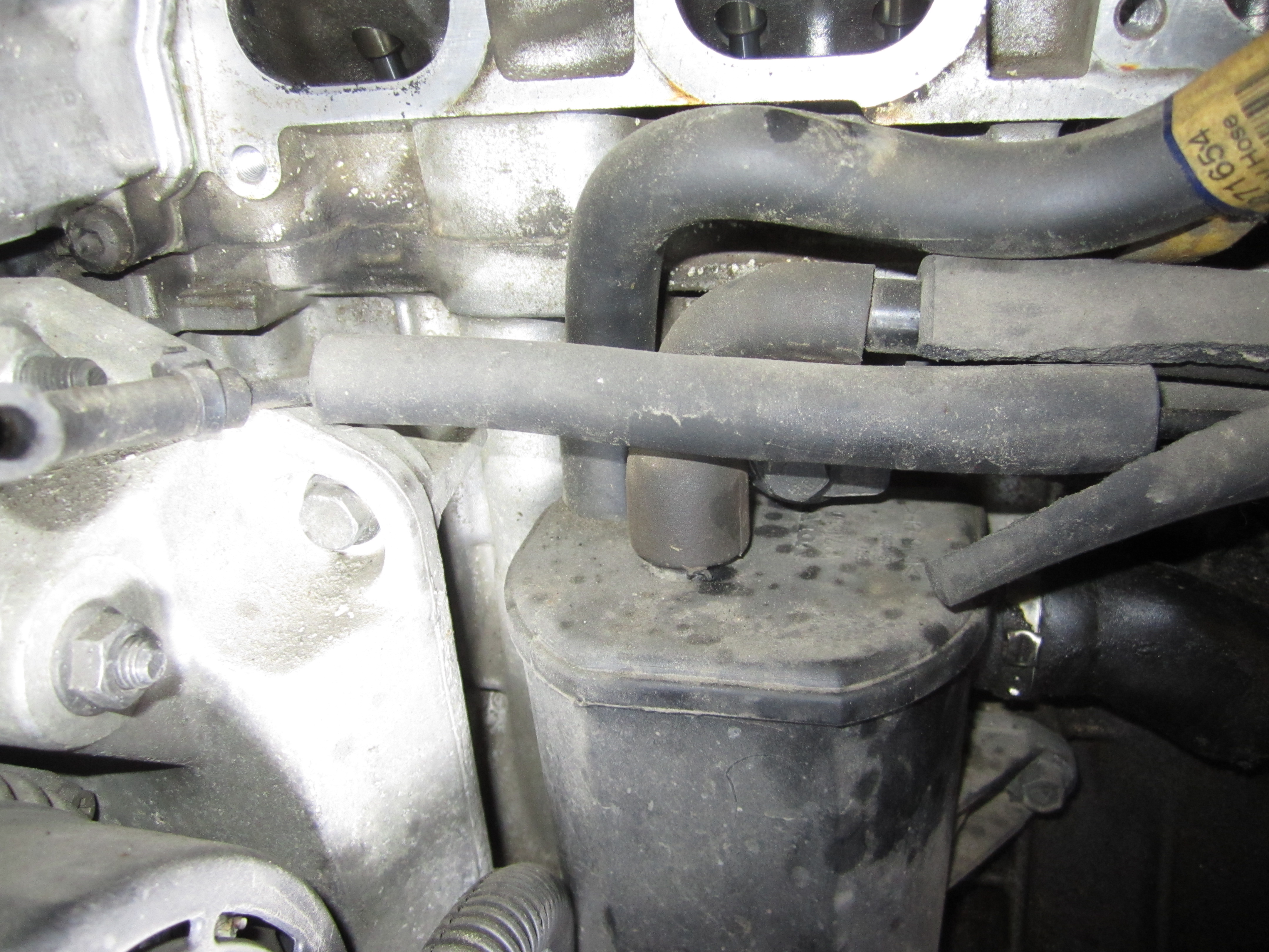

The history claims the car was at a repair shop in town here in Calgary where it supposedly had the PCV system serviced. All superficially looked good including the Volvo part # sticker on the pipe from the catch tank to the top of the cylinder head. There was oil leaking from the oil filler cap which had the hardest oil seal I have ever found on one of these cars, and it leaked well. On looking further I found the 2 parts of the flame trap unit were not connected at all, also leaking oil nicely. But some of the oil on the front of the engine I couldn't see where it was coming from.
I was in 2 minds if I should pull the intake to investigate further, when I removed the spark plug cover plate, I found no clamp on the PCV pipe to the top of the cylinder head. So off came the intake, and I find that all the parts of the PCV system apart from the tip pipe are probably the originals. Car has done less than 20k miles since the work was supposedly done, but all the other pipes are brick hard. There were no clamps on any of the pipes except the short pipe into the block, and these look original. The pipe is absolutely hard! The short pipe at the bottom is a style I have not seen in years. A short 1" piece of rubber pipe and 2 ring clamps. The system was leaking from this nicely.
Top of PCV oil trap - no clamps

The receipt lists all the parts (but no clamps) but even the trap is filthy inside. Fortunately the system appears fairly clean otherwise. The 2 pipes from the flame trap to the PCV trap and the left end of the intake are also original I'd guess. The foam covering it is badly frayed.
Bottom line the PO was ripped off and I am out a bunch of money and added work re-doing sloppy work.
