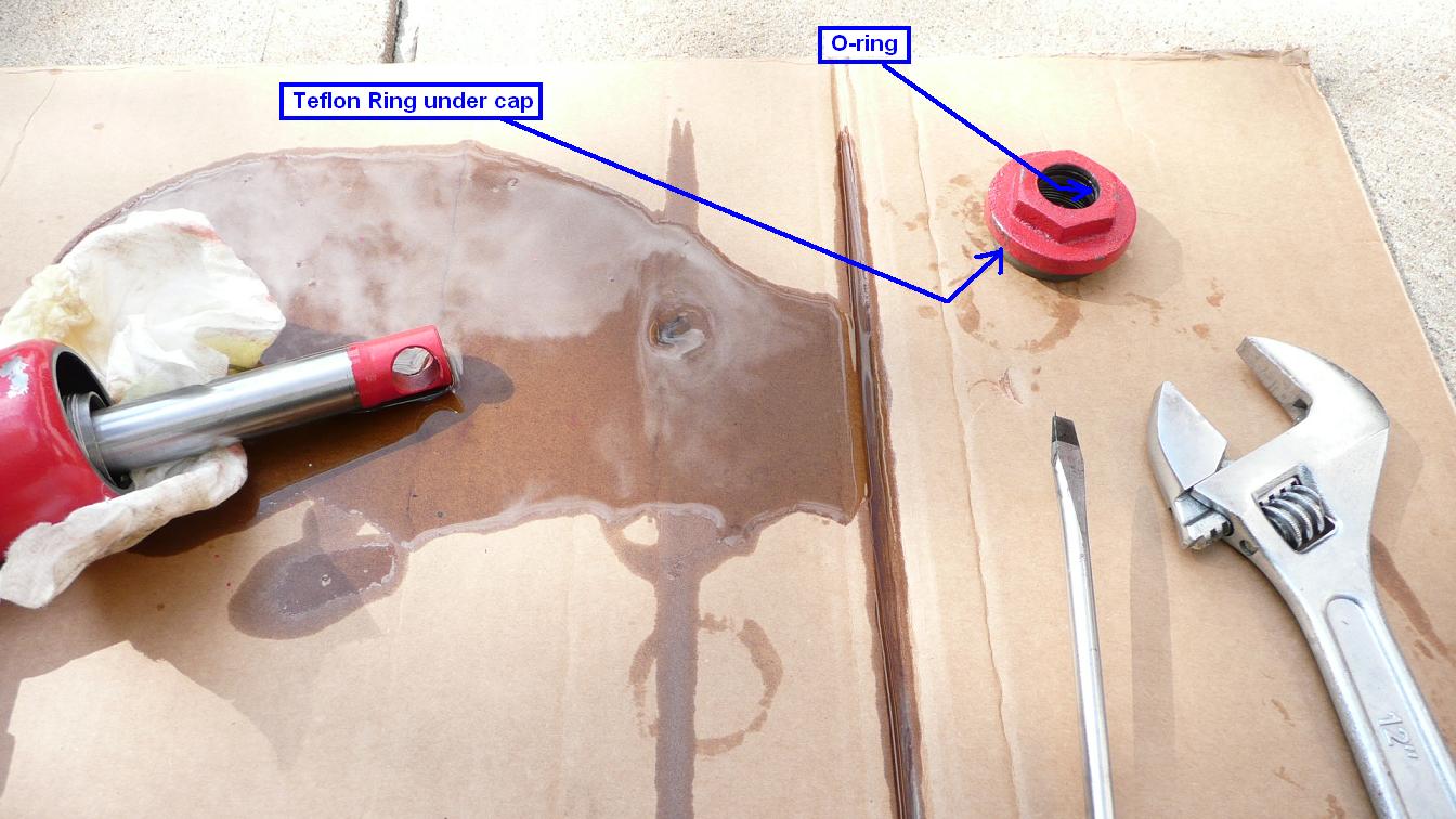

There is lack of info on hydraulic floor jack rebuild in forum, so I decide to write a short DIY.
If you fix your floor jacks, please share your photos etc. Make sure you post brand name of the jack and photos.

3. The Oil Chamber (reservoir) is #21. Oil leak is prevented by:
- Teflon O-rings #20, #23. These Teflon rings are very robust and should not leak at all.
- O-ring #19: this was my problem. After a few days in the garage (not using jack at all), it leaks from the O-ring: a few drops on the floor.
Factory O-ring is: 21 x 3 = 27 mm total.
I used O-ring with: 20 x 4 = 28 mm total: zero leak afterward!

Actually once the cylinder is opened as in my photos above, the master cylinder O-ring is right there.
So not much more time involved.
However, finding that O-ring (part numbers #2 and #3) may be a challenge.
