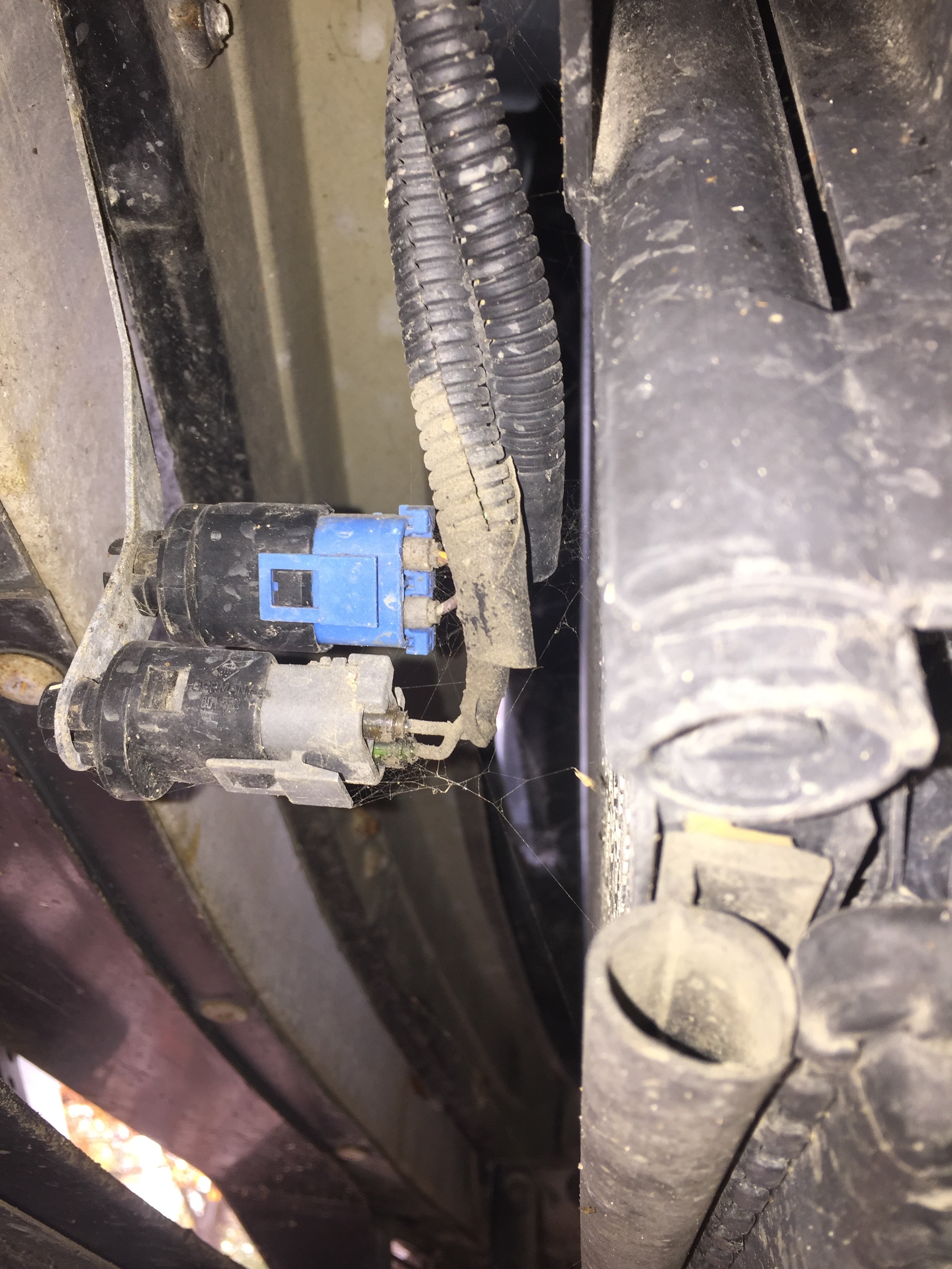

This p0112 code causes a lot of confusion. I think this is what is going on. It is true that on a 98 the MAF calculates intake air temps, but that function has nothing to do with the p0112. I am pretty sure that on m4.4 cars, the p0112 traces to the temp sensor "with the blue connector." On a 98 it is usually on the passenger side of the car, up front near the little grill in the bumper:
By the way, this is the exact same sensor part that is plugged into the gray connector over on the driver's side, for the ambient air temperature (AAT) display on the dash. So there are two of these on the car, but p0112 relates to the blue-connector one. I don't know if this IAT actually figures into engine management; is the fuel economy bad now that you have this code?
Here is a shot of both sensors on a 97 850, but they will be on separate sides of the car on a 98: Course of action for me would be to examine/clean/unplug/replug the sensor on the blue connector. If that doesn't fix it then likely the sensor itself is bad. The sensor is the same part as the ambient temp one (gray connector), so just swap them around to test (assuming your in-dash temp display is working OK?). The dash display will go to -40 if the sensor is disconnected or bad, and the p0112 code should go away if the other sensor and all the wiring is good.
Please let us know what you find!

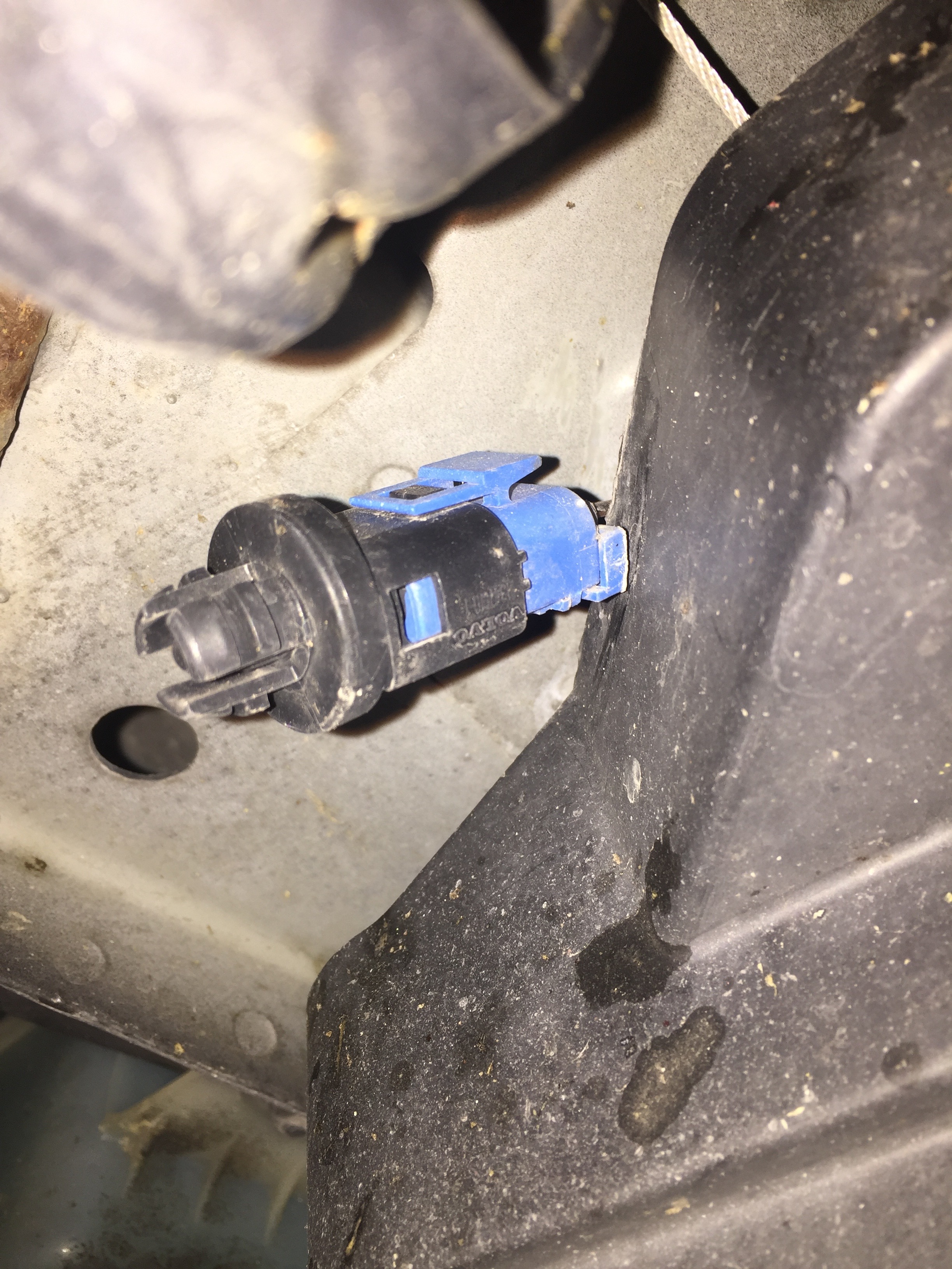

I don't have that blue sensor on my M 4.4...at least not at that position.erikv11 wrote: Here is a shot of both sensors on a 97 850, but they will be on separate sides of the car on a 98:
There are two holes on the carrier,but only one sensor is attached there.The grey one.
Is that only for turbo models?
