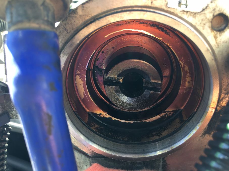

Hi folks
Can you please take a look at this picture and tell me if there is such a seal in the rear intake of my Volvo C70 2002 turbo? If there is, do I have to use the Volvo tool 9995919 to pry it out like the rear exhaust end?
I am in the process of replacing front and rear intake and exhaust seals because of leaking oil. There was some oil when I removed the cap cover of the rear intake so not sure if there is a seal there.
TIA.

The cover that you pried out is the seal, if you did any damage to the cover you should replace it. 1397381

I added a standard seal to mine that goes behind the cover plate. The seal is the same as the exhaust seal. Getting the cover plate off without damaging it is nearly impossible and I don't trust the setup.

Thanks bskeels and Lee.....Yeah, I've added the the same seal in there as well. Just started the car and seems to be fine. Idle is the same as before and rev as normal so just need a test drive.
No way to get the cover cap off without damaging it. This is the reason why they make the center out of rubber I think. Anyhow, got the replacement cap on hand as I know I will damage it during the removal process.
