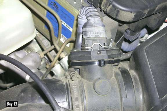

It could be that connector needs to be zip-tied.It's common failure on this cars.

Did you try zip-tying it's connector:
You have few possibilities here:
-bad maf right out of the box(less likely)
-huge vacuum leak somewhere(more likely)
-bad maf sensor's connector(common fault on these cars)
