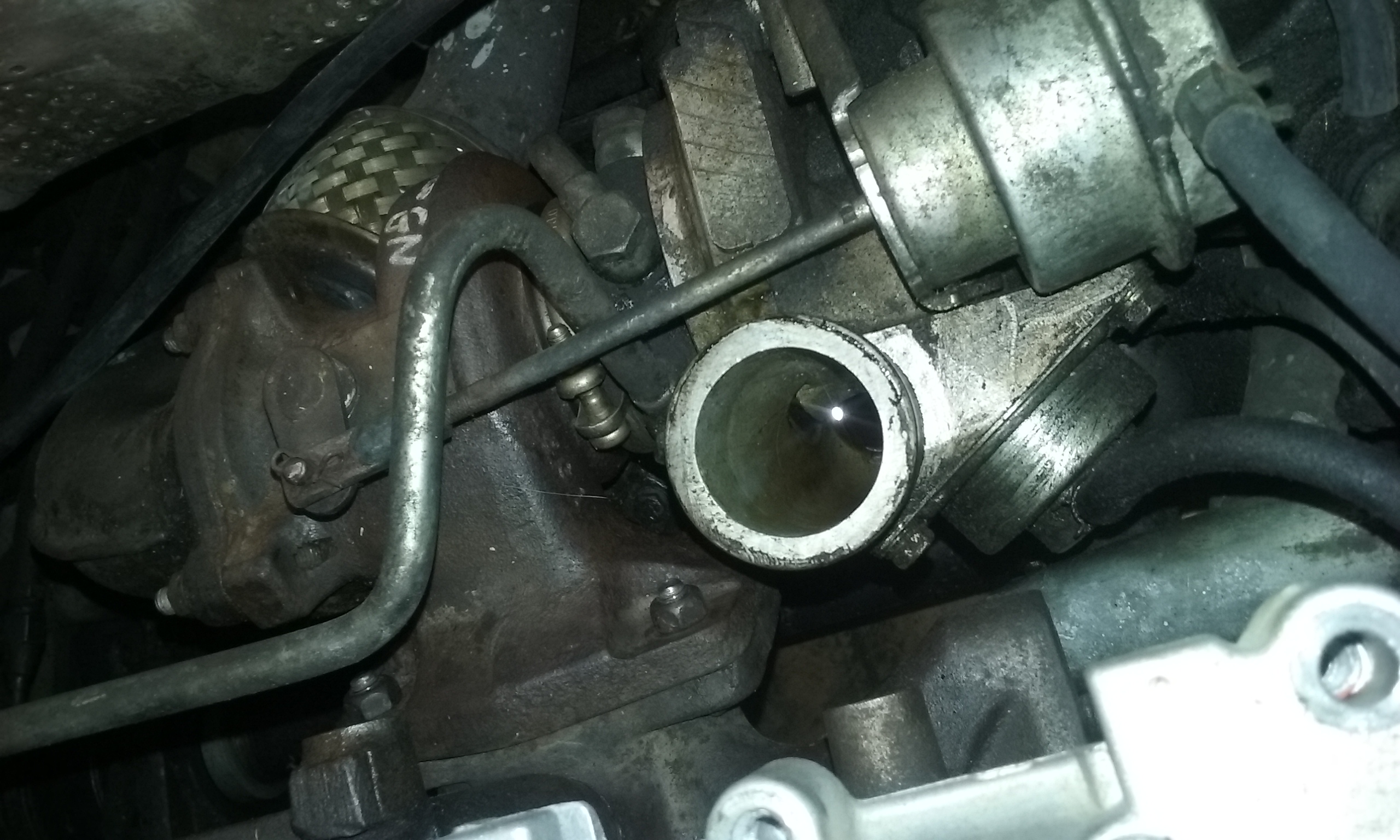

So gentlemen, i messed up, see that hole? That's where I dropped one of my upper cylinder head bolts, since then I realized I need to put a rag in it. Anyone know if those bolts are magnetic? I will go to an auto parts store and get one of those magnets on a stick if someone thinks it will work. If it doesnt, any ideas on how to get it out? It looks like a major choir to take that whole part out just to shake a bolt out. Thanks

The nut most probably is magnetic. If not, there are claw shaped grabber tools that can pick up non magnetic things.

Magnet will get it. I got a great one at Lowes which I used 28 times doing by BMW crankcase service
