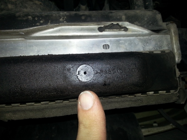

I put some pressure to it and found a hole in the bottom of the intercooler that looks like it was manufactured that way. My parts car has the samr hole but I have not pressured it up yet to see if it leaks.abscate wrote: You probably have a hole or loose clamp in the induction path between the turbo and the throttle body. You've got a lot of symptoms pointing to that.

That hole is okay, it's the weep hole that lets out moisture and small oil seeps. Plug it with gum or your finger when you leak test

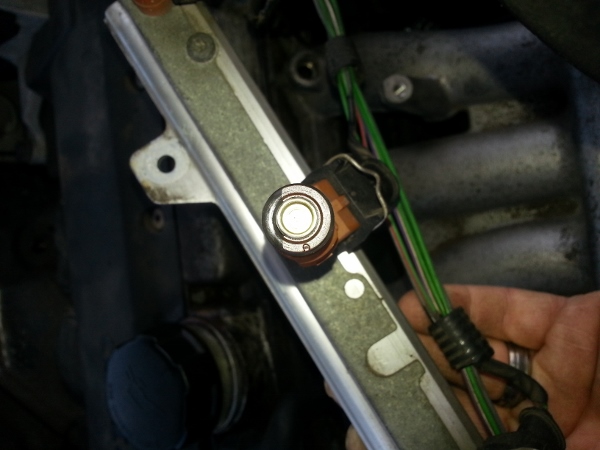

Fixed vacuum lines and took out the intake to verify all the connections. Got it all back together and there is no change. MAF should be here by Thur. Hope that fixes it. Any other things to check out?
Almost forgot. Two injectors have the plastic in the outside of the tip broken. Looks like the previous owner wasn't careful enough when he took it apart. Could this contribute to the issues?

I popped an intake hose once and it took about a week of driving to get my power back after disconnecting the battery overnight and tightening all my hoses up again. I don't think the plastic bits on the injectors serve much a purpose besides keeping the oring on and taking up space but I might be wrong.
