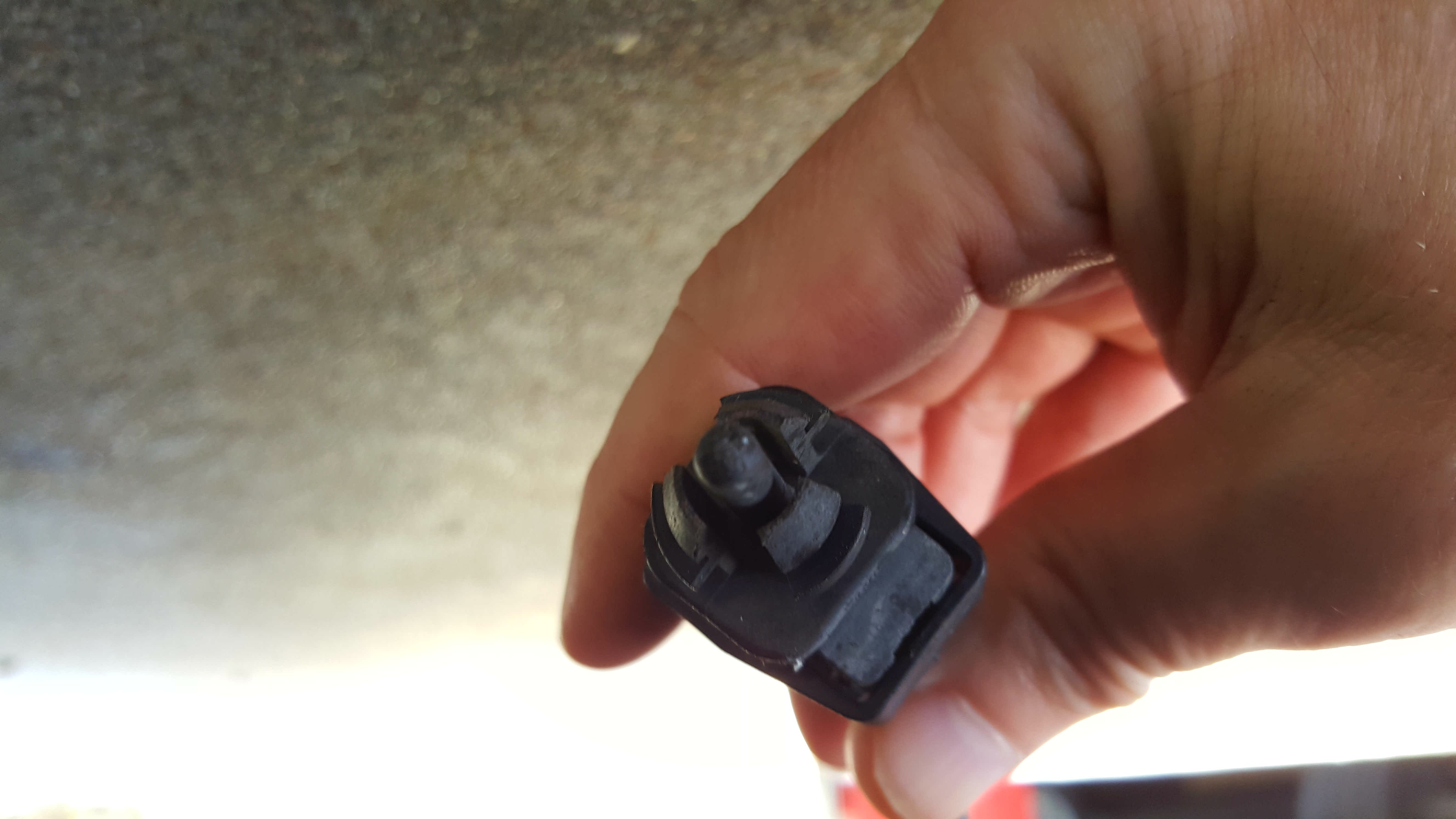

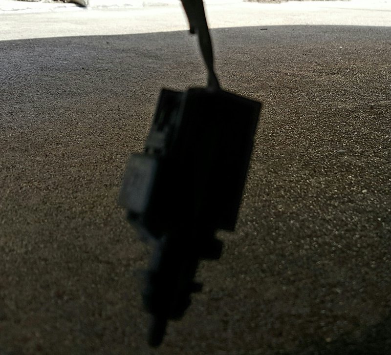

This is a '99 C70 LPT convertible. I have 2 of these plug looking thingies just kind of hanging there on each side of the front end? I have no idea what they plug in to. They have 2 electrical wires wrapped in corrugated insulation. Everything up front works like normal as far as the fogs, headlamp wipers and washers, so any help on what they might be for and where I can plug them in to would be greatly apprec...

Back to your question: is that the outside temperature sensor? Looks like that to me

Nah, front wheels are turned slightly to the left. That car is still an awesome work of art! Outside temp sensor works fine. Always reads correct temp all the time.

That's ambient temperature sensor.It's holder is in the front bumper opening where it just clips in.
viewtopic.php?t=74374
Driver's side for outside temperature readout display,passenger's side is outside temperature sensor for ecu.

They clip into an undamaged airguide

Wow! Thanks for the prompt replies. I'll need to get in on the ramps and reinstall them. Hopefully the airguides are still in tact. Thanks again for all the help!
