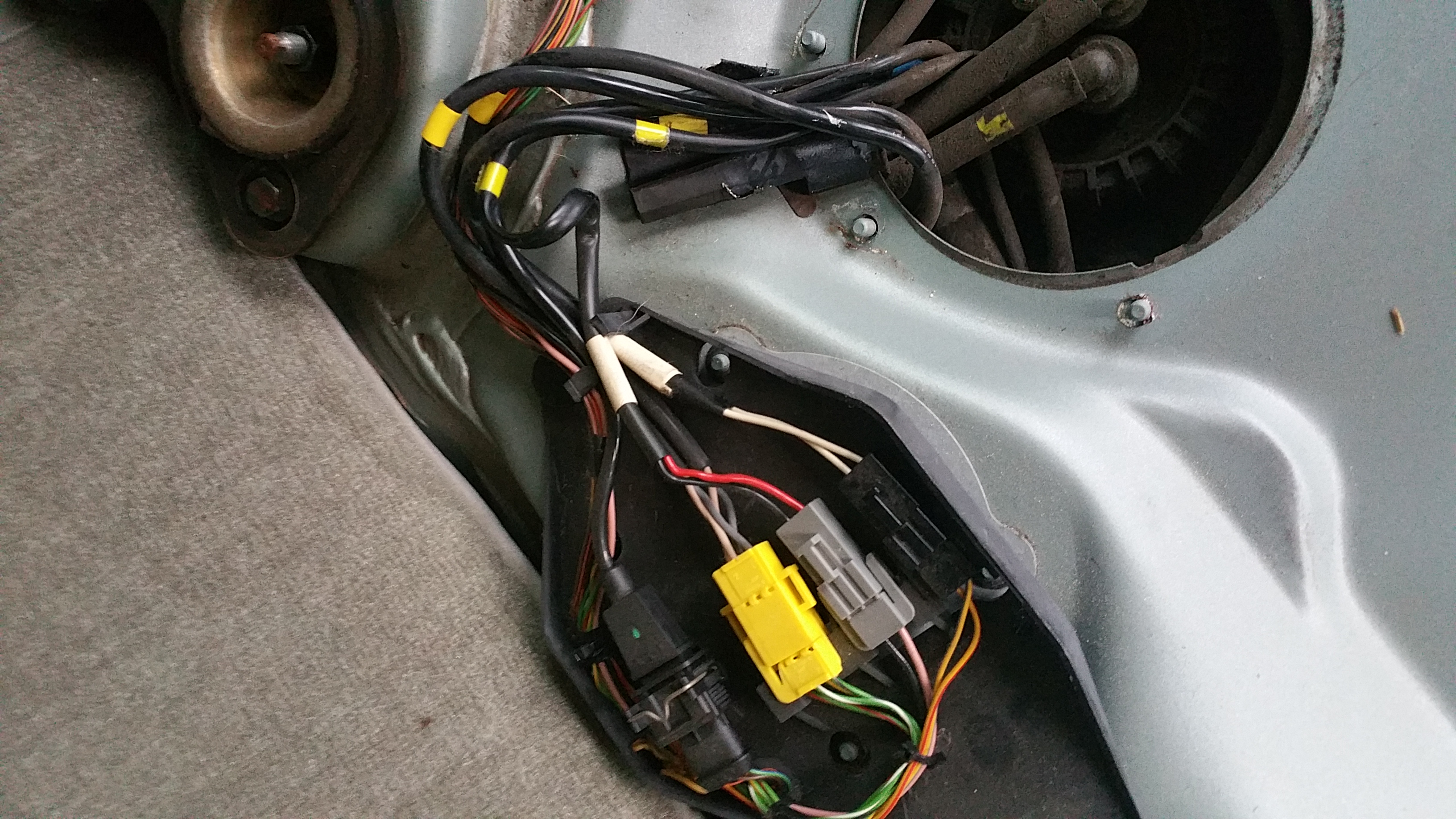

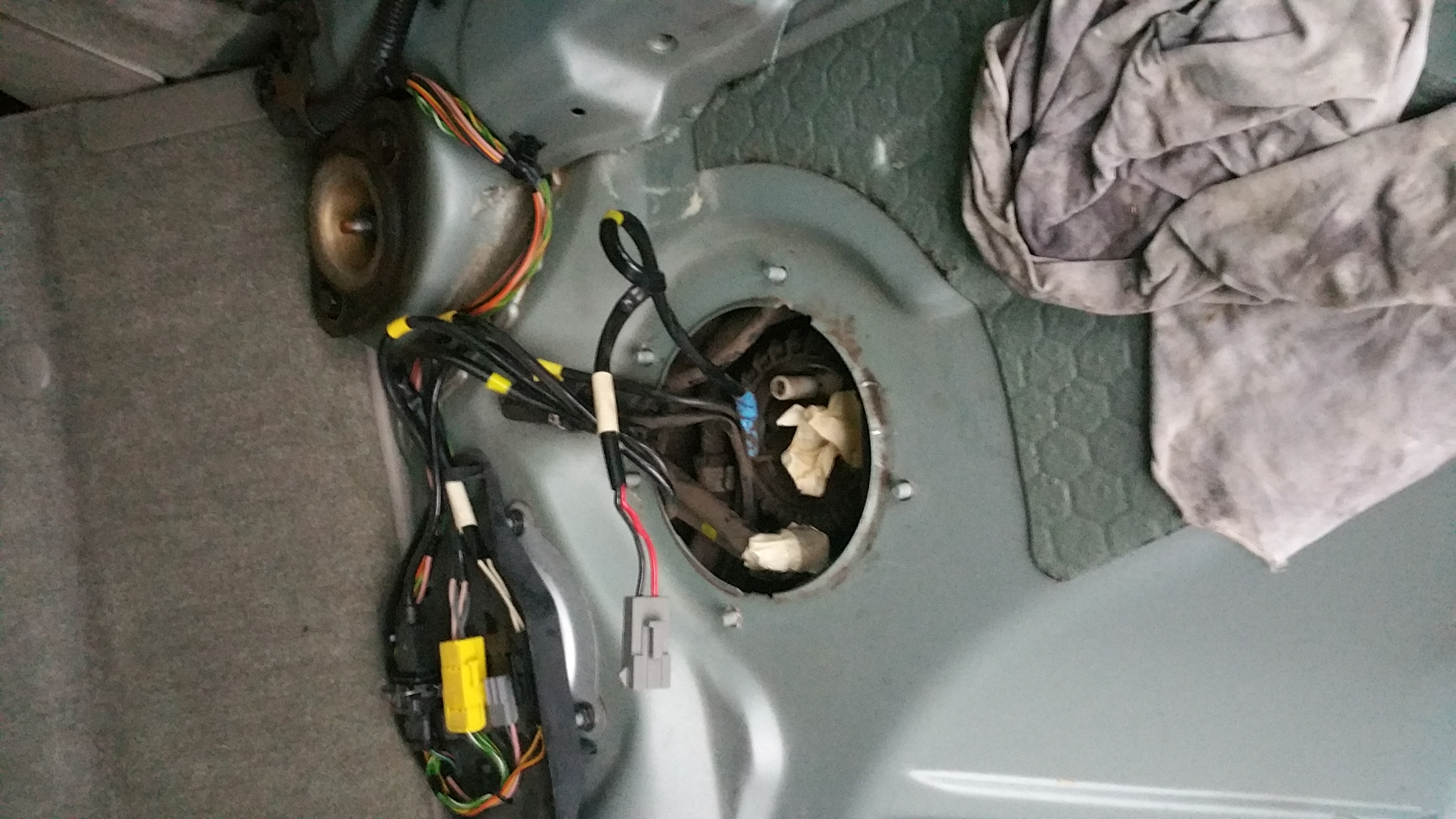

Hello all,
I need to replace my fuel pump and got the after market pump today. Removed the fuel lines and unplugged the socket. Noticed that the new pump has this small white socket that the original one doesnt have. Any idea what this socket is for? Is it for ground? Or possibly a wrong part?

Extra ground. Just ignore it.

what is that reddish orange rubber nipple used for?

The nipple is the return line for fuel coming back from fuel rail.
