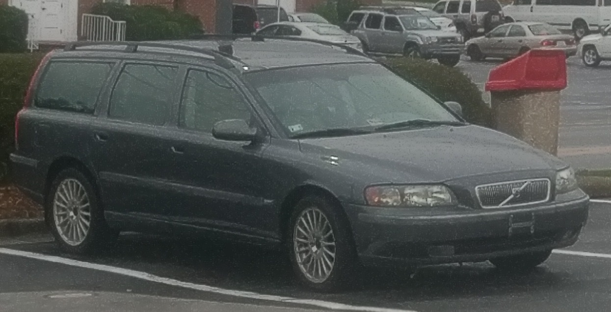

Sven on the way home.
I picked up a well trod 2003 V70 T5, named Sven. It ran fine, but had a massive 2-3 and 3-4 shift that if it caught you off guard would try to rip the car out from under you. Additionally some of the down shifts nearly stopped the car and put me up against the belts at times. Driving it in Geartronic (manual shift) Mode helped as you could feather it between the gears going up and shift down at the stops. Forget up shifting in the corners... it was scary coming out! So, with the help of the MVS gang, I set about the basics to try and recover Sven's trans without replacing it.
