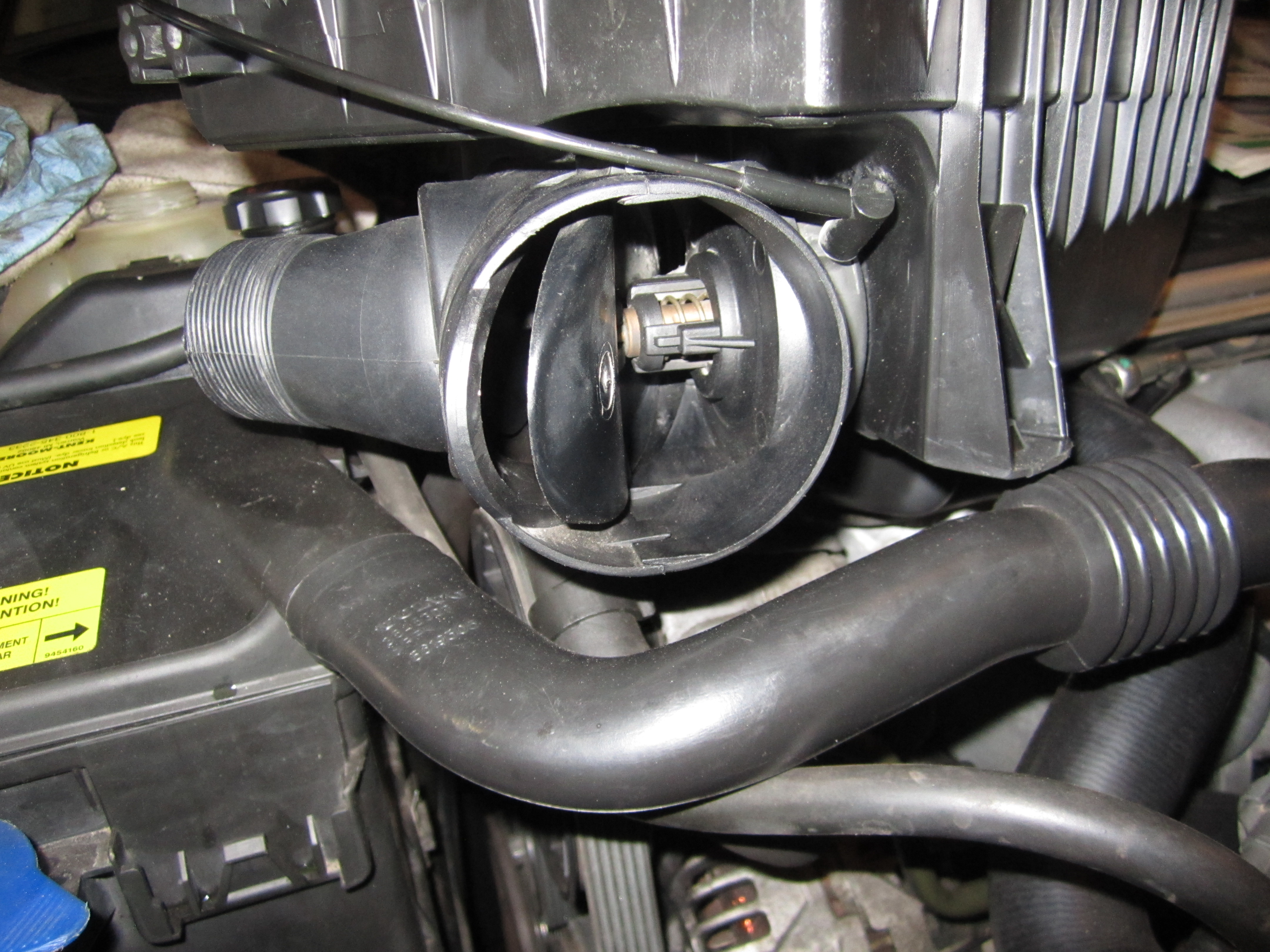

I'll try to take some pictures as the link has a P2 air box which is different. My car is a P80 2000 V70 NA/base. It has 2 flaps, one for cold air and one for hot air. What I don't understand is how does this work and what determines what position (clearly temp.) the flaps should be and at what temperatures. The cold flap is nearly 100% open and the hot air looks like 50% (?) perhaps.
Ideally what I would like to know is what are the operating parameters for the 2 flaps?
Pictures to come.....!

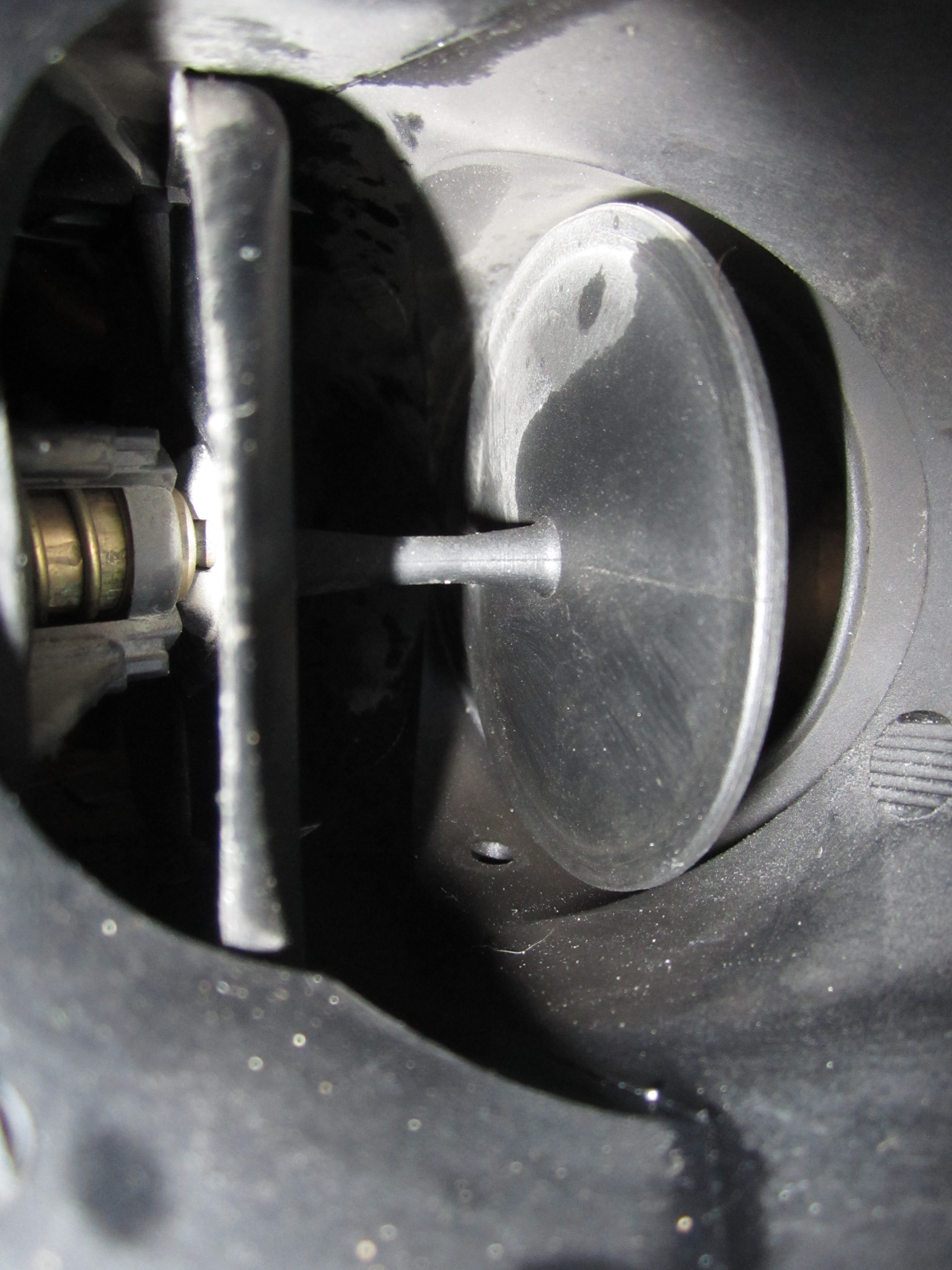

So took some pictures of the air-box flaps, so appreciate is anyone can confirm if these are in a normal position for the ambient temp in my garage (today at approx. 15C/60F):
Picture above is taken from internally within the air-box looking at the back of both flaps.
Thanks,
Thanks,

I was at the scrap yard this morning and there was a 2000 S70 NA there so I yanked out the air box to have a look at it. The flaps looked more or less like your photos. Temp was upper 60s at the time.

Perfect and many thanks! I was also at PnP this morning and there was a matching 2000 V70 NA and someone had already disconnected the air box so I took a look at it as well and it looked the same too. So I guess they are either all wrong/bad or all good, but maybe I can find out some method as to how they work and what the temp markers are.

This is exactly what I removed out of my brother's 98 V70 yesterday. It, like mine, was stuck on the hot side and choking the life out of our engines! I can't for the life of me figure out how to remove the thermostat piece so I just left it there. I suspect that a bad thermostat sometimes makes a weird "spring-like" popping sound from the front, driver's side of the engine... I suppose I can cap off the vacuum line that operates the spring, no?

Have you tried to remove the insert that holds the flap? If it is similar to mine, there are 2 x detent flaps inside the air-box lower section. One on the top and one underneath. Depression those should allow the whole flap portion to slide out (I'm sure with a lot of persuasion!!). That may then allow you to remove the thermostat. I don't see it listed as a separate part, but like any thermostat I'm sure they have a life span.
