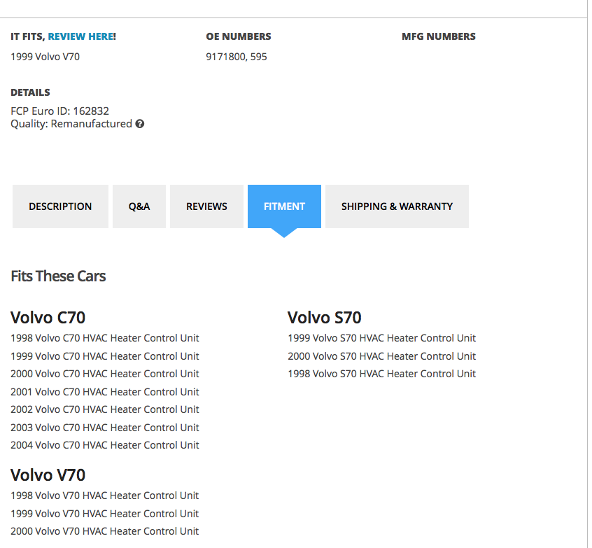

And FCP reports, in fact, they are the same
Screen Shot 2017-05-24 at 3.45.27 PM.png (109.45 KiB) Viewed 1721 times

This is kind of surprising since mid 1999 year, the damper went to the one motor style - but apparently the ECC can figure out how to work with both?
