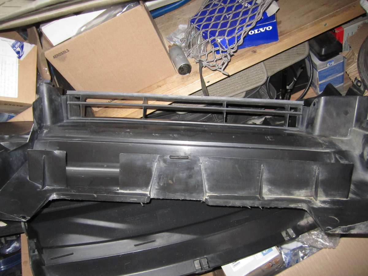

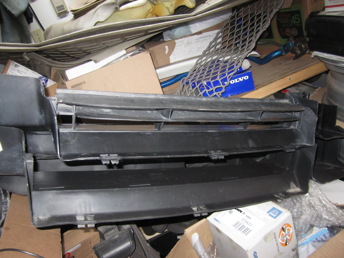

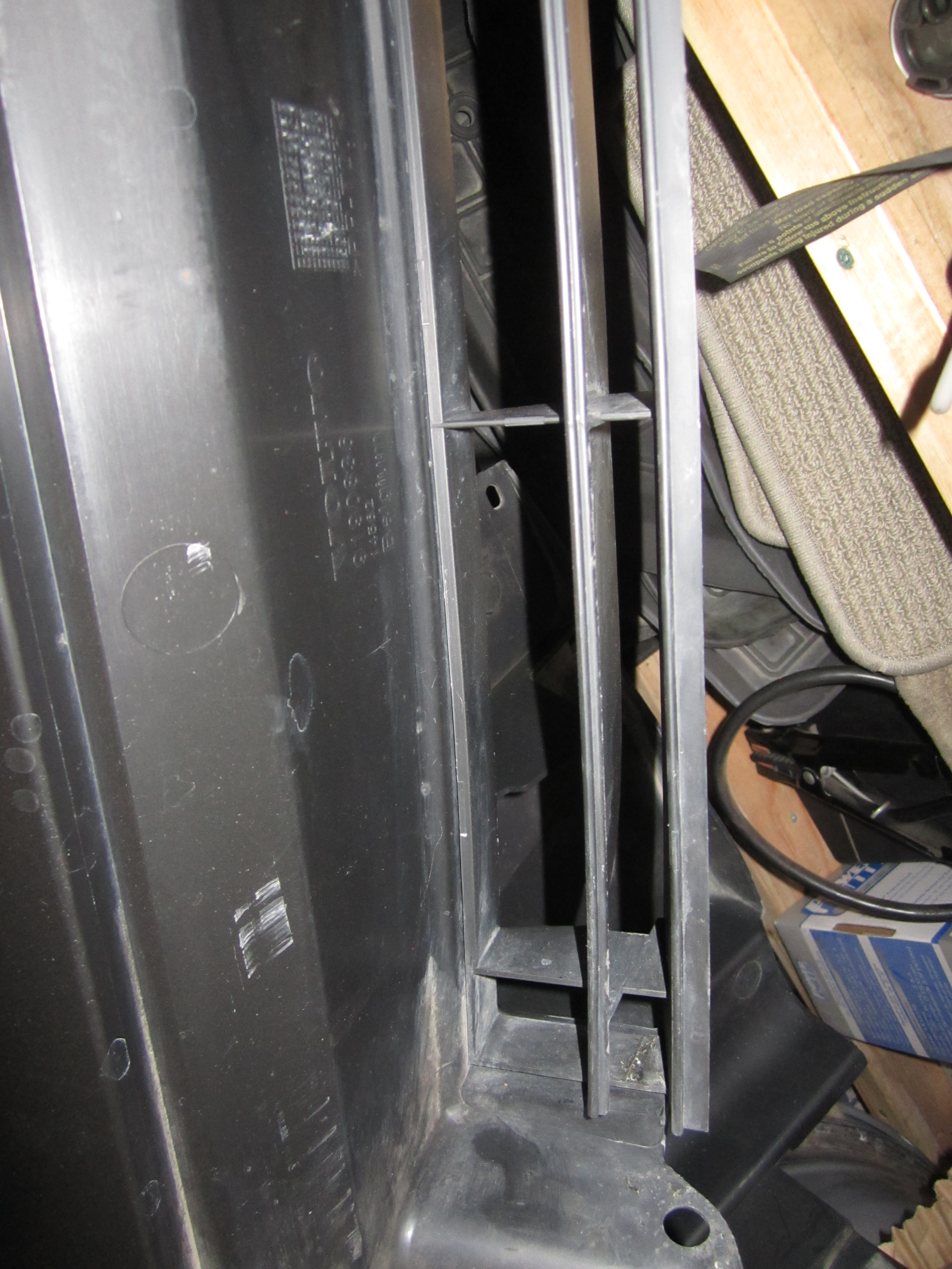

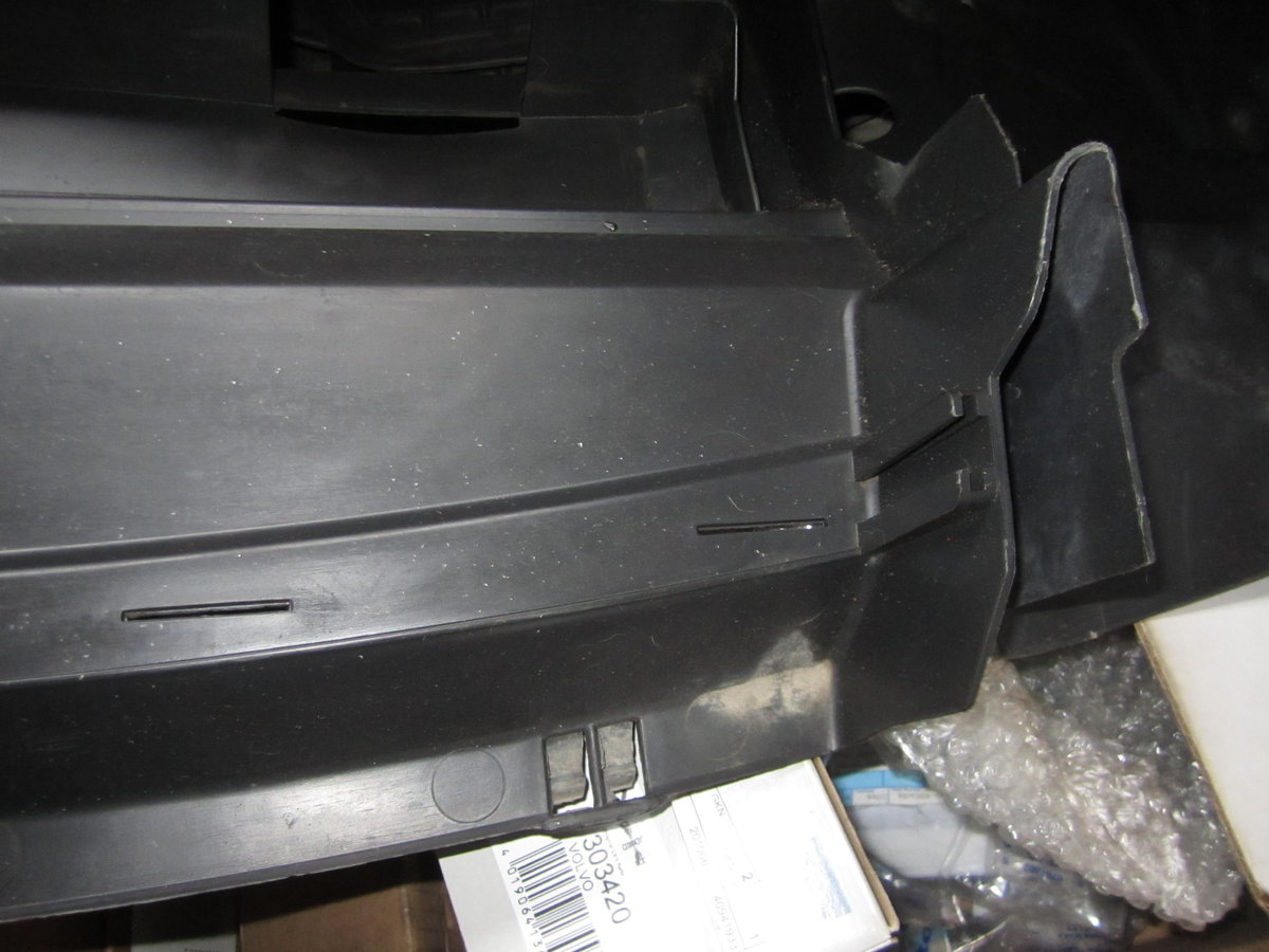

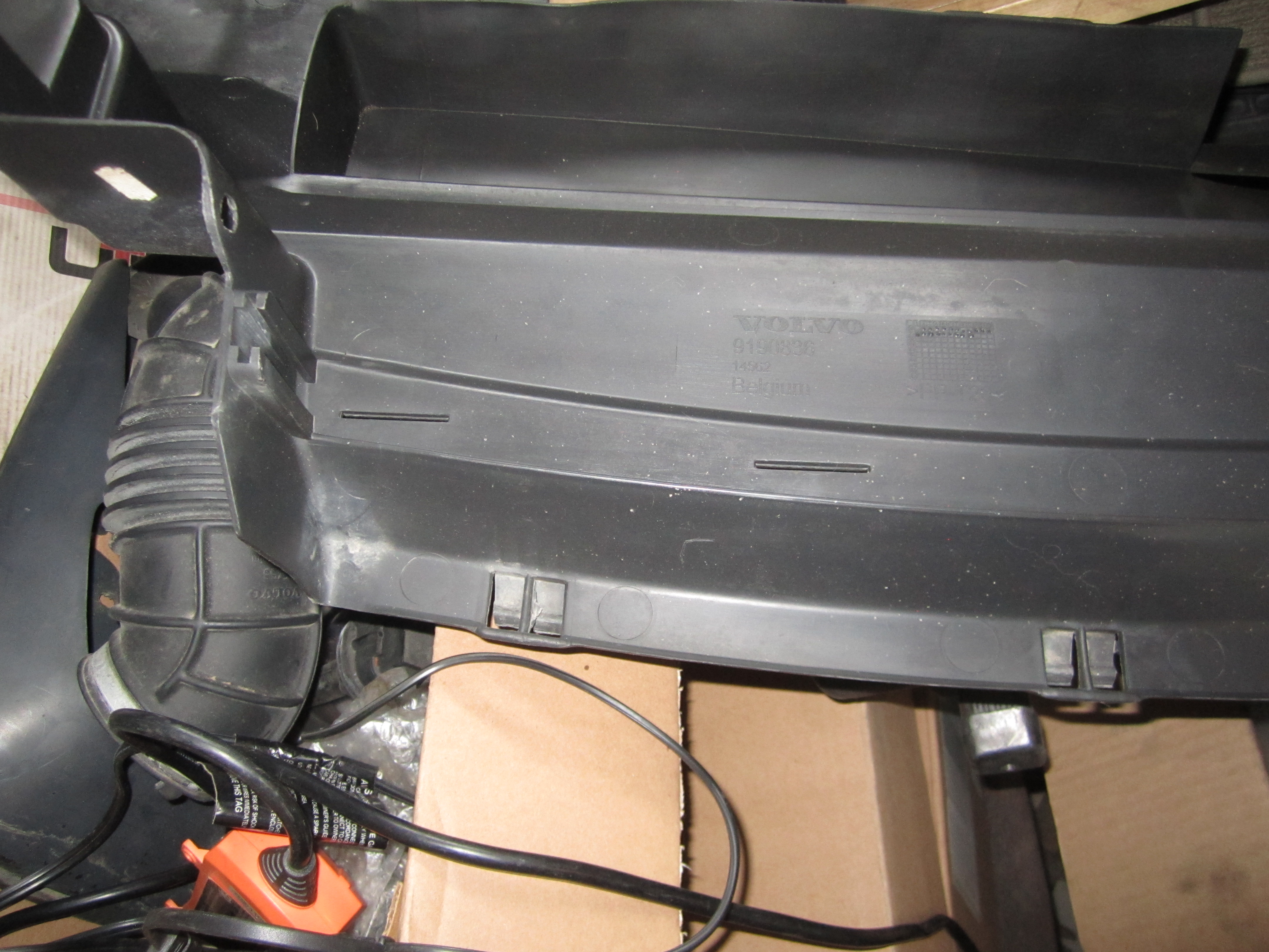

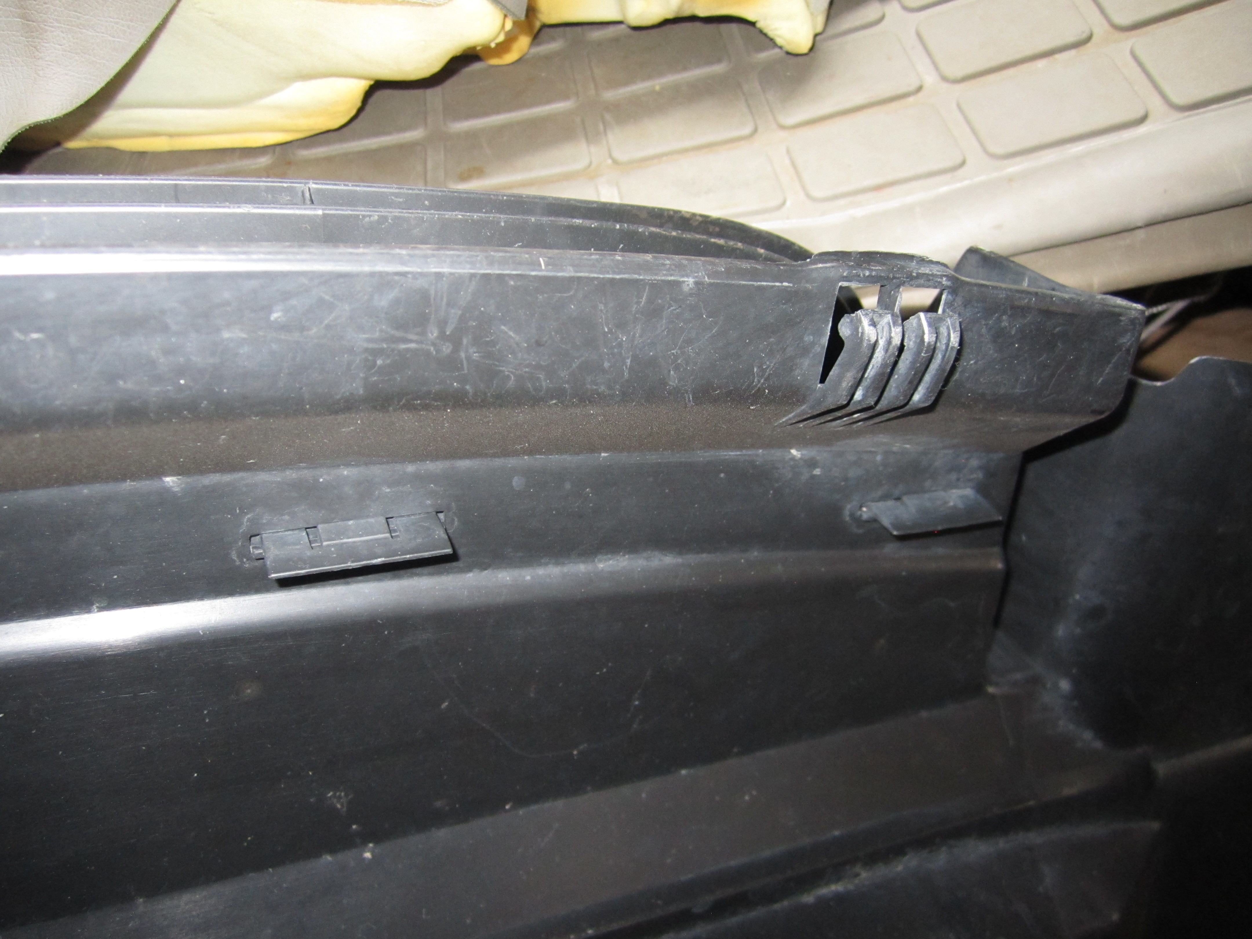

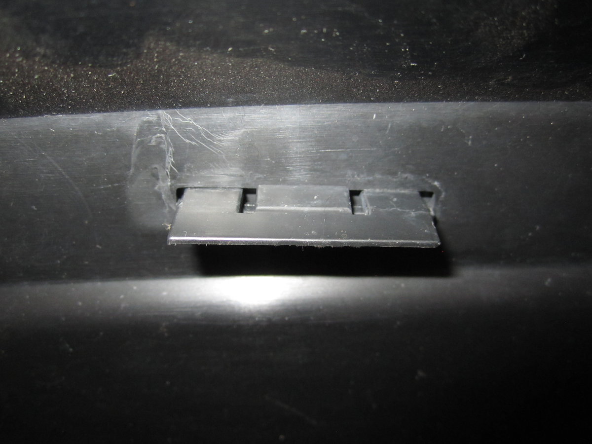

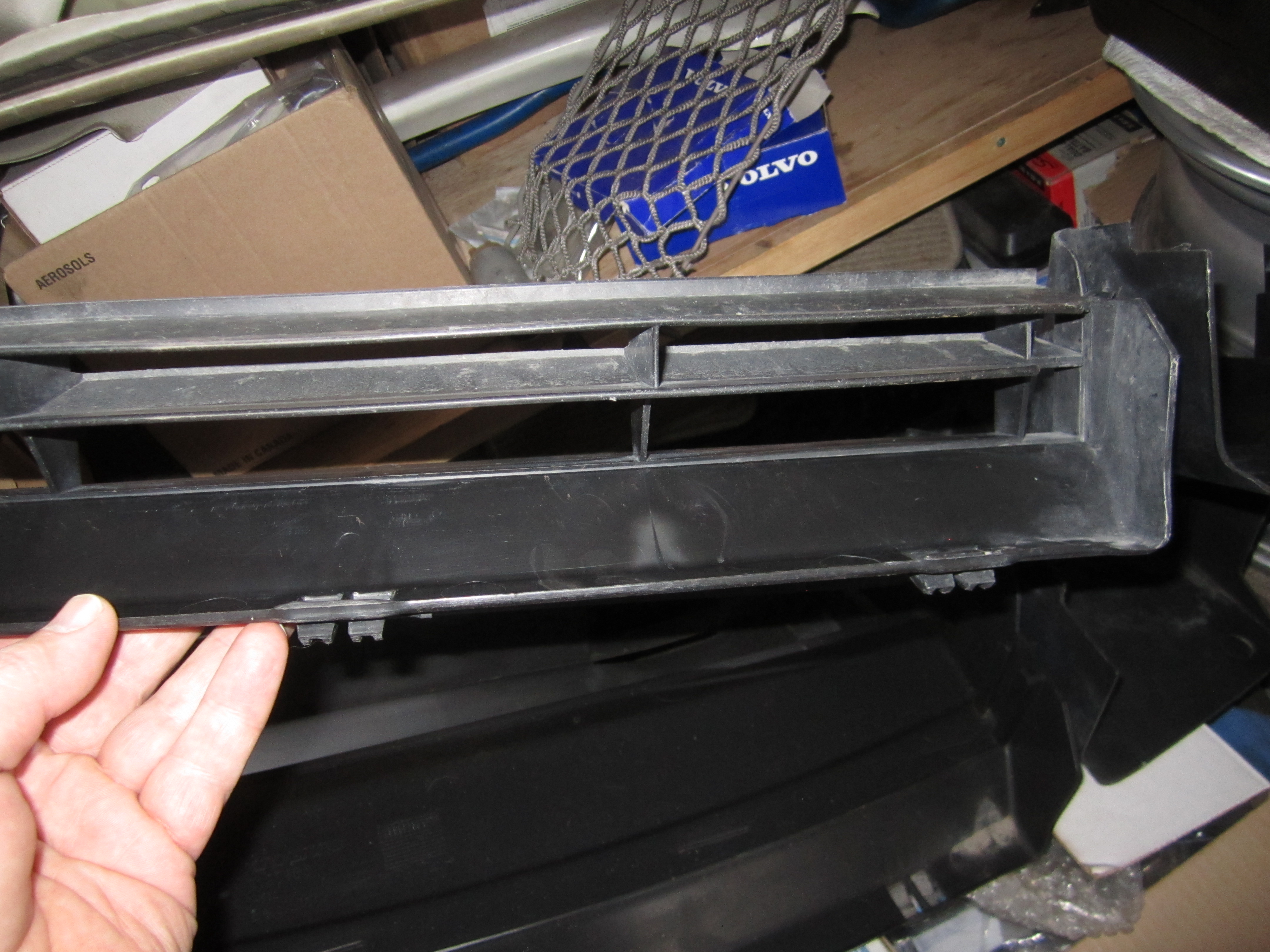

Here are some pictures as promised. There are 2 sliders (one each side) and 4 tabs. I would have thought that if any of the tabs or sliders are broken short self threading screws or glue would locate the unit in place either so you can remove it if needed or permanent and no damage from screws if glued in place.
If you need pictures of anything else on this let me know as this will be off the car for at least another week until I repair the front bumper!!

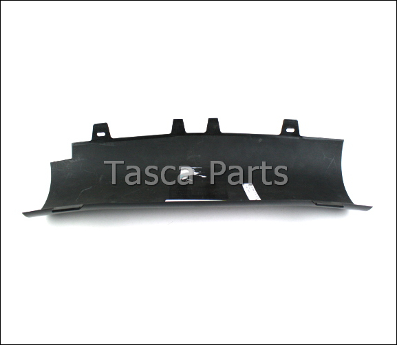

I bought one of these off eBay seven months back when I thought I needed it in order to install the air dam... I know, I know.
Does anyone know what this is used for? I don't have this on our 98 S70 N/A. It looks like it's supposed to scoop air and direct it somewhere. I have no idea how to install it.
AIR GUIDE - 1998 VOLVO S70 (9169384)
http://www.tascaparts.com/volvo/s70/916 ... =air-guide

Have you see this diagram (it is #31)? From http://volvopartslisle.com/part/OEM-Vol ... /Air-Guide

I have, and am none the wiser for it or where the part fits and it's purpose. Same as with parts #28 and #29. I'd have to assume they are some additional engine under trays or covers used perhaps in some markets. Interestingly this shows for Non-turbo 70 series. I remember in Europe many of my older Volvos (940/240/140) had under engine covers to keep all the crap out. In that climate, it was fine, but I'd think somewhere much hotter it may cause engines to over heat, although #31 does look like another additional air guide but not sure where it would fit?

I don't know where it would fit either. Maybe under the radiator somehow?
When I was looking at the diagram on Tasca, i thought the air guide attached to it. Hence why I purchased it... Luckily it was only like $15 shipped...
You're right, it's probably not a good thing to have installed when stuck in rush hour traffic during a 100 degree day around here...
