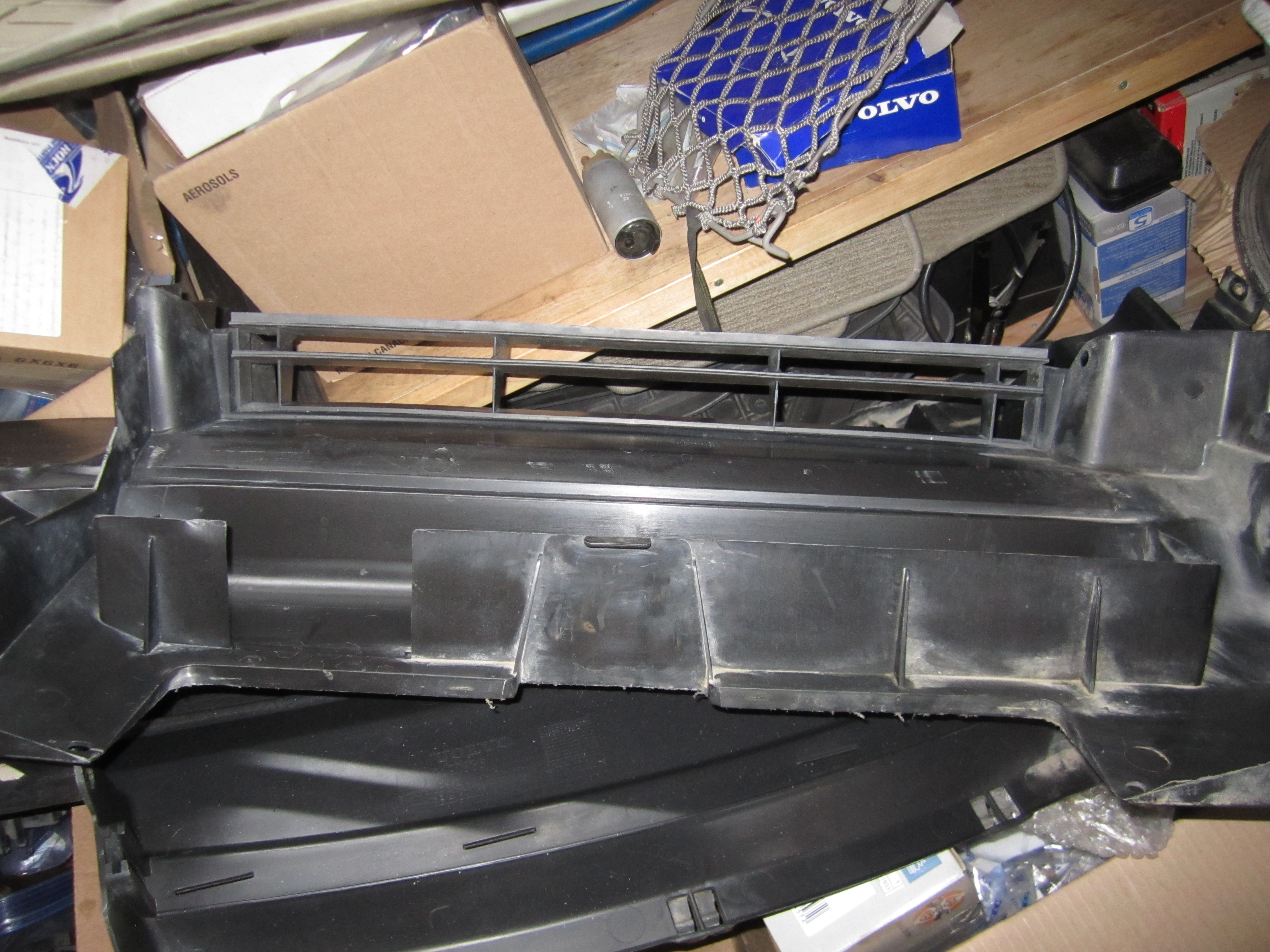

What do you need to know? The air-dam is off my car just now and I have another without the baffles, so I can take pictures for you tomorrow if that helps?

Thanks. It just seems like some of the little tabs on both the front and back of mine are broken off - not sure if this thing needs every tab to be a viable part or not. I'm sure I could rig something up with zip ties. It looks like in conjunction with the snap in tabs, this thing is only held in with two screws.scot850 wrote: 25 May 2017, 23:02 What do you need to know? The air-dam is off my car just now and I have another without the baffles, so I can take pictures for you tomorrow if that helps?

Yes only two screws and snap tabs, and yes I have zip tied one that had broken tabs, that should work fine.

Here are some pictures as promised. There are 2 sliders (one each side) and 4 tabs. I would have thought that if any of the tabs or sliders are broken short self threading screws or glue would locate the unit in place either so you can remove it if needed or permanent and no damage from screws if glued in place.
If you need pictures of anything else on this let me know as this will be off the car for at least another week until I repair the front bumper!!
