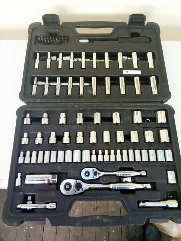

I did this on wife"s 2.4T (XC70 2002). and I recall using really long 1/4 inch extensions snaked under the intake. I used an 85 piece Stanley socket set that I have added a few "trick" pieces to from my old Stanley set.
I recall doing this at dusk/night and using a LED work light to avoid glare which is the worst enemy for fiddly jobs in confined spaces.
Since combining the two sets and adding some torx bits I haven't been caught out for any job fiddly or otherwise. I still have the original screwdriver bits that the photo doesn't show. Hidden under the long sockets are 1/4 inch extensions and universal joints.

I'll have a look in the morning. I remember thinking the angles are off, but maybe. I'll let you know!precopster wrote: 06 Oct 2017, 15:32 I did this on wife"s 2.4T (XC70 2002). and I recall using really long 1/4 inch extensions snaked under the intake. I used an 85 piece Stanley socket set that I have added a few "trick" pieces to from my old Stanley set.

You'll be able to do it with universal joints and the right number of extensions. Try extension bar reducing from 3/8" to 1/4" to get the correct length. Good luck.

I agree with Abscate on using a 1/4 inch drive more on these P2s than any other ratchet however in this case you need to make up around 18 inches of extension bar and few toolkits can do this. You could go from 1/4" back to 3/8" at the beginning with the use of a converter then use a 3/8" to 1/4" converter to complete the length.
