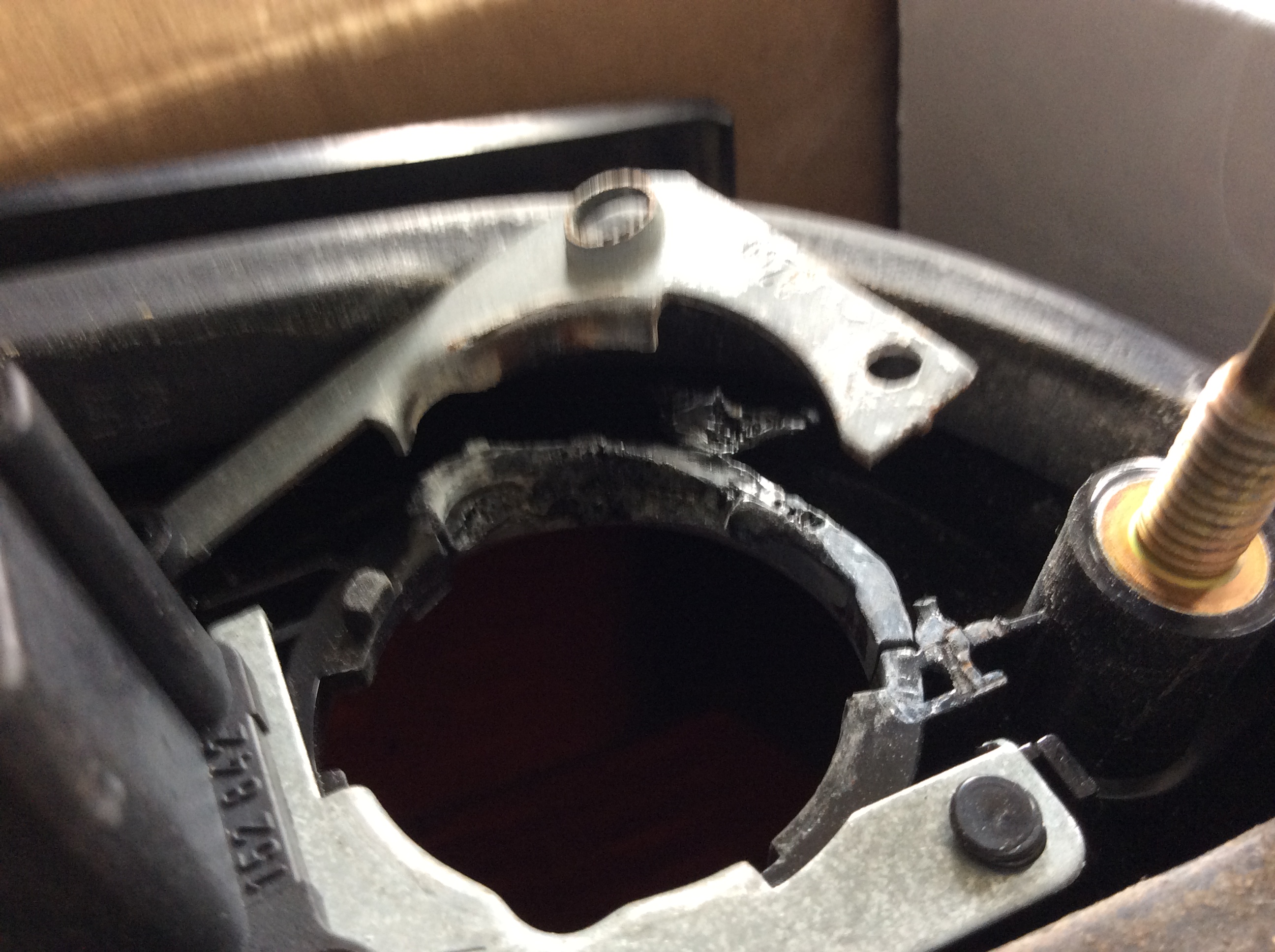

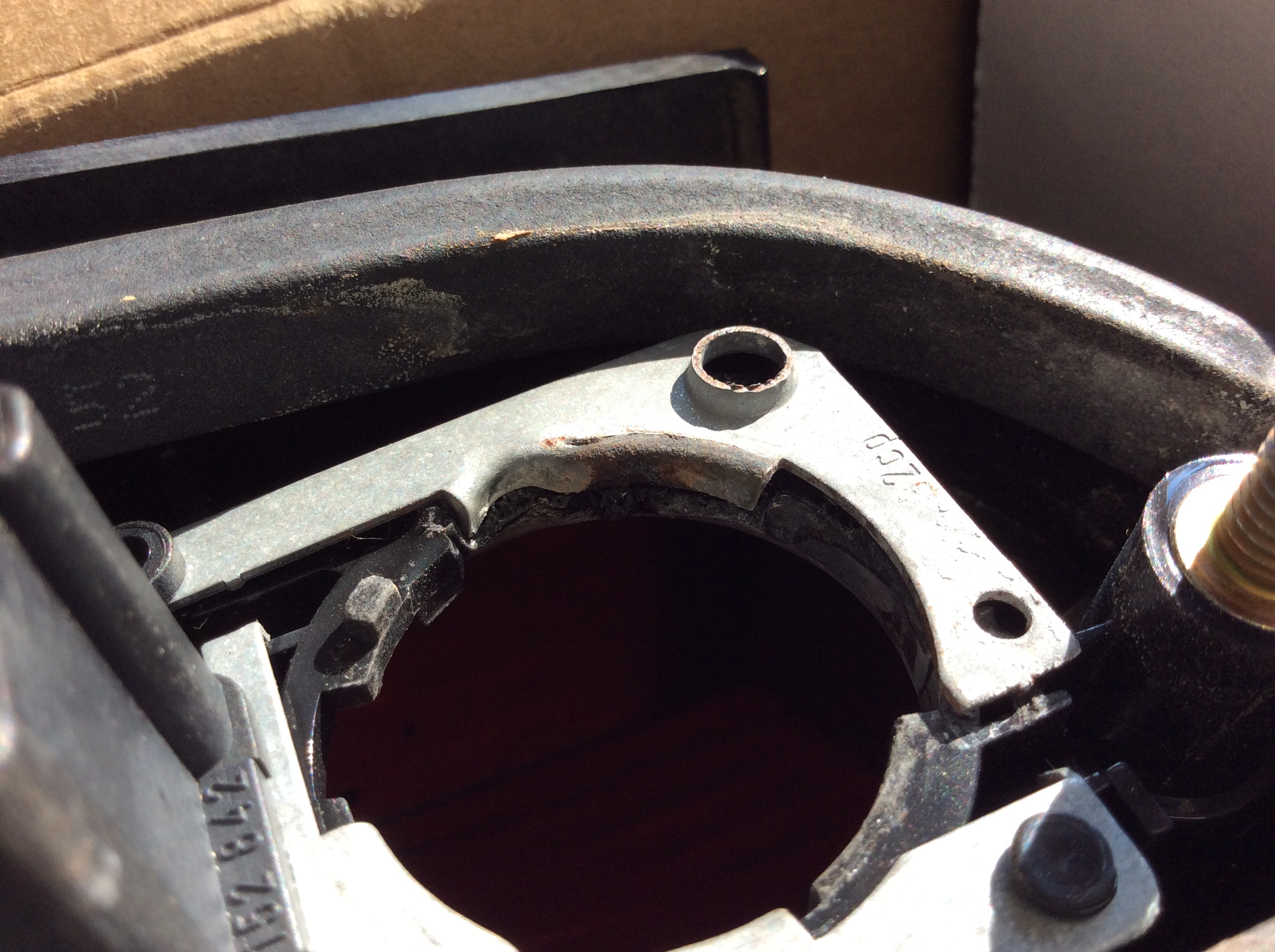

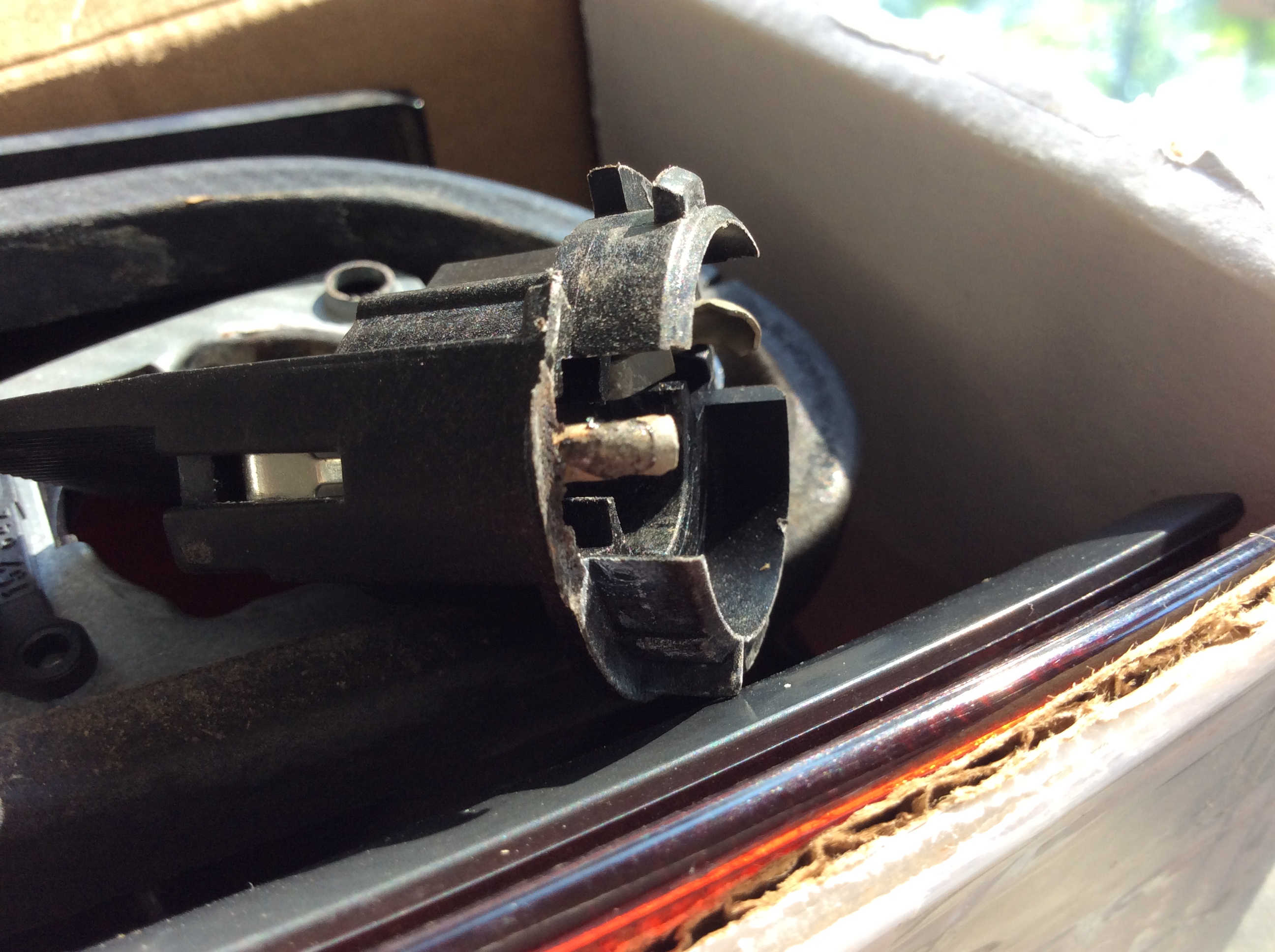

I just experienced a persistent brake light warning and learned that the right side bulb holder had melted a bit and had scorched metal contacts. I cleaned the metal and trimmed any plastic drips. Jiggling the bulb holder with the brake pedal depressed gave me a constant circuit. Then it would shake loose-or whatever-again.
