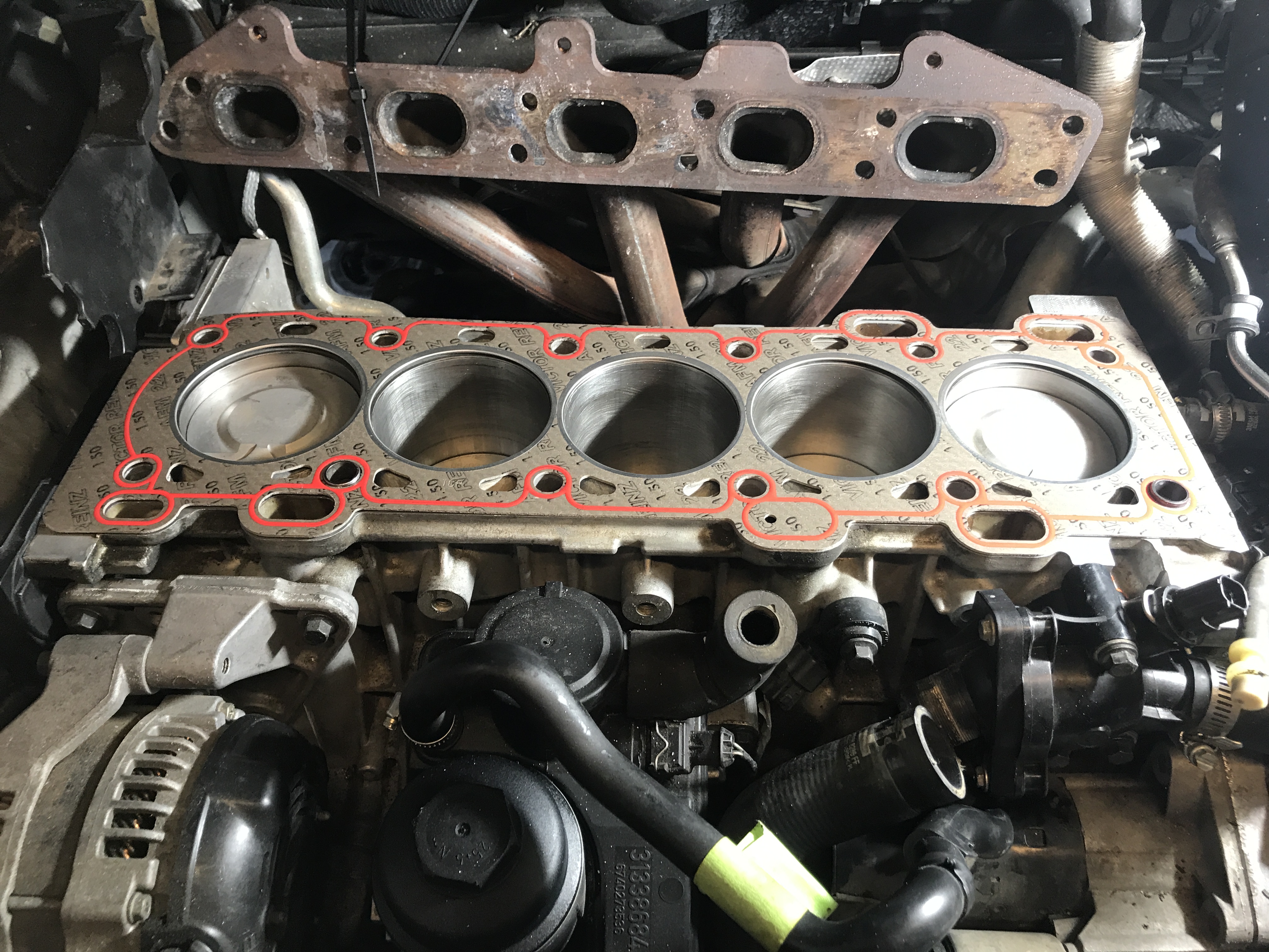

Btw, I hope you got enough of the anaerobic sealant on the surface. I know that Volvo calls for only a thin layer (nothing to glob up things) but the picture you posted seems like there were bare places.

Yeah I put plenty of sealant on there, more than enough probably. Don't have a paint roller so I just applied it with my fingers.
