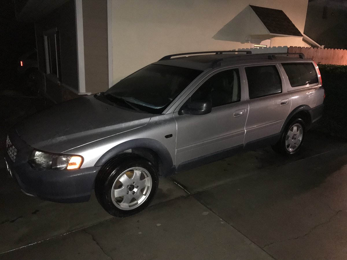

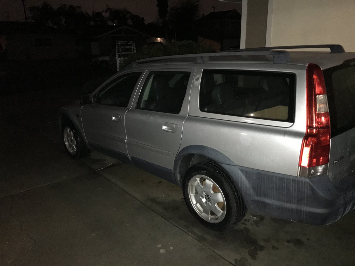

Just bought a new wagon! 106K and no compression on any cylinder :lol:

Those tyres look way too small as well.

Rattnalle wrote: 05 Feb 2019, 08:39 Those tyres look way too small as well.
It’s an XC AWD, think tire size is right.

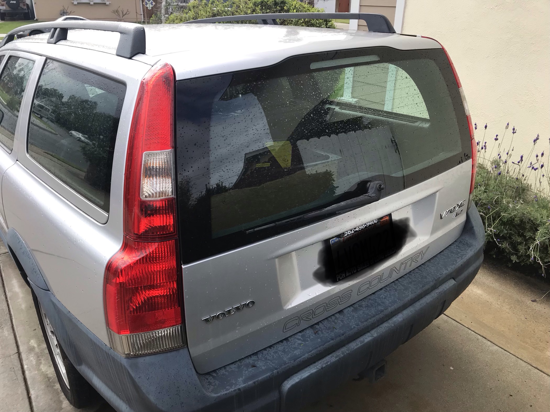

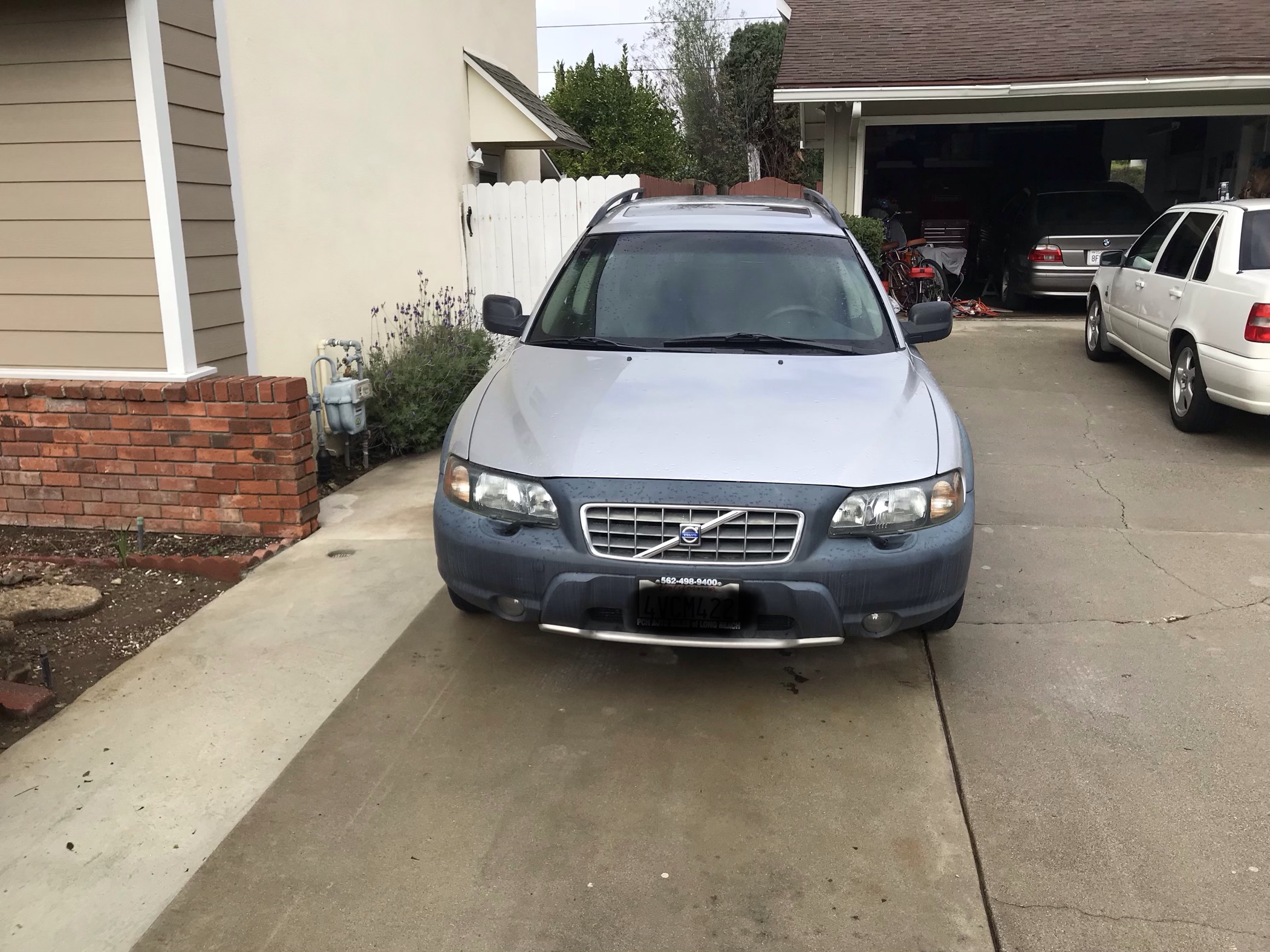

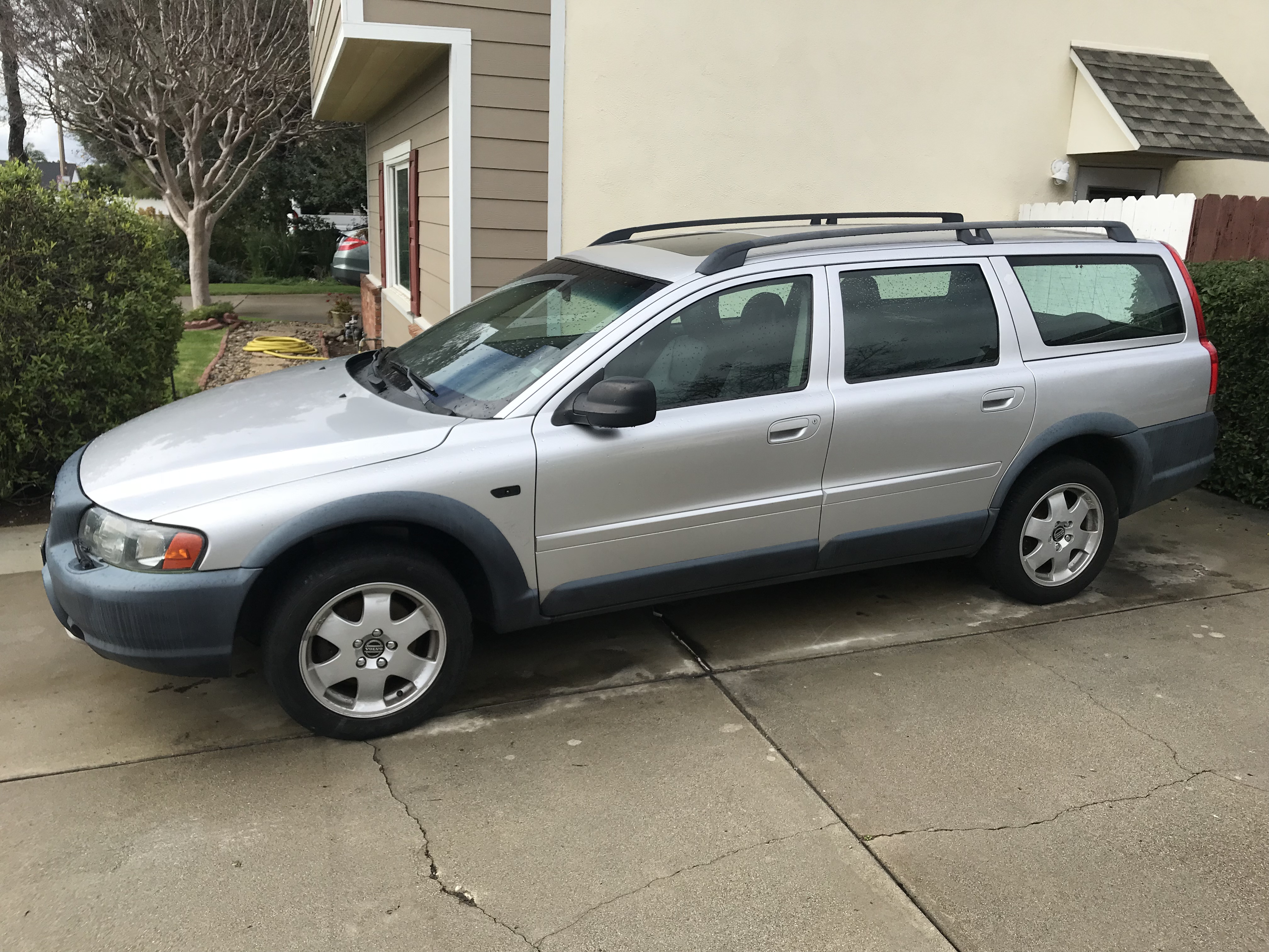

Daylight pics:
Oh, and yes it’s raining in California too :D

Rattnalle
Posts: 1674
Joined: 01 Sep 2017, 02:10
Year and Model: 2004 V70 2.5T
Location: Sweden
Has thanked: 20 times
Been thanked: 133 times
Post by Rattnalle »
kallekula wrote: 05 Feb 2019, 08:53
They look quite skinny for 215/65-16s which iirc is the correct size.
Looks really nice otherwise. Nice climate for the cars I guess. Some work on the black plastic and it'll look like new.
After you've found the whole compression issue ofc ;-)
