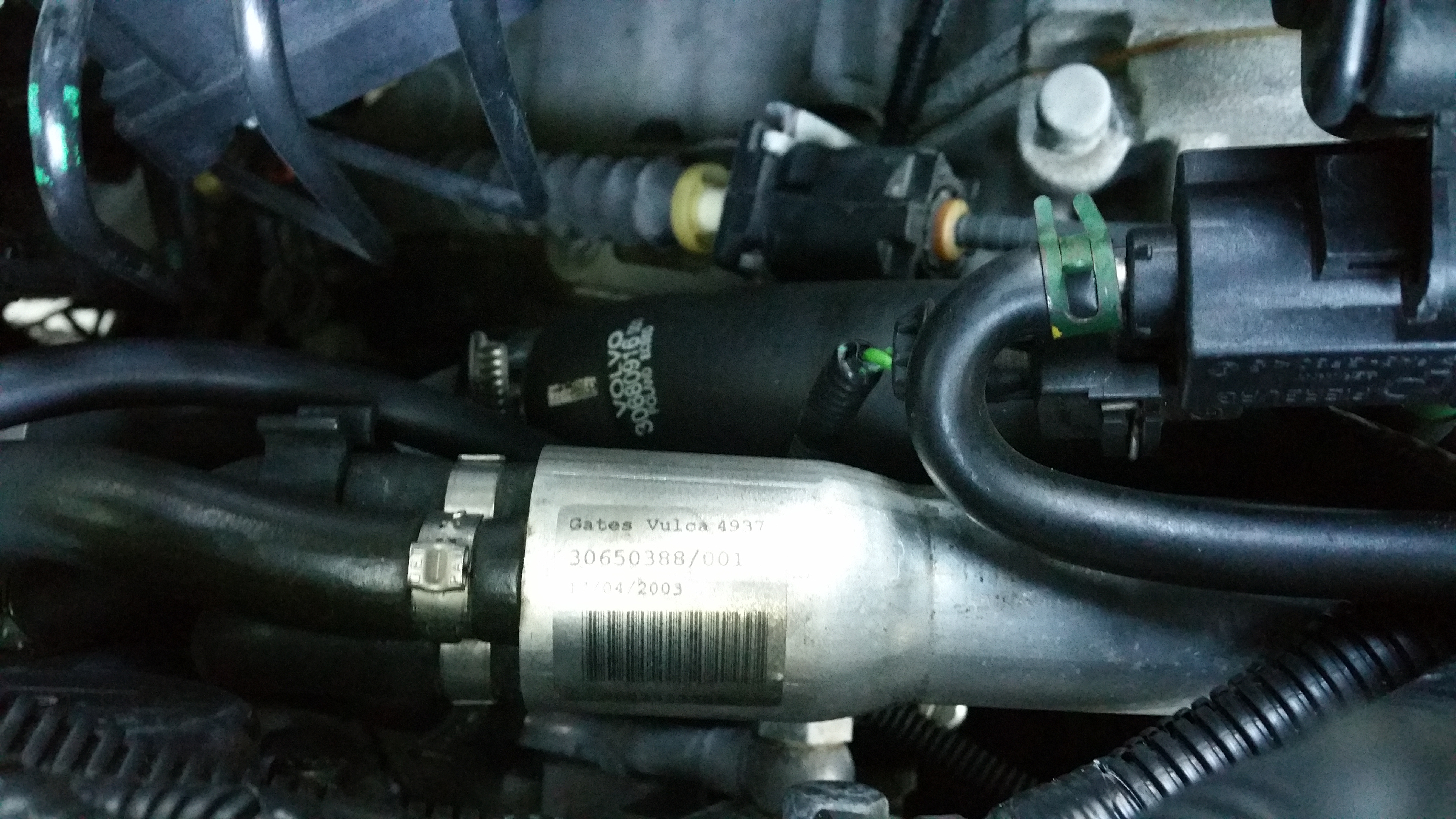

Marked "Volvo oe"? I have yet to see a Volvo part installed by my dealer marked oe. Here are photos of my upper and lower hose installed by my dealer and are genuine Volvo parts. Should be marked Volvo followed by a part number and on mine Poland. JuneHellrot47 wrote: 25 Oct 2017, 11:51 I got it at ipd so I should think it's not counterfeit and should be oe and it's marked Volvo oe.

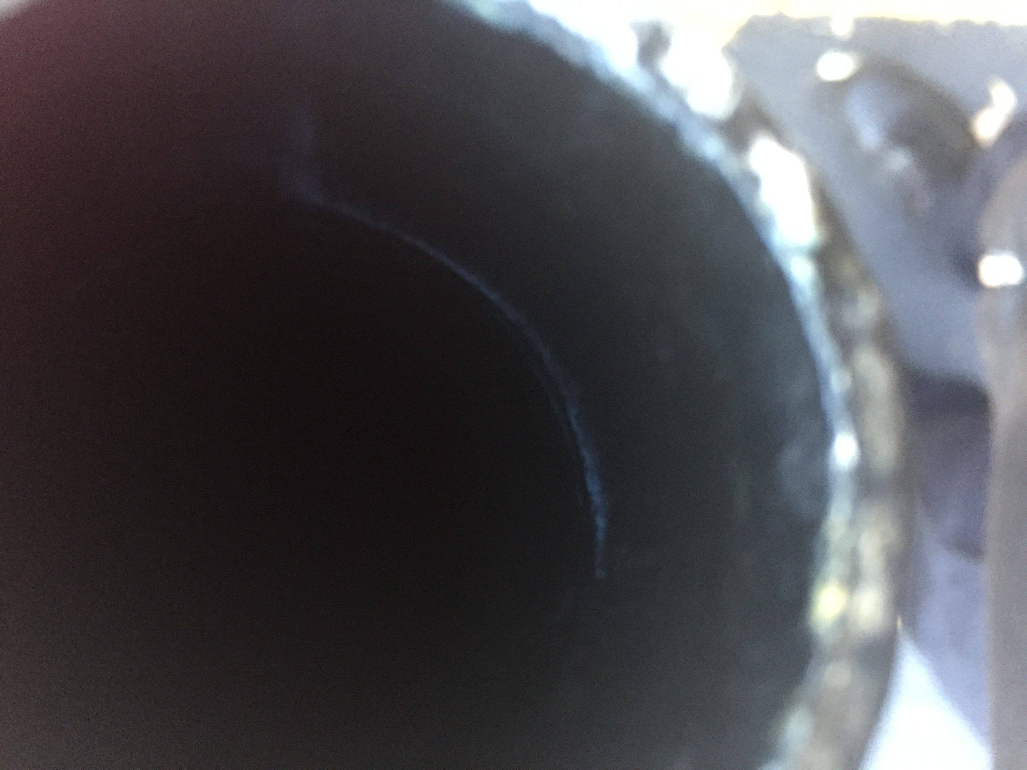

re:june yes as far as i know looking at first two pics.
Ok I just went by O'Reilly's got a new gates hose to replace the old oem hose and I'll include some pics of the hoses, when i took off the old hose it was leaking form both ends and had discolored reinforcement webbing if you look at the last few pics there's coolant residue on the radiator inlet and on hose. But I would say that the gates looks good enough for now and it fits much tighter than the oe hose did and feels like it has more reinforcement as well, so i think it was good to replace now before it split in half and i think will stick to fcp euro next time thanks.

Those look like mine so I doubt they are counterfeit. This is disturbing! My factory hoses went 13 years and nearly 140K and it was the heater hose that blew. The upper and lower hoses were replaced with the radiator for good measure due to age. I sure hope I get more than 2 years service from the hoses... JuneHellrot47 wrote: 25 Oct 2017, 19:16 re:june yes as far as i know looking at first two pics.
