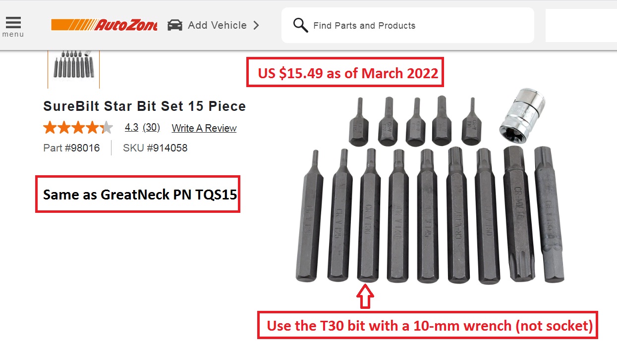

2. The key to that thermostat lower bolt that attaches to the engine block:
- Buy the Autozone Torx set (GreatNeck TQS15 or Surebilt set, same thing).
The T30 key has the correct length, but here is the trick" use the T30 bit with a 10-mm wrench, not with the socket supplied with the set.
Don't forget to spray the bolts with some PB Blaster one week beforehand.
I wrote a DIY a few yrs ago:
DIY: 2004 V70 2.5T PCV Job, a Brief Job (110K miles)
https://www.matthewsvolvosite.com/forum ... hp?t=91596
Anyway, this is the Torx set that will make the thermostat job much easier. In fact, when you use this Torx set,
there is no need to remove the PS Pump at all.
