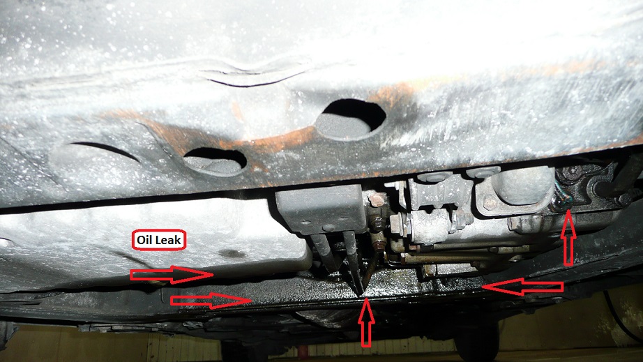

- This little update is from my 1998 S70 GLT with 187K miles. Volvo dealer installed OEM seals back at 110K miles or so. Last winter, I noticed I had leak behind engine dripping down. Initially thought to be the rectangular plate behind the engine as rspi said. Then no leak during the summer (very strange symptoms). Then the other day it was -20C, massive oil leak again!

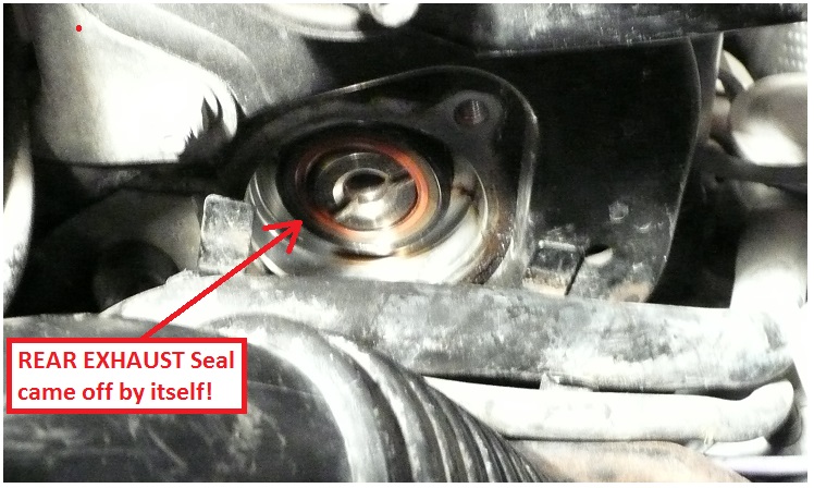

- But the oil loss was massive, big puddle on driveway, 1 qt every 2 days. Then it occurred to me that only the Rear Exhaust Cam seal can cause this. Sure enough, once I opened the Rear Exhaust Cam seal, it already came off by itself, only held in place by the Reluctor ring! So my theory is: the Reluctor ring barely held it in place against the housing, but when it is -20C, the seal shrinks in size, allowing oil to leak. Once the weather warms up, the seal barely sits against the housing.
- Anyway, the Volvo OEM Seal "looks like" the SKF seal. Although the last time I installed the SKF Seal back in 2012, it took some force (using the 36-mm socket) to drive it in (remember to drive it only 1-2 mm from the edge!). So my theory is: SKF is a better fit than Volvo OEM. Remember the ONLY thing that holds any seal in place is the OUTER ring of the seal, where it meets the housing.
- Anyway, I use a tiny bit of Black RTV on the OUTER Edge for "extra safety", this way the seal bonds to the housing better. I oiled the inner seal lip. It took some force to drive it in. Corteco looks like a good seal, plus it is used elsewhere in the car (FRONT Cam Seals, Trans Seals). Time will tell how long this Corteco seal lasts. BTW, my car has 187K miles and has a burned valve #3, so I am not keeping this car much longer. The only reason I fixed this is that:

- All done now, car is bone-dry. Amazing how much a REAR Exhaust Seal leak can cause.
- Food for thought: if the REAR Cam Seal ever leaks, it is always the Exhaust seal and not the Intake Seal.
Perhaps the the distributor cap metal ring is further in, preventing the seal from coming out. But...the Intake Seal required some force to remove, and yet the Exhaust seal already came out by itself.
- So my 2 cents: stay away from the Volvo OEM seals, stick to SKF or Corteco, but I may be wrong. Anyone with long-term experience (preferably > 80K miles) on whatever seal, please post.
- Note where the oil ends up!
