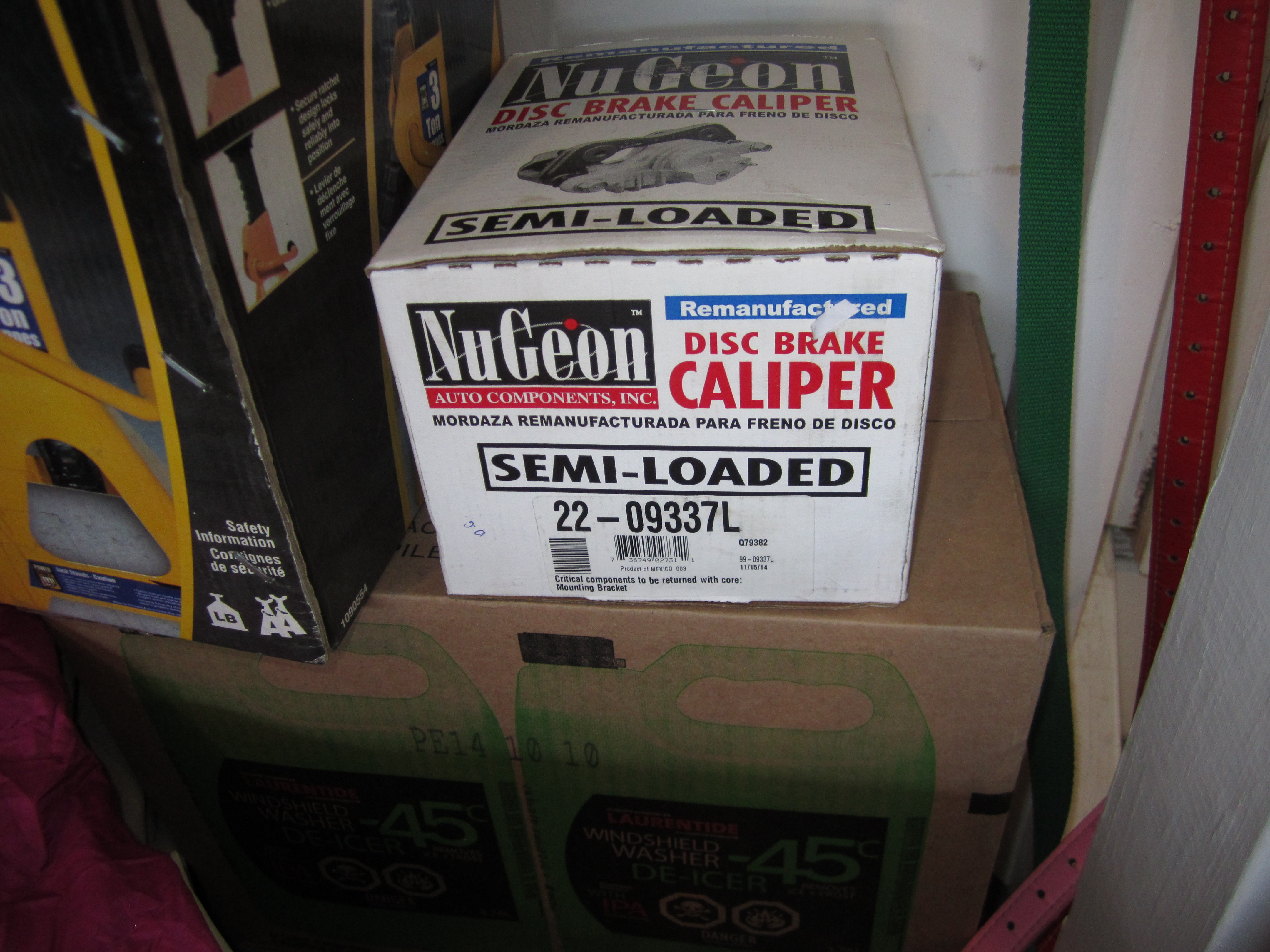

When I was looking for calipers, I found only 2, one for each side as rebuilt units. Trying to recall the brand name. I think it was something like NuGeon. But it is worth checking with the usual suspects like Napa and Cardone. I even tried to get a re-build kit from ATE but they no longer made them.

So the only way I could get a bracket that I was able to figure out on such short notice was by getting a Wearever reman caliper that comes with the bracket via Advanced.
Had to cancel my order with Tasca for the OE non-R calipers as I just could not source a bracket. They were super helpful today and I definitely owe them my next parts order.
I only ordered one as I’m not super confident in the quality, so I’m hoping this can at least get me to summer and I’ll try to get OE parts back there, even if they aren’t R parts.
