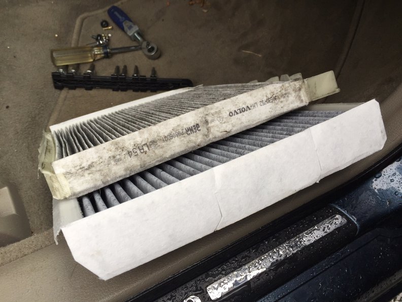

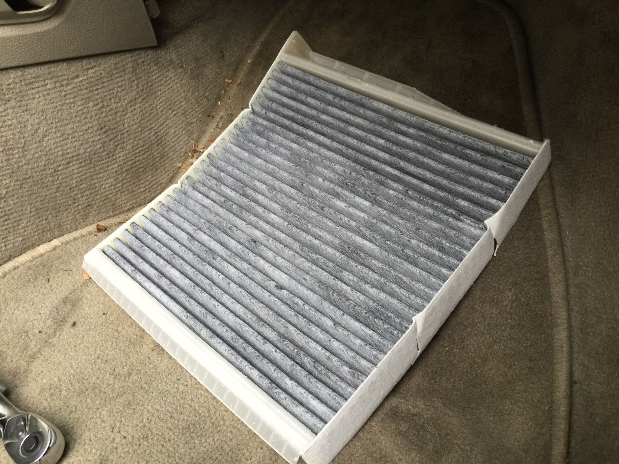

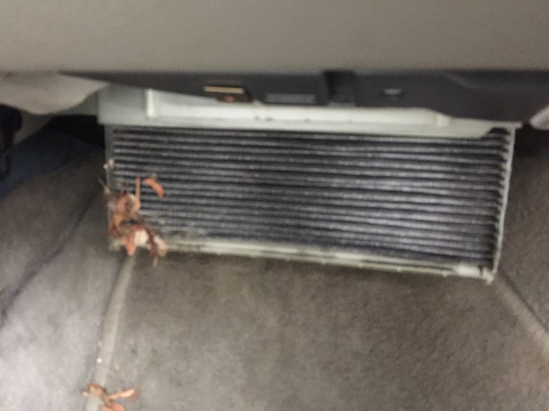

Replaced the cabin filter on the P2 today

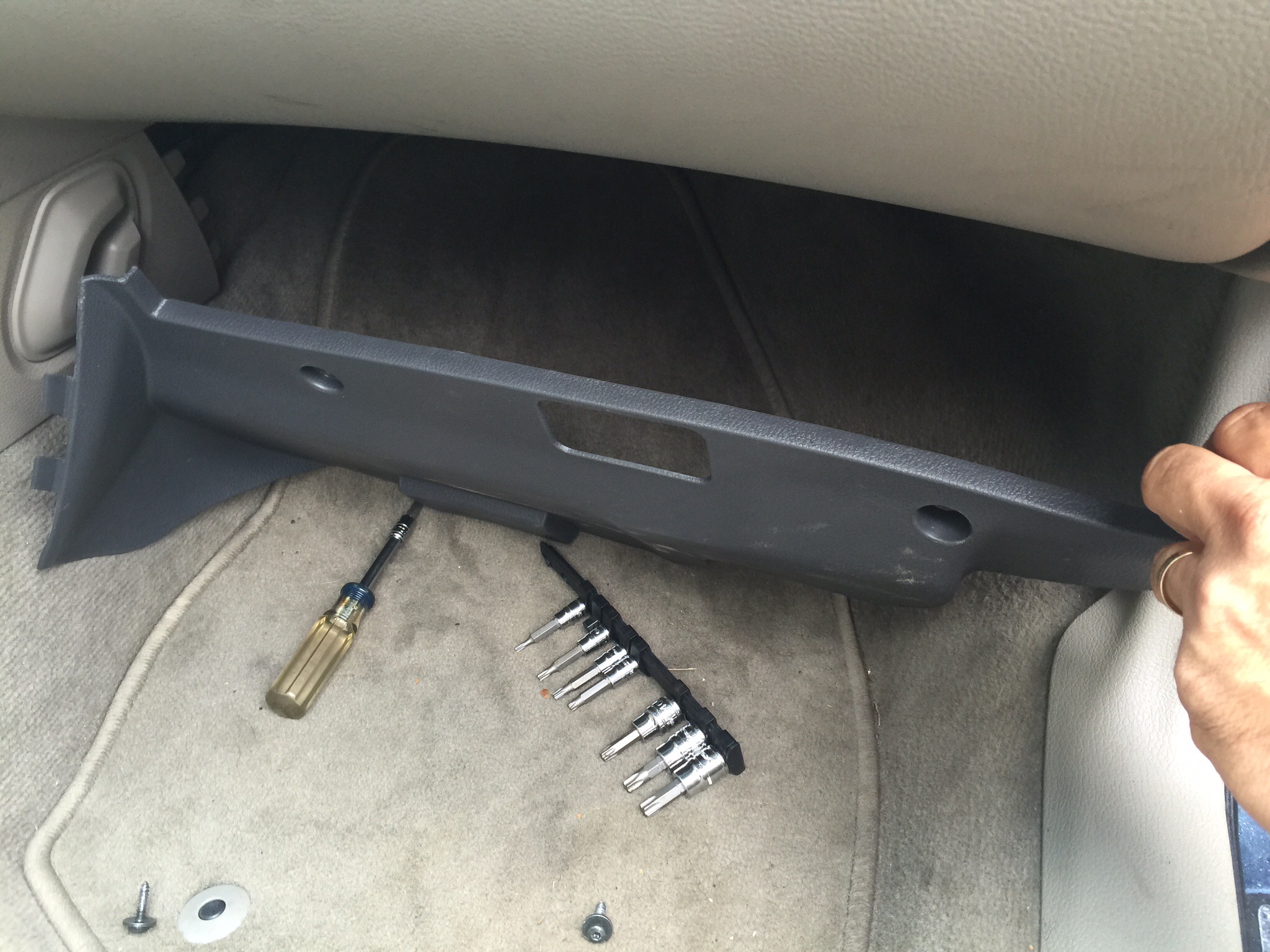

Two Torx 20 screws to undo the kick panel, then u clips in three places

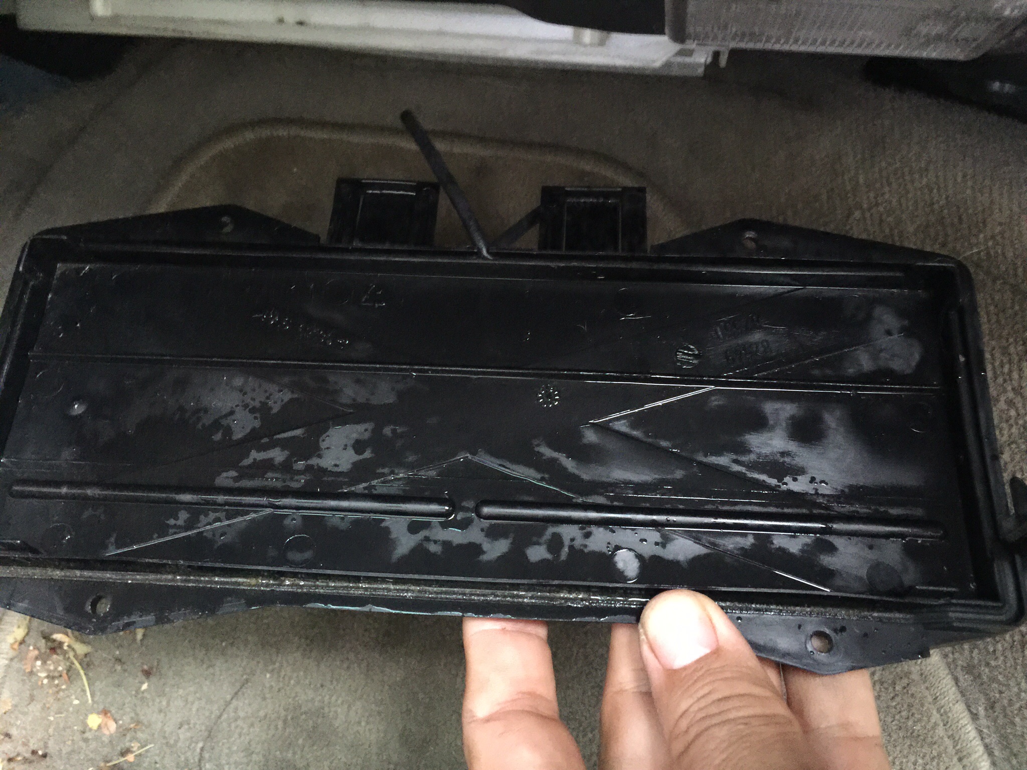

4 Torx 20'screws to drop the filter cover.
I snapped out the plastic block and went with the thick filter over the thin.

You should not have done that.
It doesn't have IAQS so all that thicker filter will do is cut down on your nice cold, A/C airflow.
If it's a particularly hot and humid summer, I change to the thinner one even if that car I'm driving has IAQS.
The airflow difference is quite noticeable plus you can run a lower (less noise) fan speed and have the same cooling effect!

I'll see how it does and change if I don't like it.
It's pretty temperate up here in upstate, and this AC is so powerful that I doubt it will be a problem

Surprising as it is, the thin filter is more efficient than the thicker one because air filters are rated by their
MERV rating.. (Minimum Efficiency Reporting Value) The thin filter has at least 5 times the number of pleats compared to the thicker one, and if you opened up the filters and stretched out the material, the thin one would be at least double the length. Basically it comes down to how many square inches of filter medium there is for it's CFM (Cubic Feet per Minute) of air. The thick filter looks like it's MERV 8 and and the thin one
a MERV 10 and both of them are perfectly fine except that the thicker one will be clogged up quicker.
