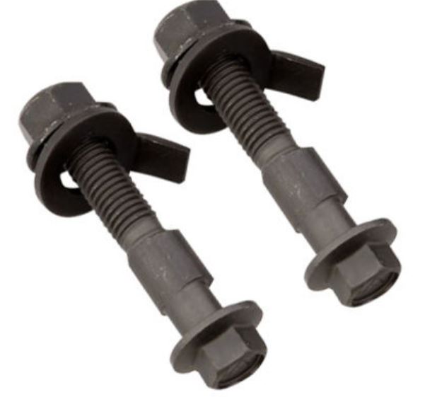

misha wrote: 14 Apr 2018, 10:32 Yes really...change the allignment shop.
I wouldn't go back to them again.
Just because the front camber isn't factory adjustable doesn't mean a good alignment shop can't make it adjustable.
This can be easily accomplished by replacing the bottom strut to knuckle bolt with one of these:
MSRP on a set of two of those is $25. Which means cost would be something less than $10. If you only need to adjust one side (use one bolt) cost would be less than $5. I'm thinkin somewhere around $2-3...tops. At that relatively low cost some shops may well just throw it on as part of the basic fee...Because people do not like being told that there's a problem that either can't be fixed or costs extra.
What they like to hear is 'everything lined up, pay at the counter and you're good to go'.
Furthermore-- on these aluminum knuckles, if the amount of camber you need to adjust is around 1 degree or less you can simply widen the hole between 1/32-1/16 either in the knuckle or the strut without compromising the integrity.
The rear suspension is different, because the knuckle doesn't attach to the strut it's not easily modified in this manner, you have to special order/press in eccentric bushings. Which may or may not be available depending on the make/model.
Generally only the top bolt is used, but if camber needs more adjustment a top and bottom approach will yield even more adjustment.
When I had my XC90 aligned the shop told me the same basic story when they showed me the alignment specs. I saw that I could get to where I wanted it by having them look at the 1 degree of play available. I asked if they adjusted this and they said no, I told them to go back and try and after some talk I persuaded them. They returned with the new alignment sheets showing the XC90 now in spec.
Takeaways on this post:
1) Removing struts can cause the camber alignment to be altered and that is why an alignment should be done. Measuring per or marking knuckle/strut line can minimize. Note replacing with a new strut of different dimensions may be an added issue.
2) Sometimes one has to work with the shop they have. Just tell the tech/advisor before hand about adjusting camber via the strut bolts and they should accommodate, if not then go elsewhere.

Frankly the eccentric bolts shouldn't really be necessary. If you have die grinder with a carbide rotary burr set, just elongate the holes on the strut in whichever direction you need to adjust. This accomplishes the same thing as the OE provision for camber adjustment on cars that are adjustable only the OE elongates the hole(s) in the steering knuckle instead of the holes on the strut. The position is held by compression force of the strut to knuckle bolts in either case. I would expect any good alignment shop worth a hill of beans would have a die grinder + rotary burrs (or some other way/specialized tool) just for this purpose. It would take all of about 90 seconds to accomplish with the proper tools. If it's more than a degree or two out you need to address/replace something else first-- upper strut mounts, springs, bent LCAs, the entire car, etc.

True, eccentric bolts will allow for camber adjustment so there is fodder for discussion there, but there is no use for them in a stock and reasonably well maintained setup.
