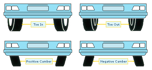

I would. Strut only shouldn't mess with the toe in/out, but it will likely mess with the camber when you reattach the hub/brake assembly. Not as big of a deal as the toe, so you can maybe get away with not doing it.

These cars have fixed camber and it's not adjustable.
On some cars it's adjustable,but on these cars it's not.

misha wrote: 14 Apr 2018, 05:01 These cars have fixed camber and it's not adjustable.
Really? Because every alignment shop I've been to says they adjusted the camber. They also say the rear-end alignment is non-adjustable.
