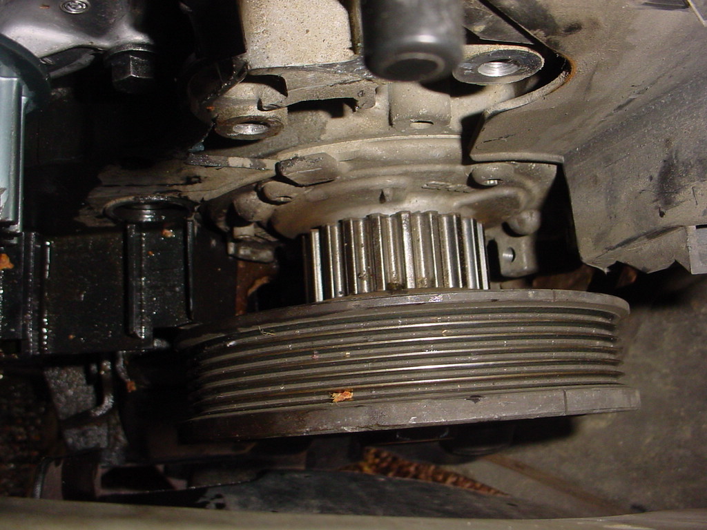

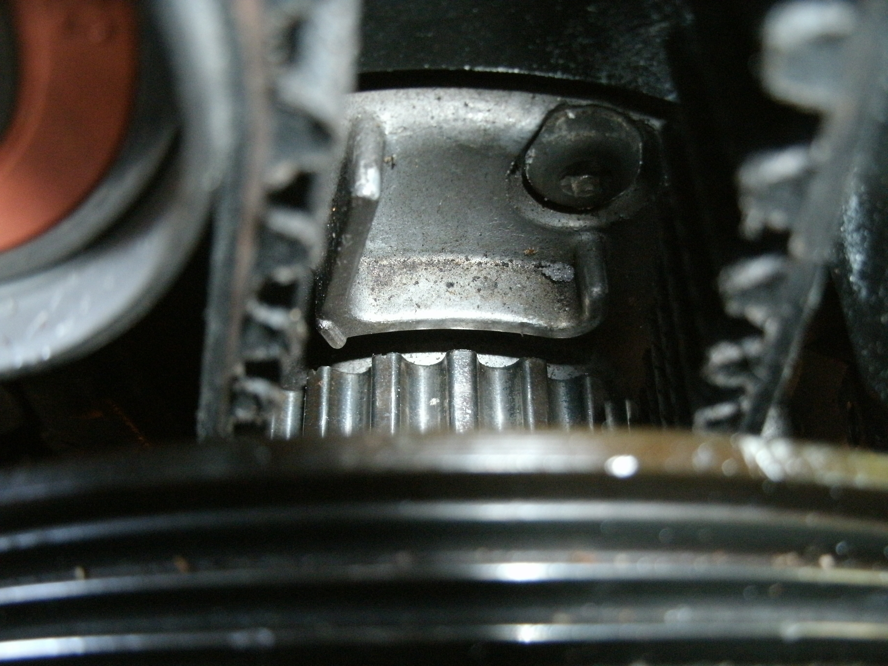

Cylinder 1 is on the water pump / timing belt end of the engine but you don't set it to TDC when timing the engine, your set the microscopic marks on the harmonic balancer either at the notch on the oil pump or, more likely in your case, there will be two notches and the notch on the oil pump is centered between them.
The Version 2 picture is from a '99 and the notch on the oil pump cover is different than the '98 and earlier versions.

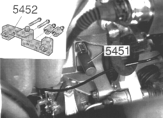

999 5451 is the crankshaft alignment tool.
Align the marks on the front of crankshaft.
Turn the crankshaft slightly clockwise.
Remove blind cover plug (near the starter) and install tool 5451.
Turn the crankshaft counter-clockwise until it stops against the drift.
999 5452 Install camshaft alignment
It bolts to the rear of the camshafts and the extensions.
Because the notches are offset, the two cams and the tool can only align one way.
Make sure you get the two cams on their correct side of the head
999 5453 is the front camshaft holder. It holds the camshafts to the cam cover. Prevents dropping the camshafts.
999 5454 is the camshaft cover press tools. It is used to evenly press the camshaft cover in place. They screw into the spark plug holes. (I use 5454 as handles for maneuvering the head, better control, saves on fingers, reduces profanity. )

Use 999 5452 to align and lock the camshafts, from there you can't miss.
The notches on 999 5452 and the rear end of the camshafts are off center, there is only one position in 360° where they line up ... the camshafts will be where they should be.
