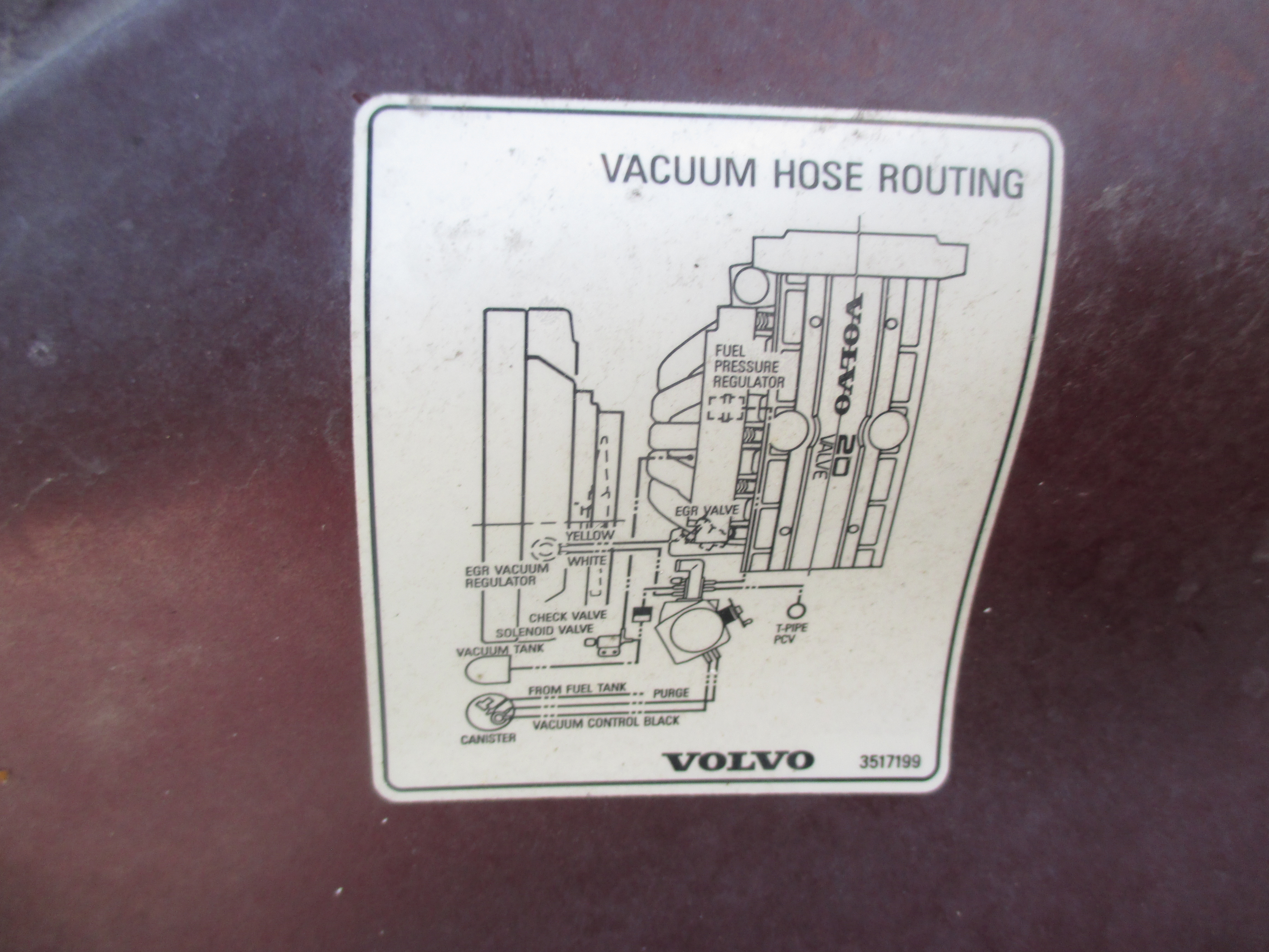

850 and S/V/C70 non-turbo vacuum lines
Re: 850 and S/V/C70 non-turbo vacuum lines

I replaced the rubber ends on the small vacuum hoses using pieces from a roll of vacuum tubing that I had sitting around. I cut the bad rubber off carefully with a razor blade and pressed on new ends. Also replaced the vacuum tree and o-ring. Runs good now.
Vacuum tubing package says 5/32 x 6ft (4mm x 1.83m)

Yep, good thinking.
