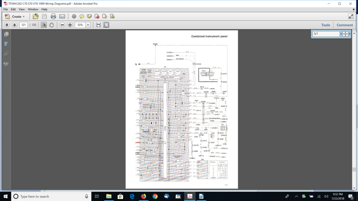

Interesting. I am going to pull the ABS unit and send to Midwest first to see if that resolves the problem. No harm in spending the $80 even if the unit is OK (it likely won't be for much longer).
If this does not fix it i'll look into CDM/DIM. The speedo is generally correct but it jumps while accelerating. Not nearly as concerning as the odometer issue - not many 20 year old Volvos with less than 100k so I'd like to keep it that way!
I'll report back - thanks for the help!
EDIT - it does not appear the CEM was implemented yet in 1999.
Pat
