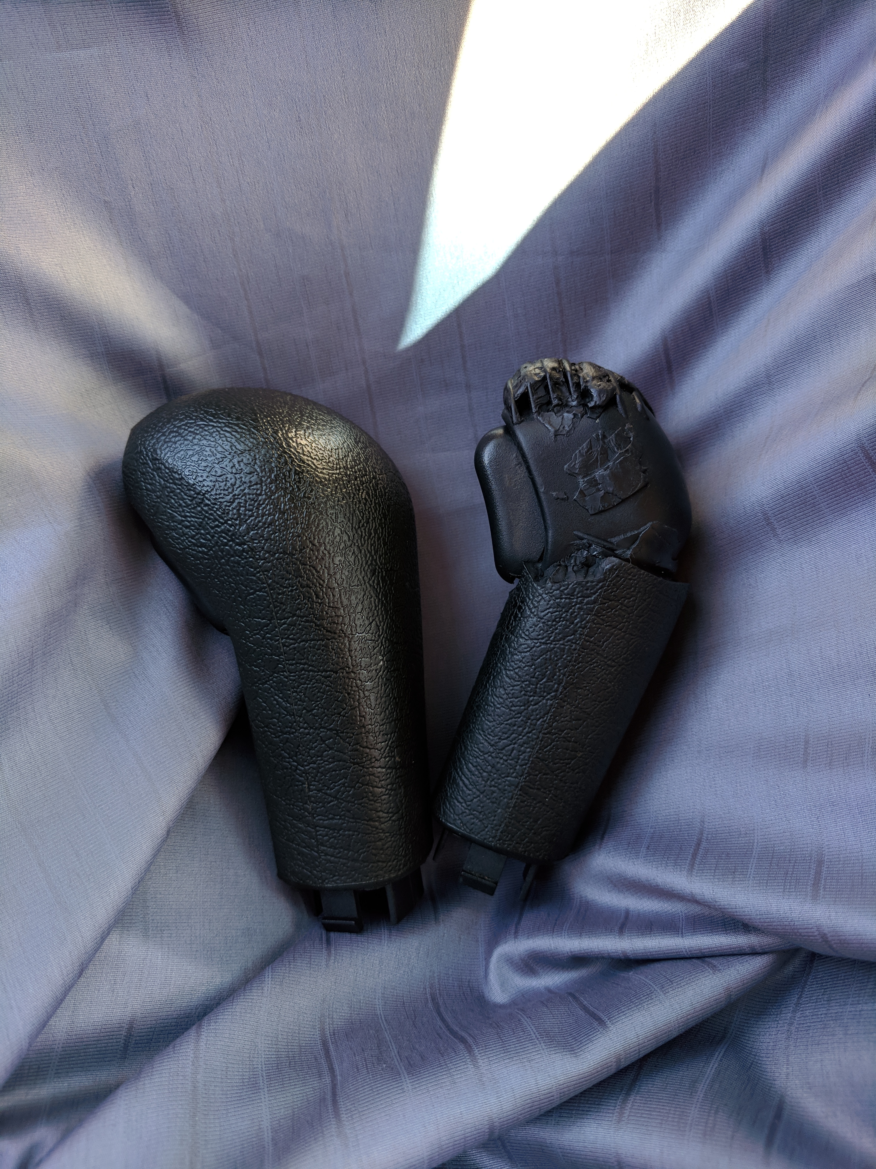

October 13th,
Was supposed to go to school, but made a quick pitstop at a local junkyard cause they got a new 850. Went in, grabbed an almost new shifter knob, and took it.
Also saw a V70 right across from it... And I saw a third row seat! I honestly want a third row seat, even if I'm only gonna use it to sit in my trunk and enjoy the weather. But the problem is, it wouldn't match the color of my trunk.
and here's mine: Also bought a lock mechanism (very pricey... coming in next month... at least it has a lifetime warranty), and a left turn signal lamp. I haven't put it on yet because I'm waiting for an amber bulb to come in. The rest of my bulbs are amber and I want it to look good... I'll post pics when everything's ready...
