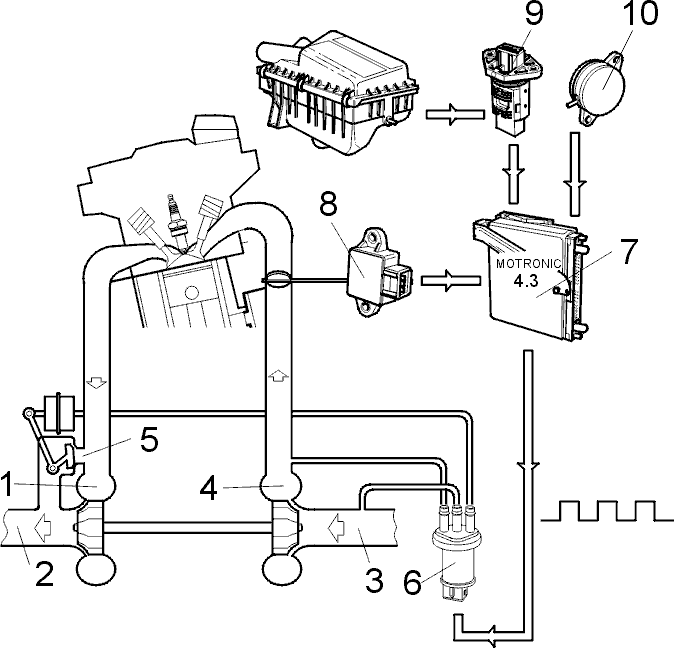

One at a time , try swamping out the Boost Pressure Sensor (8) and the MAF sensor (9).
TP sensor (8)
MAF sensor (9)
RPM sensor (10)
TP sensor (8)
MAF sensor (9)
RPM sensor (10)

Since it occurs after 10-15 minutes, it sounds like a short term fuel trim issue. So I'd probably try unplugging the MAF and see what that does, before anything else. It could also be you O2-sensor... but that would normally take longer than 10-15 minutes to have an impact, and you can't just unplug that and see what happens.
