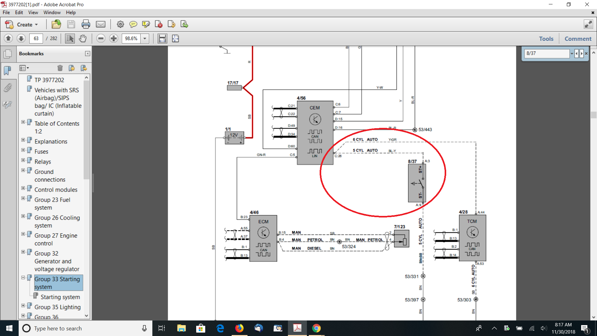

On the wiring harness that went to the automatic transmission, locate the Blue-Yellow wire and connect it to ground, the Brown-Black wire on that harness is the ground the interlock switched used.

Thanks man workt for me!

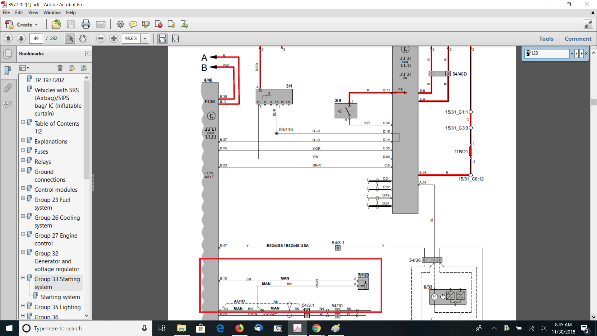

Also do you have any idea about cuting off automatic module? And last thing is cluch pedal position sensor wiers, beacuse for automatic they dint put extra wire for clutch sensor, where under where i shoult connect it as well?

Wires from the Clutch Pedal Sensor run to the ECM pins B4 and B15.
7/123 is the Clutch Pedal Sensor.
