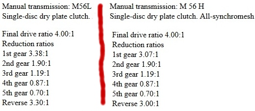

I'm about to do a manual transmission swap in my 1995 T-5R wagon. Had a transmission from a '97 850 but sold it and got one from a '95 850 so I wouldn't have to do anything to the speed sensor set up.
I was trying to make sure I had an M56 H from a '95 but I don't know which I have. The '95 car that I have had the transmission replaced about 18,000 miles ago. I may have an L because the shop wasn't sure. No tag on the bottom.
Volvo 850 M56 L vs M56 H numbers

Shift the transmission in first gear then turn the input shaft then count the turns of the differential then calculate to get the gear ratio.
