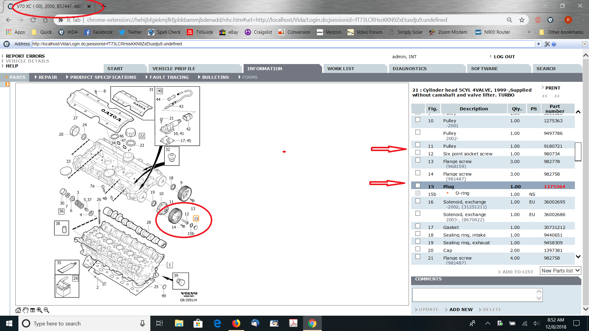

The Six point Socket Screw is Volvo Part Number 980734.
FCP Euro has the Socket Screw for $3.17.
The Plug and O-ring is Volvo Part Number 1275364.
FCP Euro has the plug and O-ring for $6.78.

RickHaleParker wrote: 07 Dec 2018, 18:01 The Plug and O-ring is Volvo Part Number 1275364.
Their site says that it doesn't fit my 2000 V70. Just want to souble check before I order it.

I thought the cap was the head of a bolt. I got the cap that was stripped off and then I was able to remove the bolt.
Is the cap for tue CVVT hub on a 2000 the same as a 2001?
Posts: 36149
Joined: 17 Feb 2013, 17:54
Has thanked: 1610 times
Been thanked: 4068 times
Sorry , I was giving crappy guidance on the hub bolt, not the cap
Volvo parts Lisle says the cap fits many variants from 1999-2009...c
