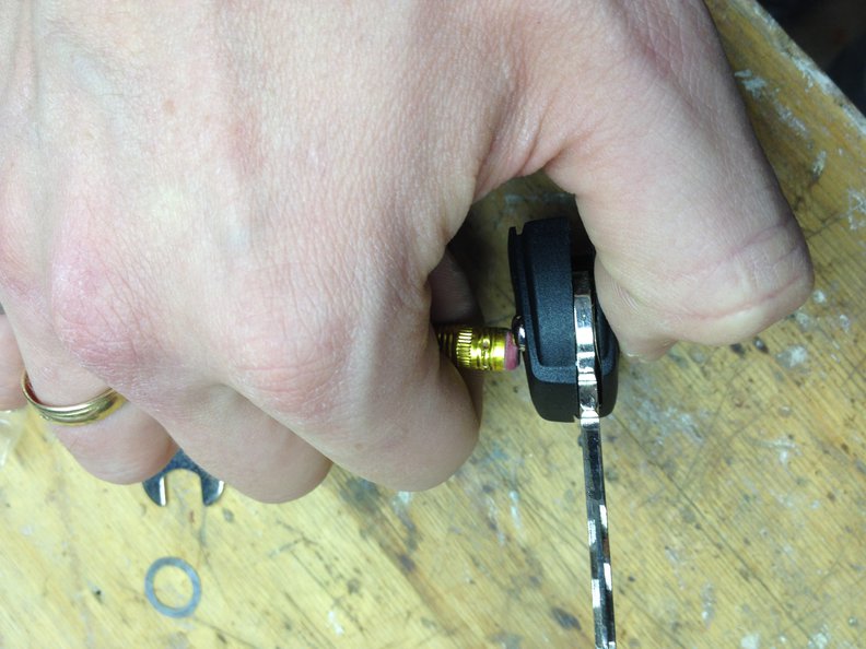

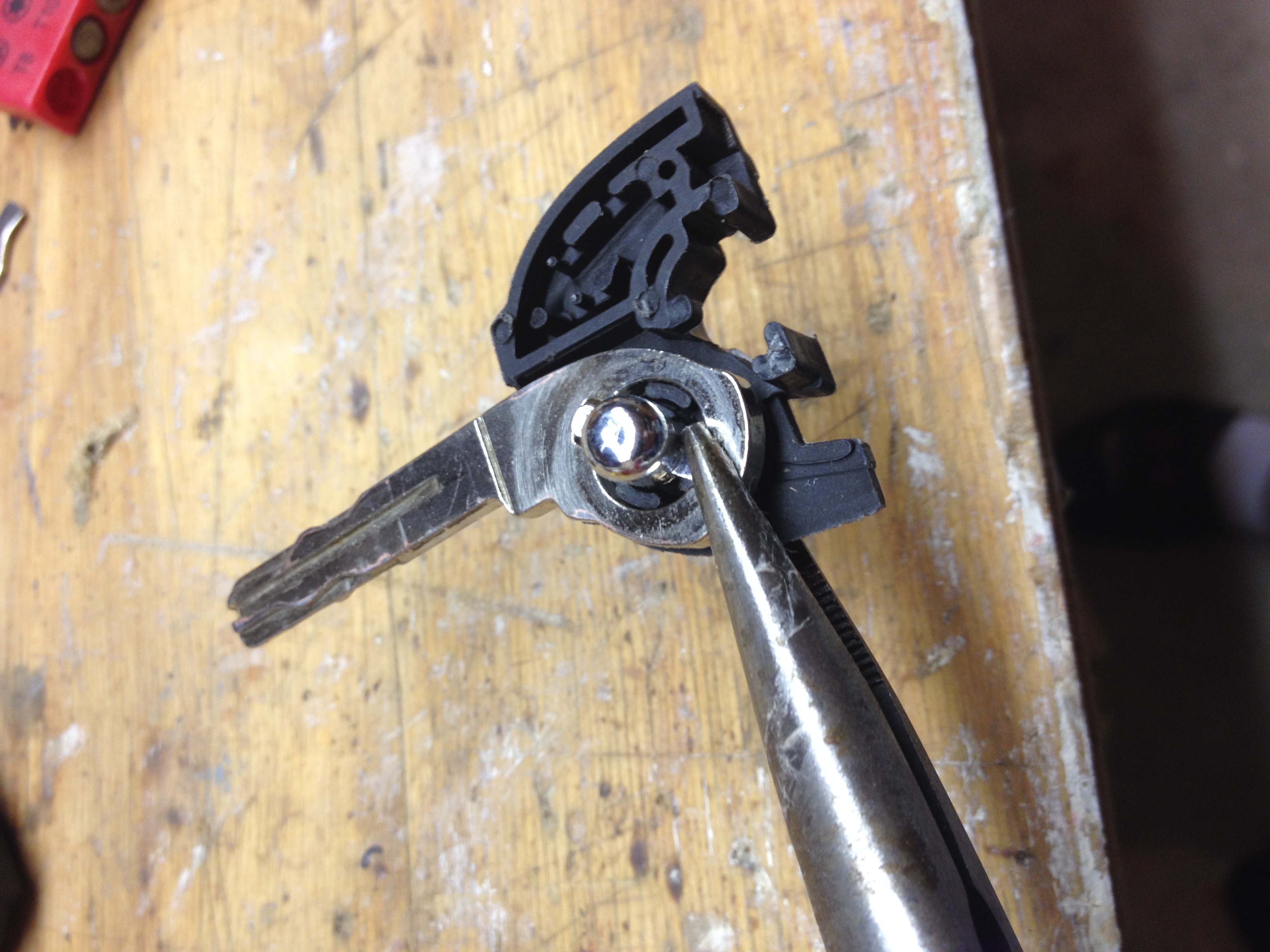

For those who are struggling with the "winding process" (excluding the transponder and epoxy part), the way it worked best for me once the spring and button are in place was to:
• turn the button counterclockwise until I felt the button 'hang on' to the spring
• then, with the key blade in place in the open position, rotate the button until it lines up with the key
• then rotate it 360 degrees and hold it in the keyblade
• Hold it from the lower part of the button that lines up with the blade with your finger tip (not the one my priers are not, see picture)
Winding pic 1
Winding pic 1
• Pass a pencil with a pink eraser through the hole
• (the tricky part) hold on the top part of the button with the pink eraser
Winding pic 2
Winding pic 2
• then you can easily slide the top case part in place into the bottom of the case (see picture)

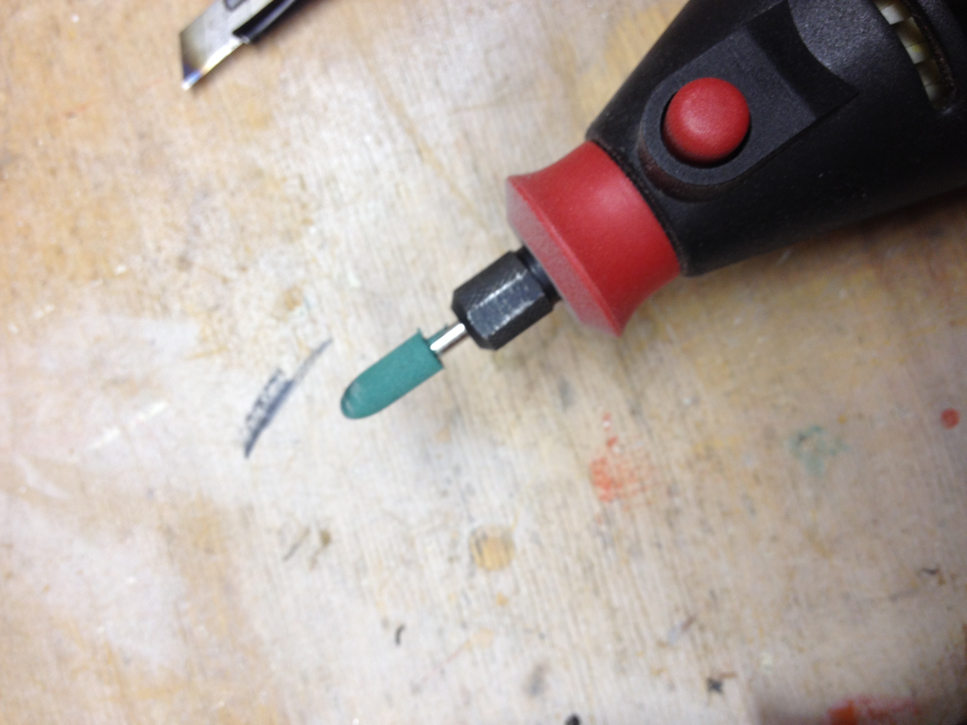

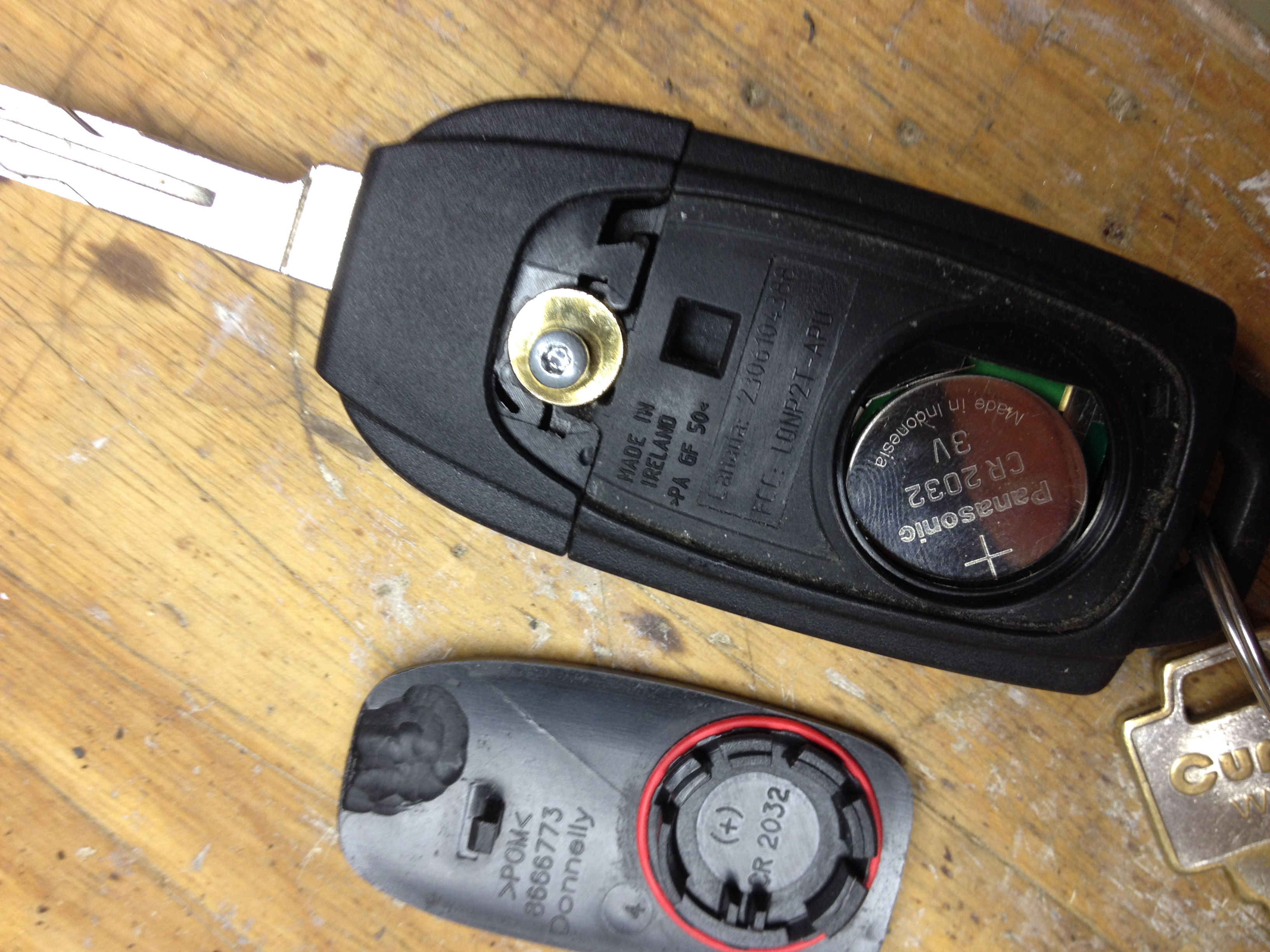

The other thing I did not have was the black epoxy. Instead, I did something I don't recommend to those who want a clean good looking internals solution: I made a retaining ring with a old thumb tack I found lying around. To make it fit I had to shape it and had to dig into the keyfob cover material to make it close properly. Pictures below are self explanatory. The key cover wall is really thin now. I definitely recommend Song's method!
Thumb Tack Ring
Thumb Tack Ring
Thumb Tacks
Thumb Tacks
Rotary tool tip to dig polymer materials
Winding Process 1
Winding Process 1
Winding process 2
Winding process 2
Finished product with ring
rotary tip used for removing polymer material from cover

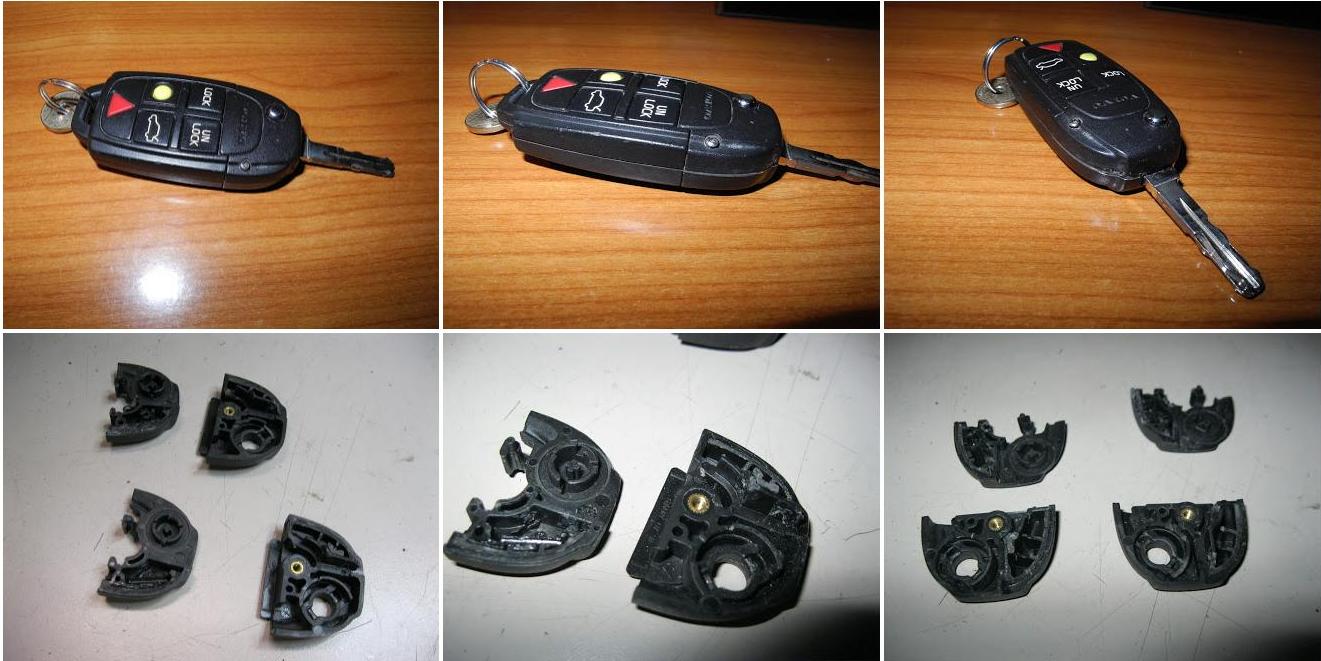

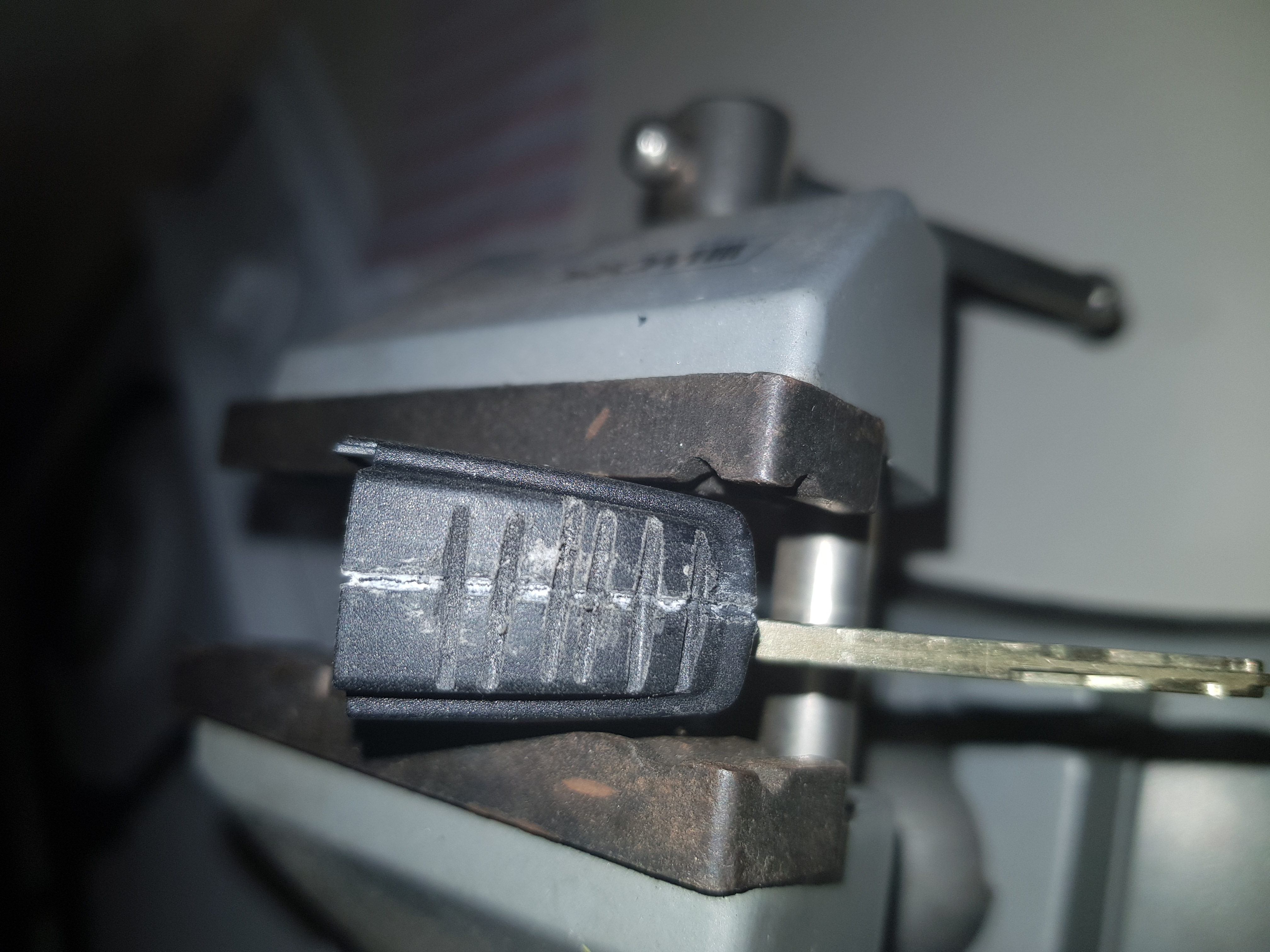

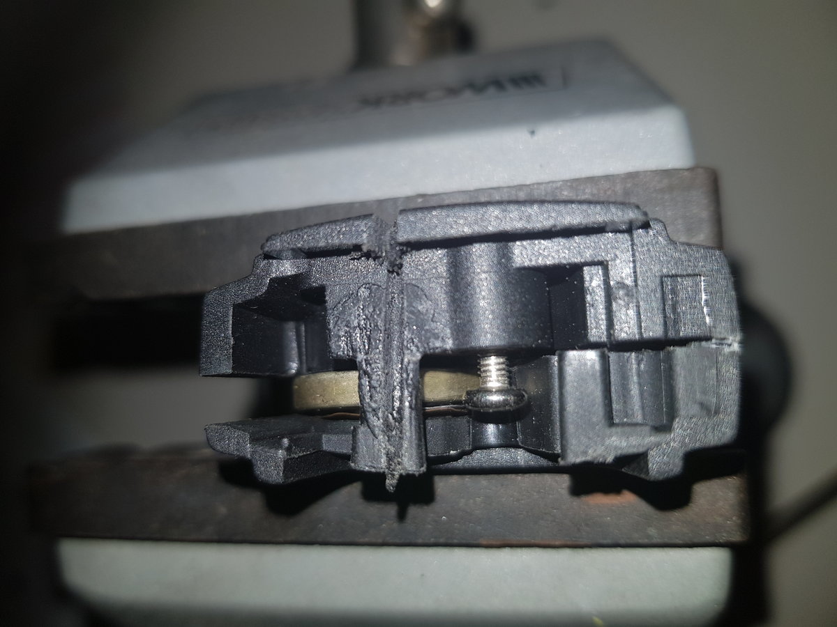

I have done this 3 times now, and have purchased a couple of donor keys because I never seem to get the "fix" to last longer than about 6 months before the case splits. Super glue, epoxy, surface prep or not, eventually they all separated.
Had some hardware around and put in a little torx threaded screw. When you have the case halves open, you'll see where you can get a hole put in for a screw to fit without disturbing the transponder. This fob is still working fine after close to 3 years (fixed well before the original photos were uploaded)- https://photos.app.goo.gl/yXdwL7wrtuboD4K02
I don't cut the donors open, I split them very gently with a largish screwdriver. I found that gave me more original surface area for adhesion when I put things back. I added some photos of prepped key cases (bought a couple for practice), they just need the hole drilled for a screw and the transponder dropped in (I use a dab of silicone now) plus key, a return spring, washer and the metal button to reassemble.

Did another key swap last night, same old issue with glue delamination on the case halves. I used the donor in the bottom middle photo (above) for the replacement.
That little screw is holding everything together extremely well, so much so that I'm going to try just putting clear silicone in the case this time. My hope is that the inevitable flexing at the key/case interface when the key is twisted to start the car can be mitigated by the silicone instead of using a hard adhesive that will eventually split.
One issue I had with this replacement was that the transponder area had some overflow superglue from where I had tried to re-glue the case halves in place. I mention this only to reiterate that the transponder is made of glass and you'll need to be particularly cautious (and patient) with easing it out. I put super glue remover in the space to get things to soften up and let it sit for an hour or so, using a sharp thin blade to ensure the glue had separated from the transponder. Took a while to get it out.
I'll update the next time I do a swap, can use this post as the timeline to see how long the latest case replacement will have lasted.
Edit 030819, add photos-
Not bad for a 14 year old key...
2006 V8 Ocean Race #740/800 200k, 2008 V8 Sport 183k

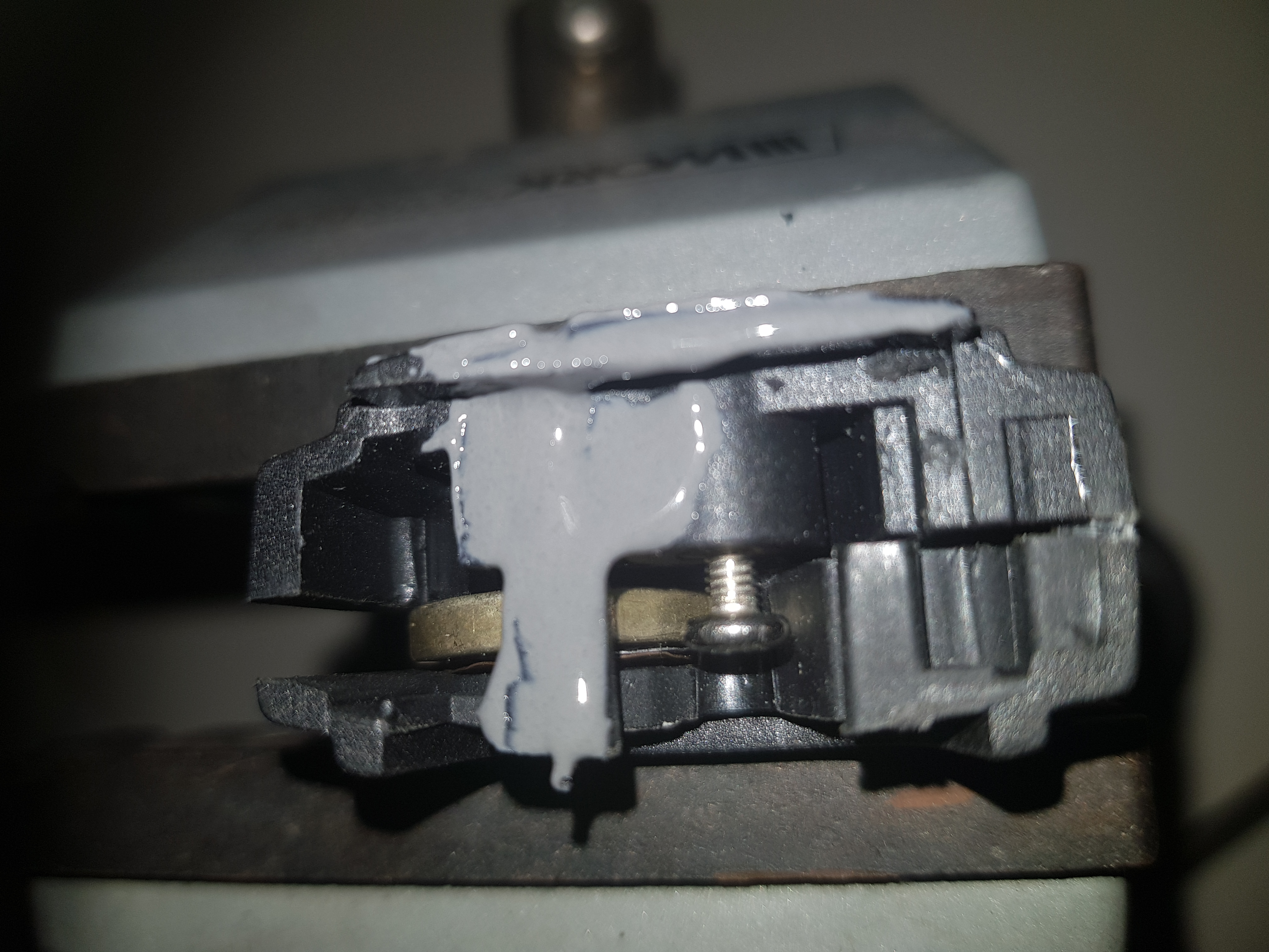

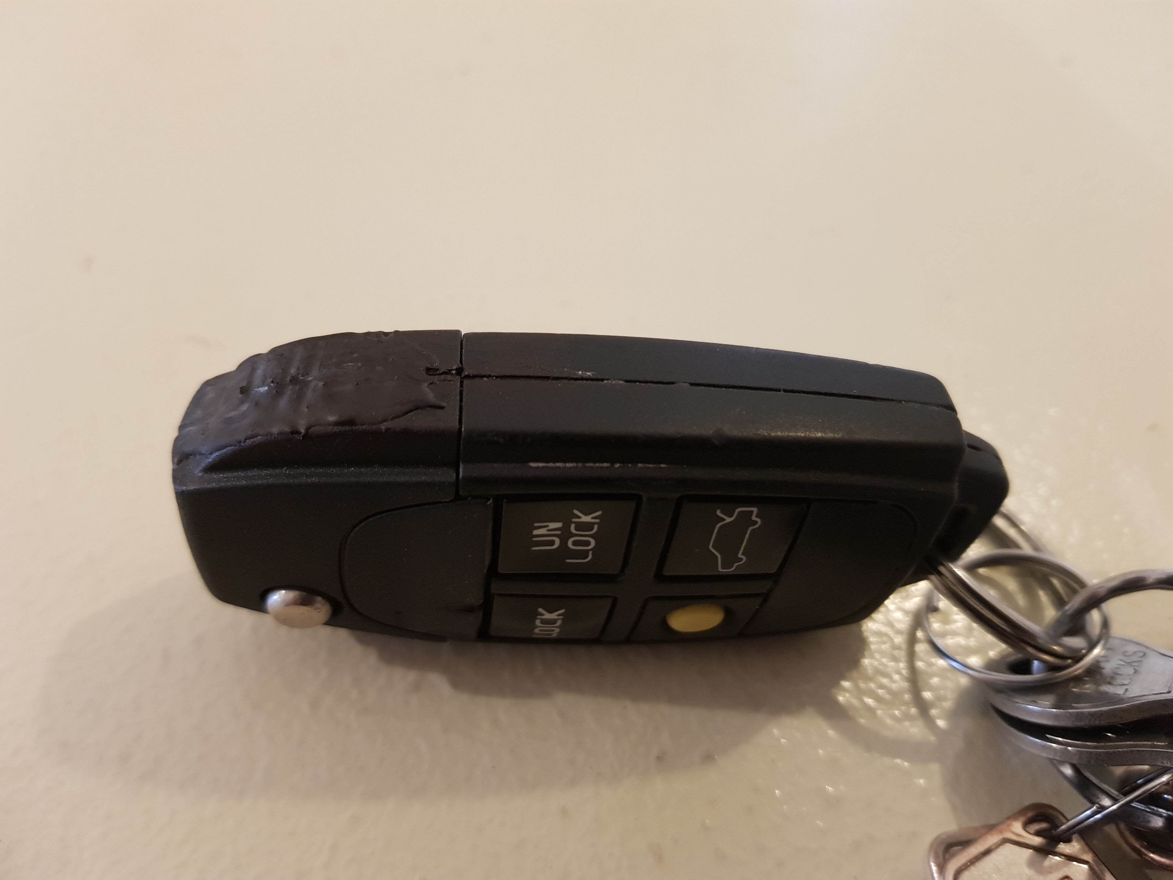

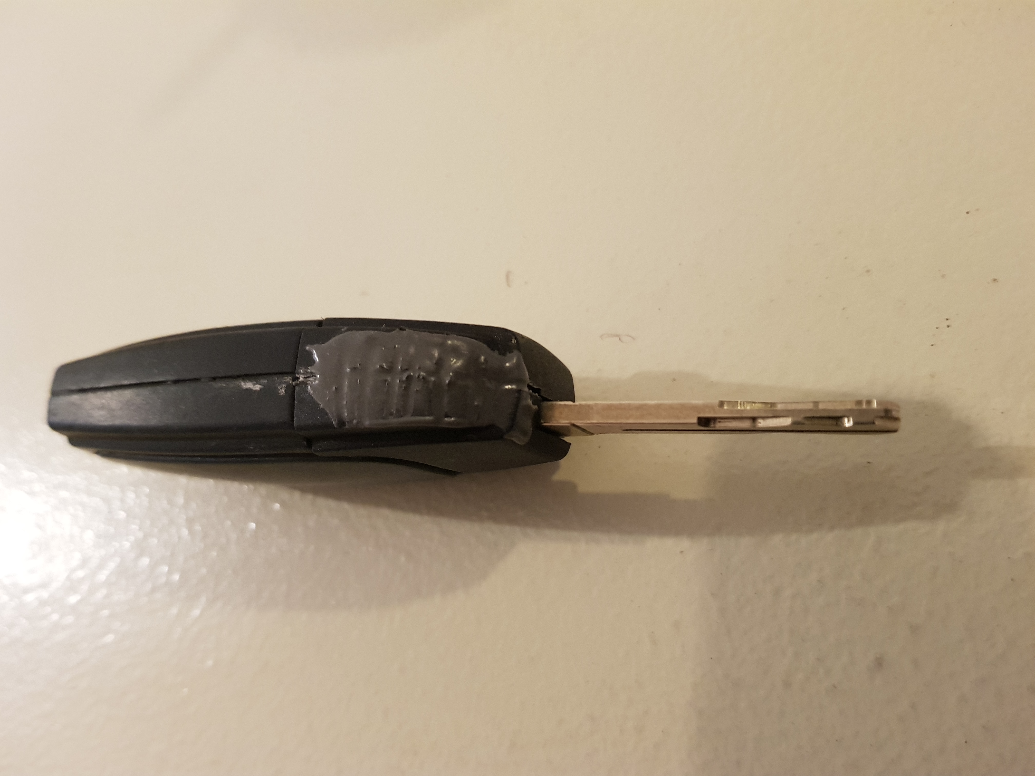

This may work long term. I used a Dremel with a cutting wheel and scored the casing quite deeply on the critcal areas. Then used JB Weld to glue. The theory is greater penetration and surface area.
I had to glue in 2 stages to avoid the epoxy running. Permanent black marker finished it off.
I'll use it and report back in a month ( if it lasts that long) :D
