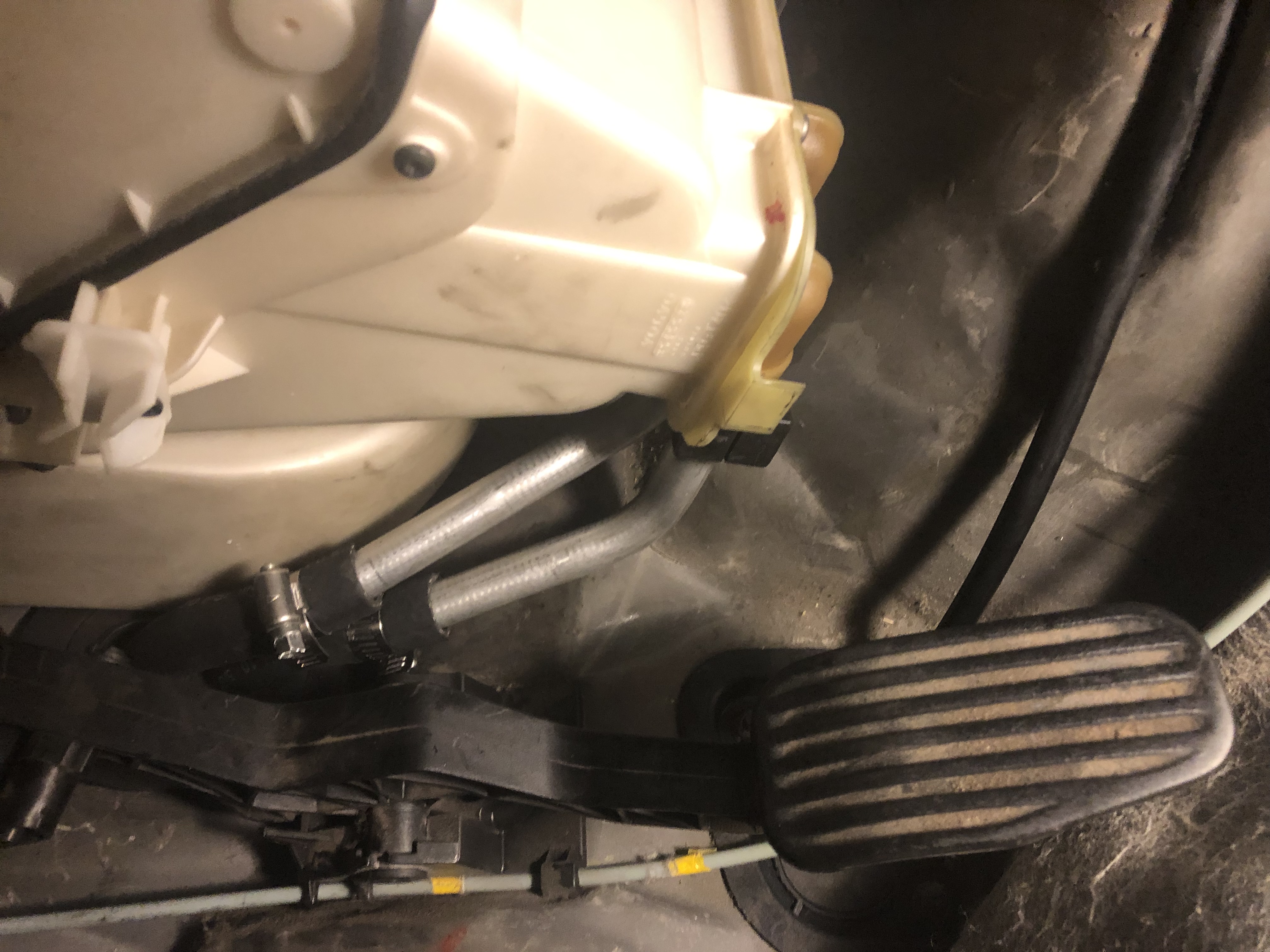

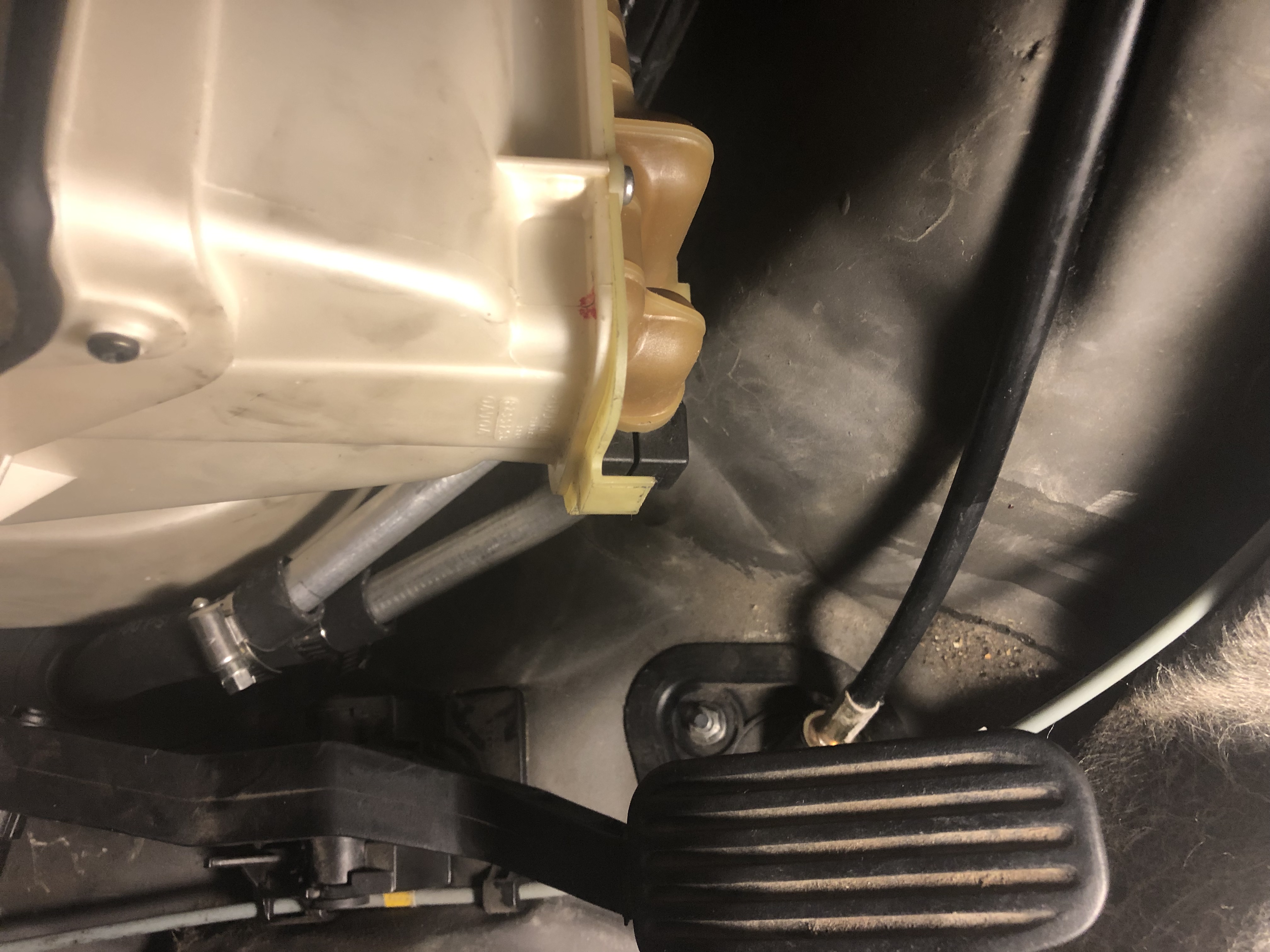

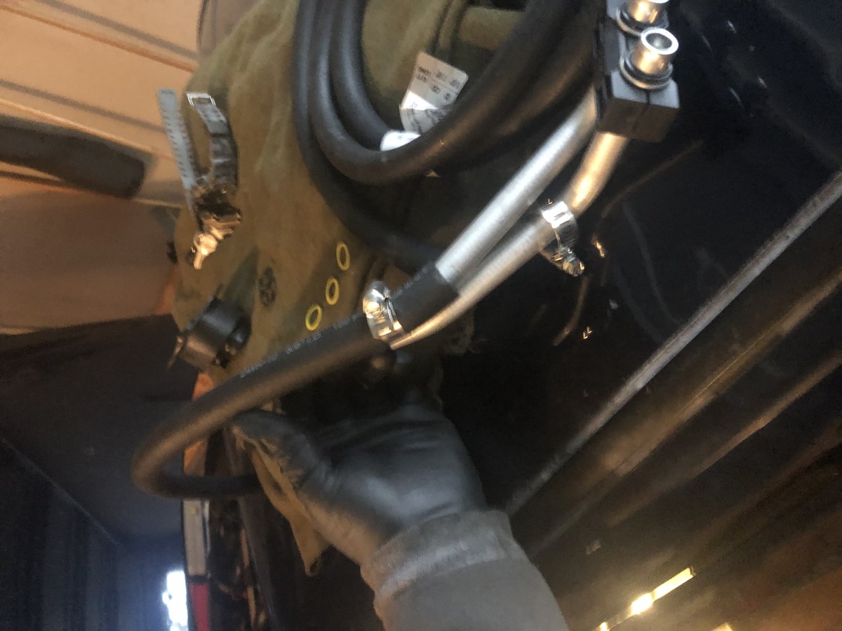

Heater Core junction box delete at Firewall
v70 t5 Turbo 98’
