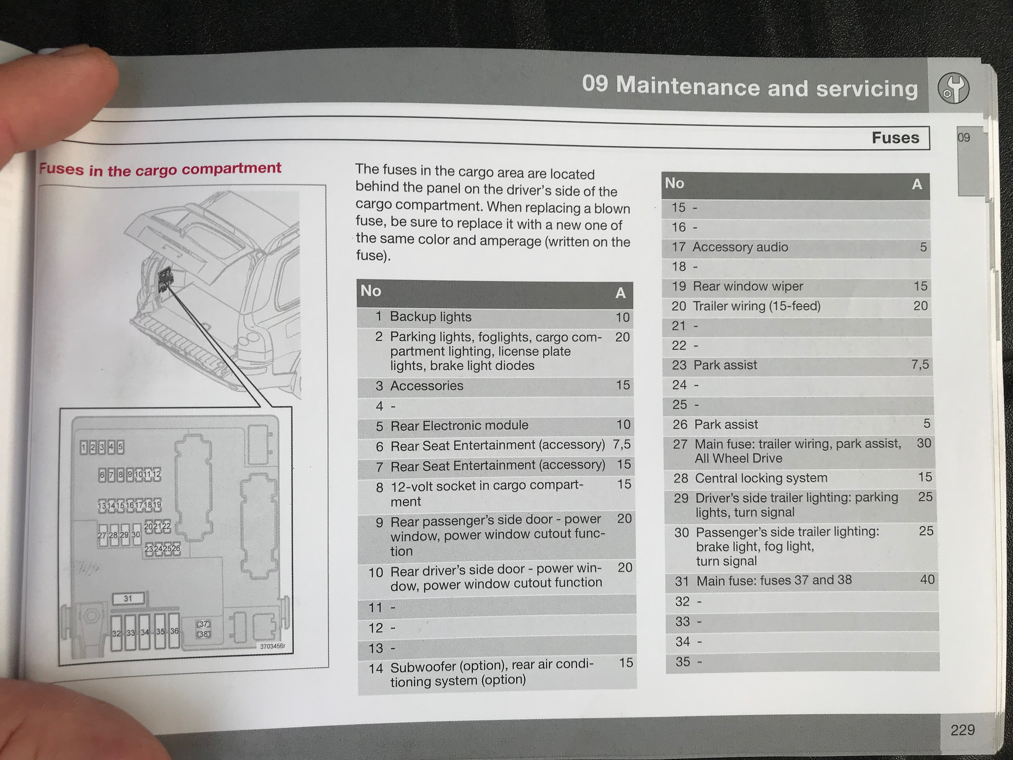

There is either a bad Haldex pump (happened to me) or the DEM. Both are replaceable, reparable. First thing to check is the fuse. Here’s a good thread. https://forums.swedespeed.com/showthrea ... Haldex+dem

This community is absolutely excellent! I appreciate all of you endlessly and I will do my part, to the best of my ability, to contribute to others' questions as well. Though I only made minute progress this weekend, I feel very optimistic that the solution to the problem is within reach. After reading Masscomguru's comment and the link provided, I decided to take a look at my fuses. Fuse #27, as shown in the attached image of the users handbook, was in a healthy state and showed no signs of being blown; however, fuse #23 (Park assist) was blown. What a great feeling it was and indeed still is to know that this blown fuse is telling me something that neither the Volvo dealership nor the Volvo specialist could tell me. Whereas the specialist was suggesting that I needed to replace the entire rear axle, but that in doing so he could not guarantee it would fix the problem, and Volvo recommended replacing all kinds of things for an enormous sum of money while simultaneously being unable to guarantee a solution, this community has been far more helpful, and for that I am super grateful.
I proceeded with replacing the blown fuse, but the fuse subsequently blew again pretty much immediately. I felt both disappointed that I could not fix the problem for the cost of a new fuse (ridiculous, I know) and excited to know that this fuse, but especially this community, is revealing the root cause of the Anti-Skid issue.
Immediately after discovering the issue with the fuse I decided to detail the car to an extreme degree and had the absolute pleasure of driving her spotless self all weekend knowing that, perhaps, I could also give her her legs back soon. Please let me know if this particular fuse closes any particular doors of potential causes and reveals anything worth exploring further.
I have made arrangements to access a car lift to replace the pump if that is the most logical thing to do. If so, I will surely document the process thoroughly for the purpose of contributing to the cause of this terrific community!
