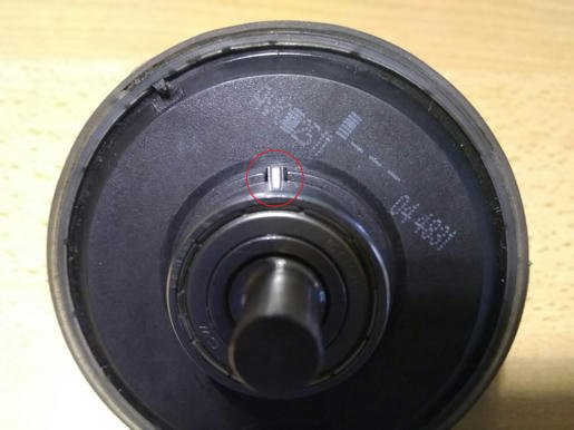

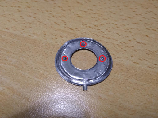

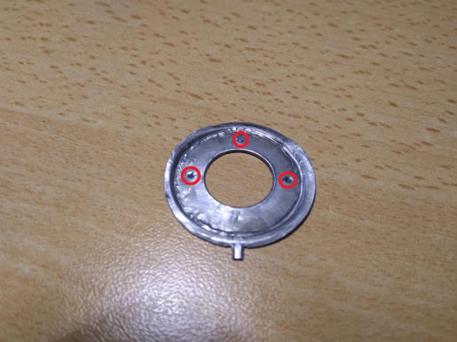

Hi there,
I am re-assembling the ABS motor after having cleaned it, would anybody be able to confirm me if the washer under the bearing is set in the right direction?
I took pictures before disassembling the motor, but due to a shade, that detail is no visible.
Thank you
Alex
Thank you
Alex

I would expect to be the other way as on picture one, the three little dots, I would not expect those to be in contact with the bearing.
Also, do I need to put some grease between the washer and the bearing?
Finally, does the bearing need to be pushed to the bottom of the shaft and be flushed with it or slightly higher to allow the bearing to work freely?
Alex
Alex
