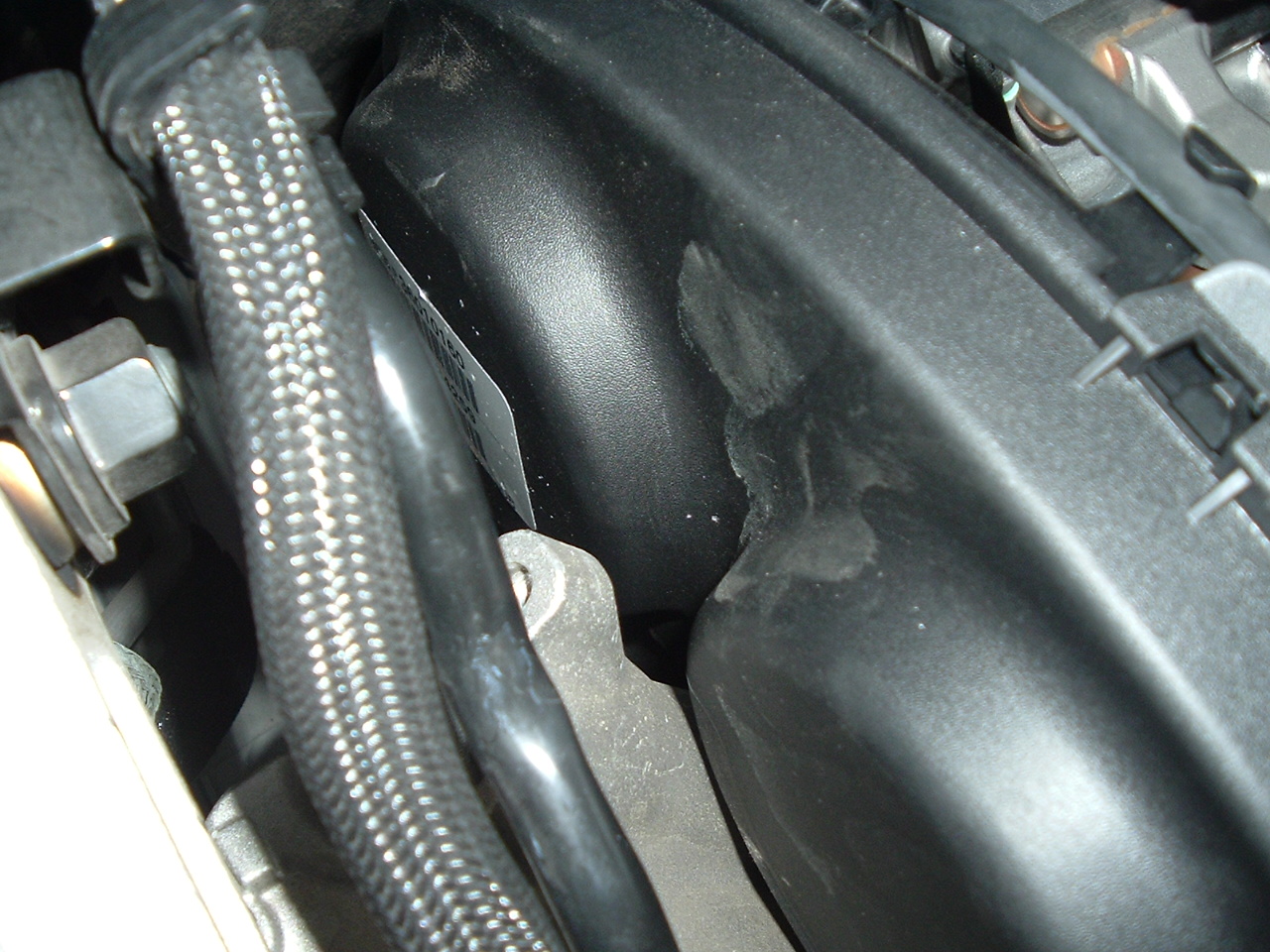

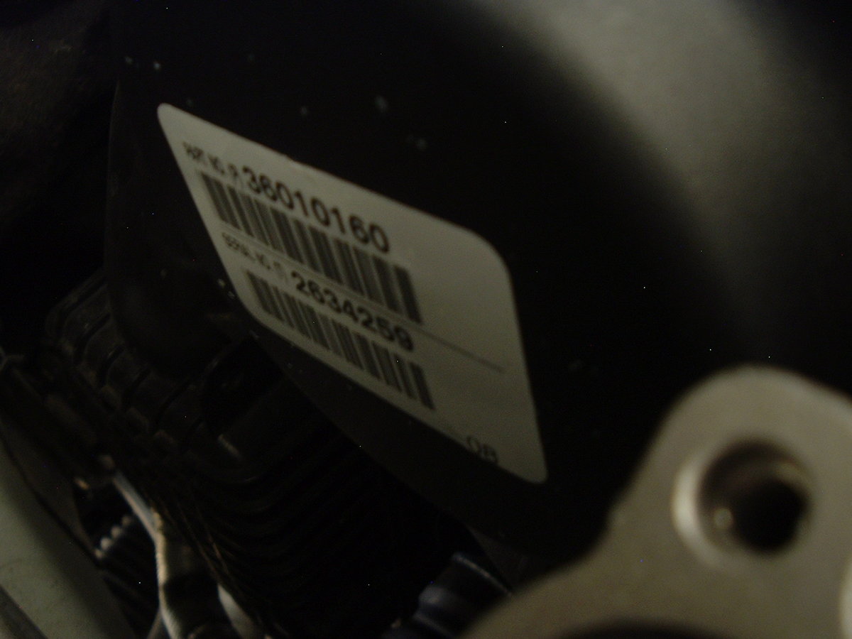

Thanks Jim and Rick,
I did find the Engine Label on the timing belt cover. See Eng Lbl-1 and Eng Lbl-2.
The Engine Label reads as follows:
Part No. (P) 36010160
Serial No. (1) 2634259
According to the Owner's Manual, Volvo offered four different 4-cylinder engines for the 2015 XC60.
The engine designations were: B4204T9, B4204T10, B420411 and B404T12.
With the help of the Parts and Serial numbers, can anyone tell me if I have a T9, T10, T11 or T12 engine?
Any help will be appreciated.

It looks like Part No. 36010160 = B4204T11 BUT it is not clear if 36010160 is a engine exchange number or specifically the B4204T11 build.
Run your VIN number thru the Volvo Tech VIN Decoder, it should list what engine was installed.

Not sure if this was solved; I just happen to have a 2015 XC60T5 with the T11...
You can look up the engines here:
https://parts.volvocarslisle.com/p/Volv ... 10160.html
and then narrow down by your Chassis Number. Hope this helps.
