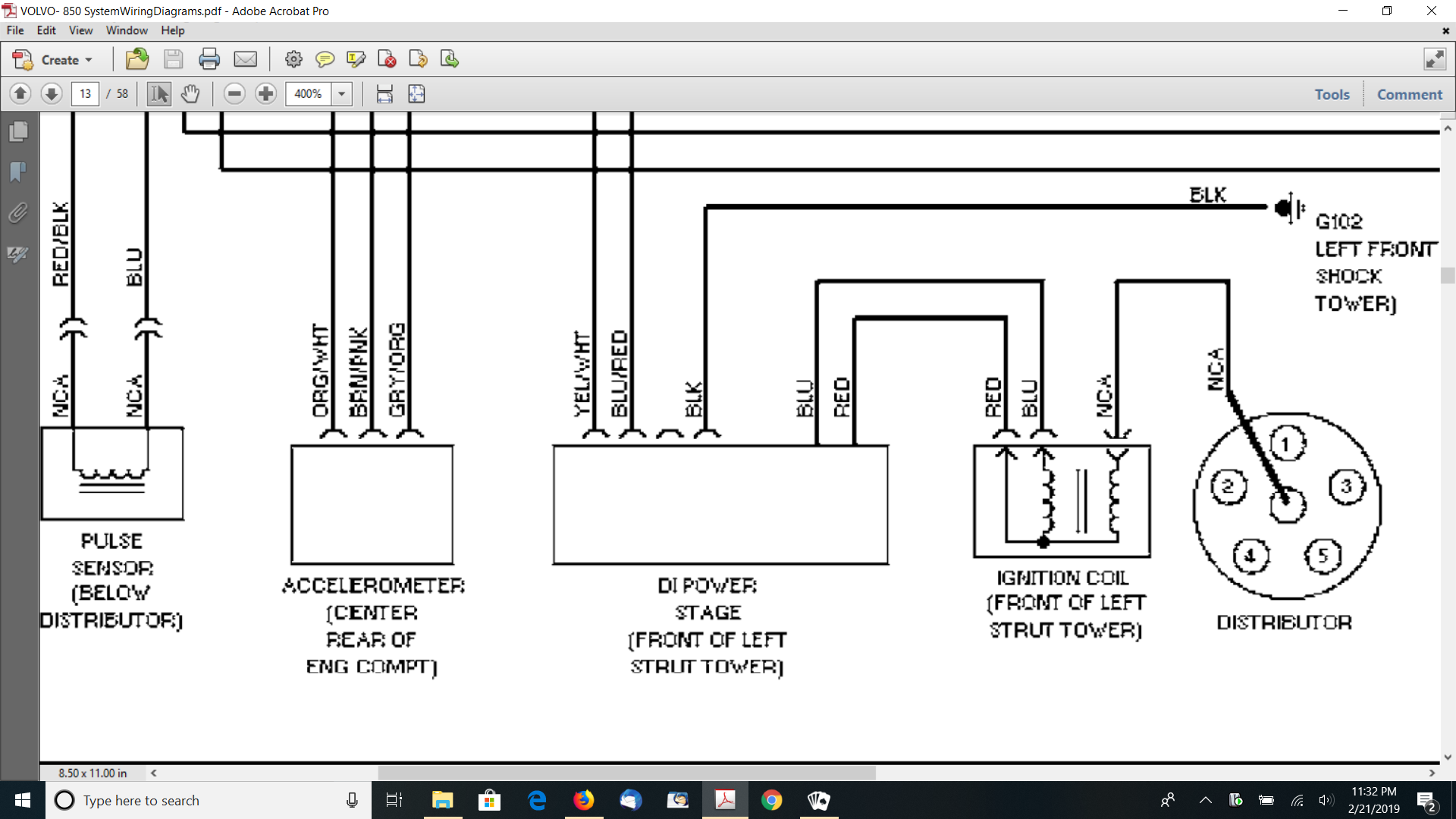

Take a Computer Safe Logic Probe and trouble shoot the DI Power Stage.
Commands to fire will show up as pluses on the DI Power Stage when the engine is cranking.

If you do this make sure you using a Computer Safe Logic Probe.Rubenrodri126 wrote: 21 Feb 2019, 22:40 How can i do that i have the probe but what should i do try every cable? That looks complicated
The old type with a incandescent bulb can over load the ECM and blow out a port.
Moving from left to right on the DI Power stage:
Yellow/White is the power to the DI power stage, this should be a steady positive voltage.
Blue/Red is the signal from the ECM, not sure if it is + or - but it should pulse as you crank the engine.
Black is the ground for DI Power stage, it should be a steady negative.
Blue is the ground for the coil primary windings, it should be a pulsing negative as you crank over the engine.
Red is the positive for the coil, It should be a steady positive voltage.
