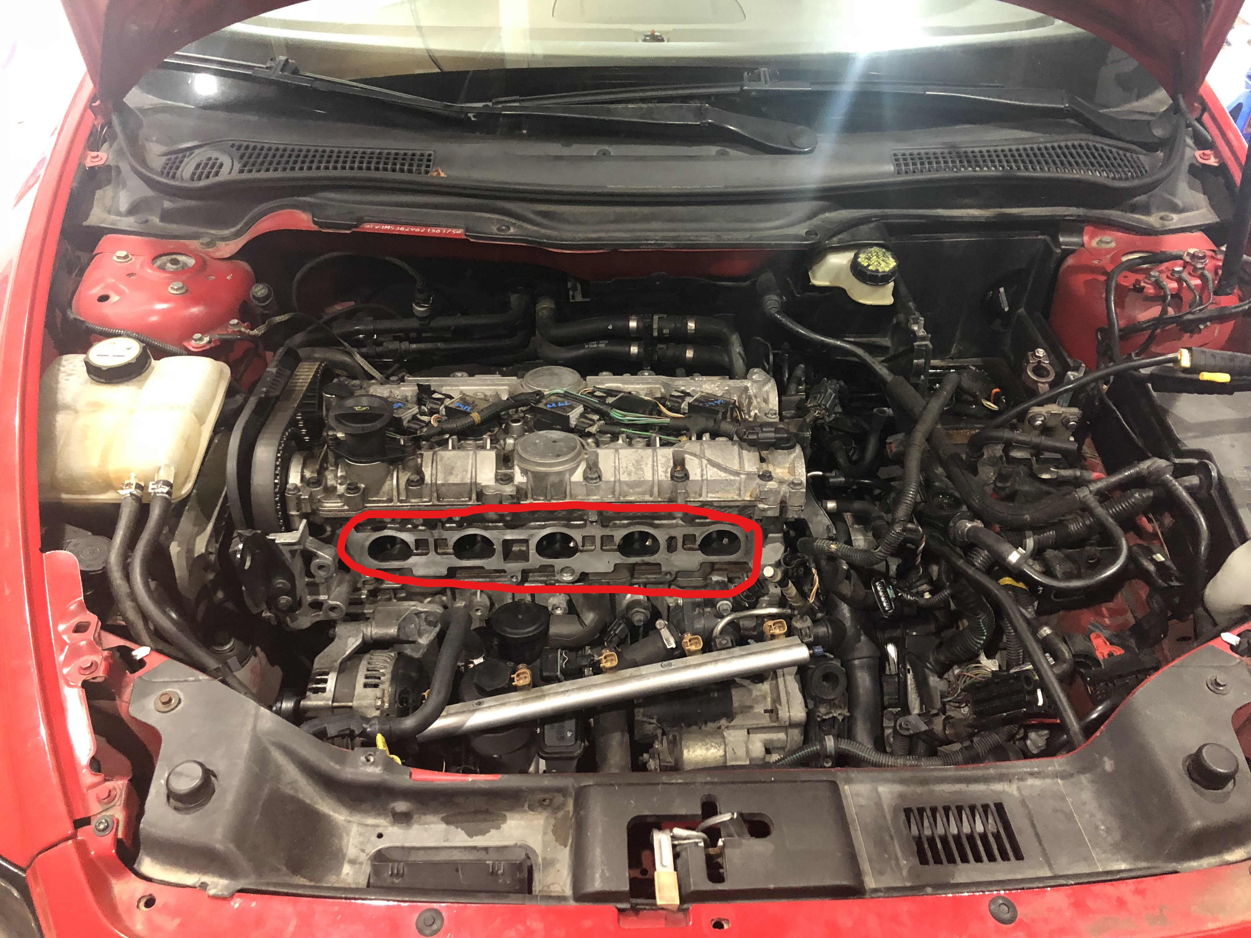

The bad gasket that I found was on the air intake that faces the engine block. I was spraying the upper section which some of that cleaner got into the lower section and started to act up. The code went away and has not returned since.
In your case when the code comes back how long does it stay on?

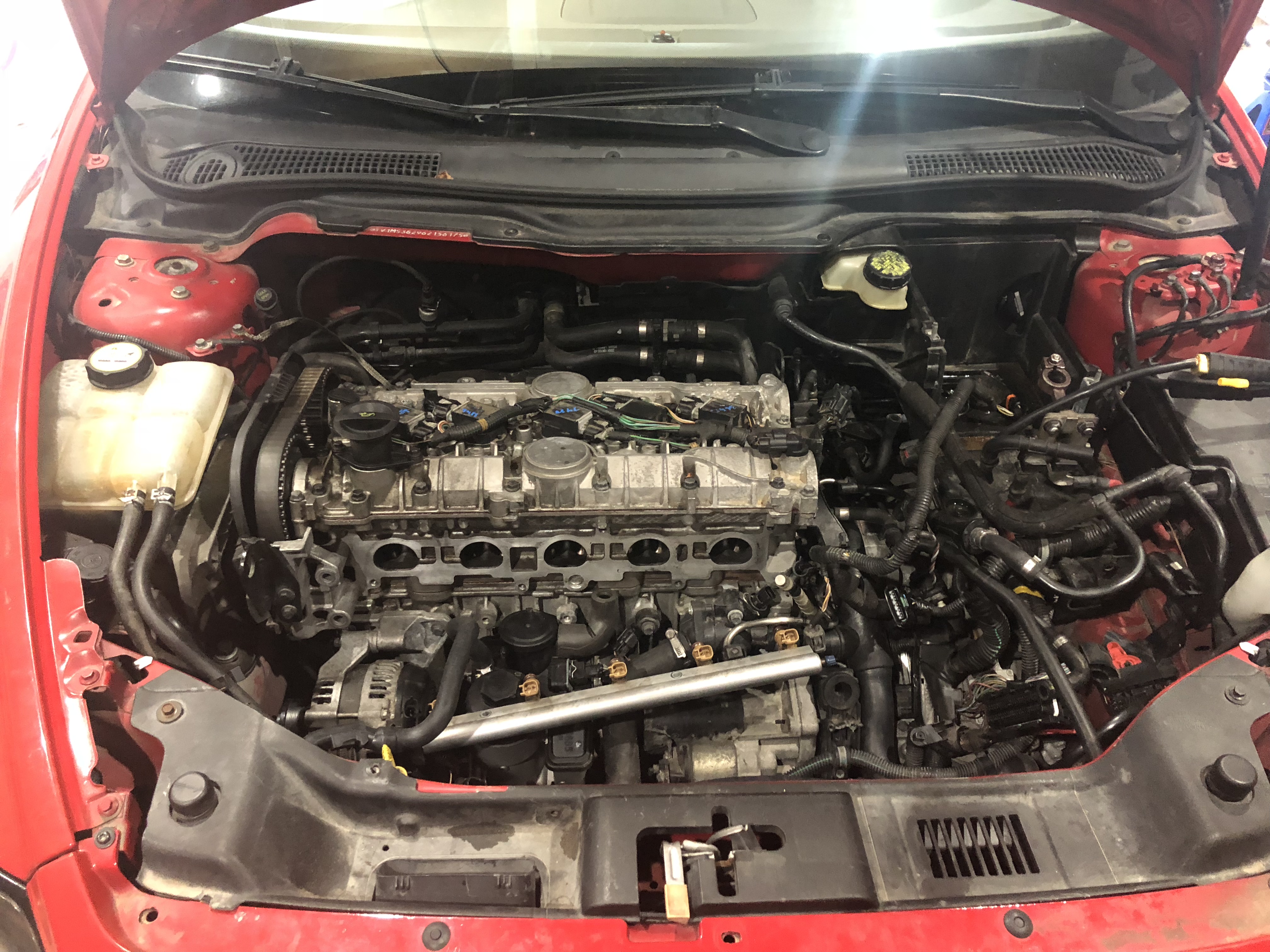

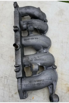

Well in that case the code never goes away, the only reason it goes away is because you have cleared it manually but it comes back within minutes. You still have a leak somewhere.. Looking at the picture above mine was in the lower section. Your Air gets sucked in through the upper intake manifold (the big plastic peace) then goes through the lower intake manifold the (Iron made manifold) seen in this picture
That connects to your engine block (against the cylinder head) In order to remove that peace you will need to carefully move the fuel rail out of the way so you can re-install the new gasket, if that's what's bad. you will also need to remove the Air Box and to remove the air box easier without braking anything I had to remove the vacuum pump as well. From the picture below you will also notice that I have removed the battery as well..
Put is all back together and here are some torque specs
Intake manifold (lower section, against cylinder head): Torque to 19 Nm
Intake manifold (upper section): Torque to 10 Nm
Also worth mentioning is that your lean condition could also be caused by clogged PCV system. Have you inspected the PCV breather hose that connects to the crankcase from the Oil Trap? Also while you have the lower intake manifold off you can inspect couple hoses that are in the area that could also be a suspect. No 1 in the picture bellow.. inspect that elbow and make sure it is not cracked anywhere. No2 in the picture is the PCV breather hose that goes from the Oil Trap to the crank case.. (mine is out of the way) Make sure that on the OIL Trap it's tight. there is a small hose clam on there..
