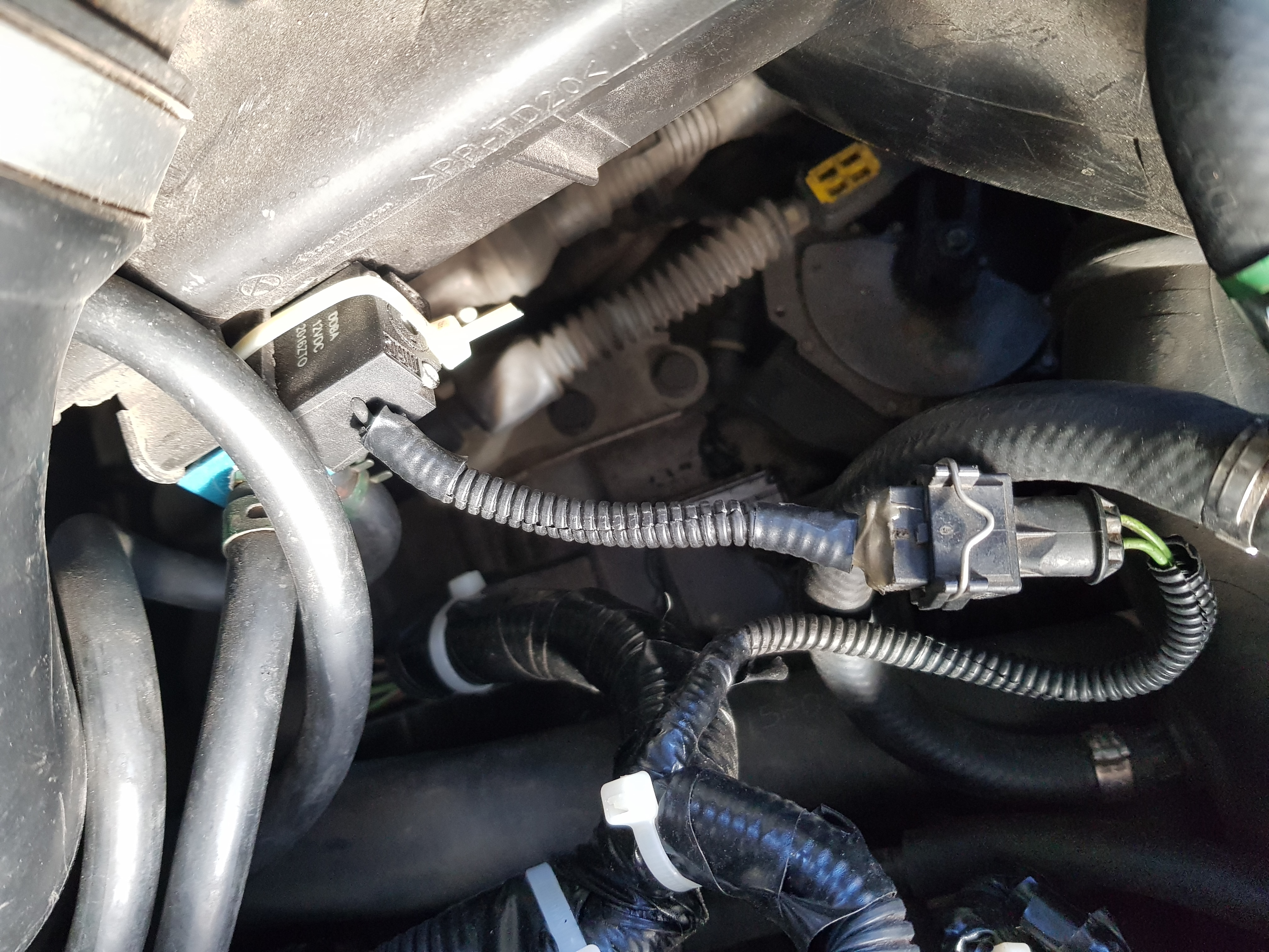

Correct, I also used it like this and this is working on my Volvo S80 2.4T (200BHP).db130 wrote: 12 Apr 2015, 18:50 Are you sure about that? I used the same MAC solenoid back in 2010 for a 98 S70 T5 and I used:
Port 1 - fresh air
Port 2 - wastegate
Port 3 - compressor

Had it sitting around for over a year and fitted it today. Why oh why didn't I do it earlier!! Car now redlines quickly and never hesitates.

As another follow up to the installation of the Mac boost valve I have far better cruising fuel consumption. At steady 80kph (50mph) I'm getting between 38 and 42 mpg depending on the gradient. It's still a pig on fuel around town and that's understandable given its weight.
So by all accounts if you're a highway driver this is the ticket and has already paid for itself in the fuel savings. BTW I went for the cheapest one I could find with fittings and fabricated my own connector to match the car loom.

Anyone have a source for the plug/terminals?
I'm coming up empty on finding the 979153 plug.
I could make my own connector, but that would negate reinstalling the stock type, if needed. (Not too big of a deal, really)

I used a Dremel to cut the connector off the original Pierburg unit then soldered the leads to the exposed terminals. It doesn't look pretty but does the job.
After that I used an epoxy to insulate the terminals so I can go back to a spare Pierburg unit I have if it fails.

I guess that's an option, too. I know I have a couple floating around.
I do have this older IPD BCS that came with a motor I just bought, that I could grab the pigtail from, also.

I've swapped in TCVs where a BCS is fitted to earlier cars. They have the same function electrically and mechanically.

If anyone wants to buy the ipd style actuator and not the MAC one its made by Ingersoll. I have it on my other car

I have been using the Porsche TCV for quite some time with good results, highly recommended. Costs about 25-30 euro/USD

i had the same issue because it was a typo. if you look at the original post pics you can see part number is 978153Chuck W wrote: 10 Mar 2019, 13:33 Anyone have a source for the plug/terminals?
but by the time i figured that out i had already ordered a set of 5 male plugs and 5 female plugs
