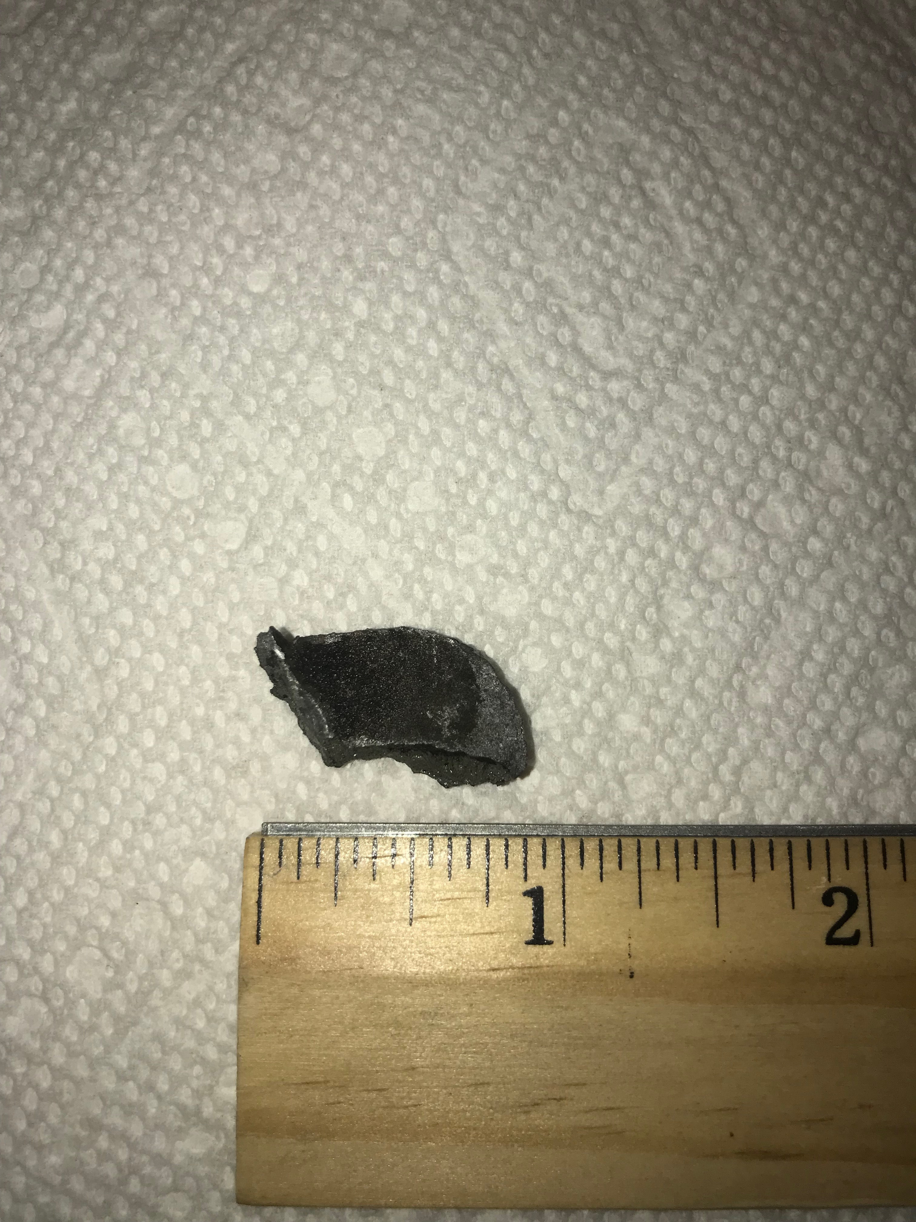

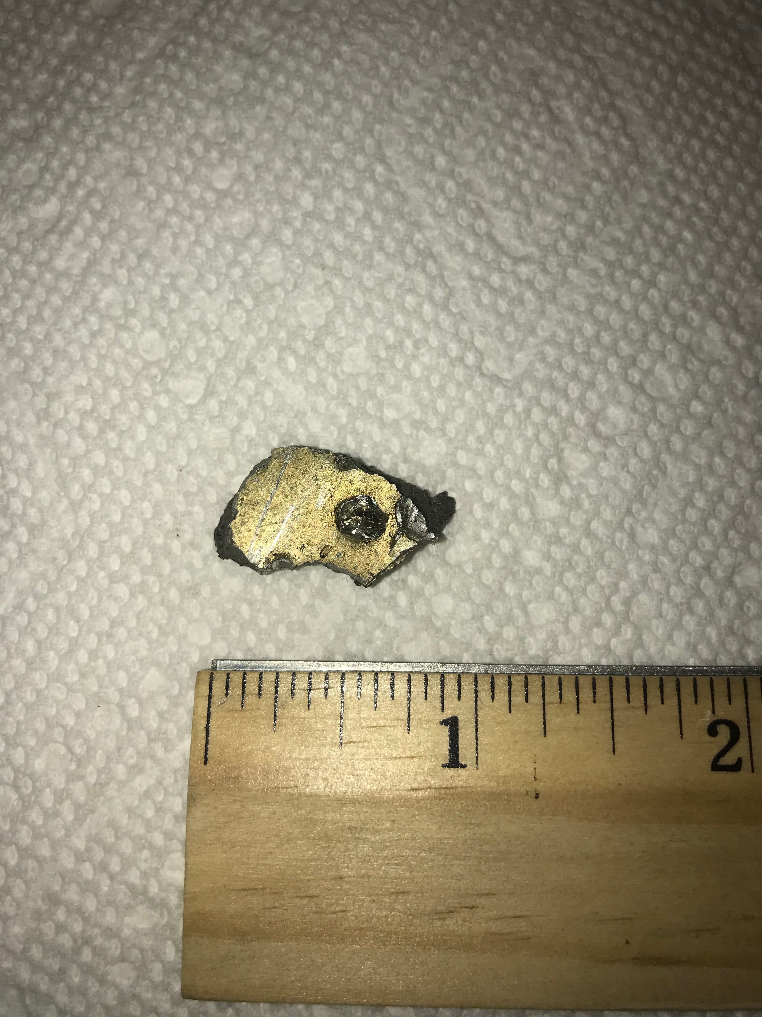

Okay, it was an easy diagnosis; removed plugs, put a long screwdriver in each hole while cranking the shaft. Each piston went up and down...
except number 2 :?
I did find this resting on top of the subframe, though:
Now I'm no CSI metallurgist, mind you, but it is aluminum and it does look like it was struck with a pointed object from inside the engine, forcing it outwards. I can't find any other holes in the block, so I'm not sure if it came from under the oil filter. Doesn't look like the same size, but I didn't have time to fit it today and see.
SO, that was nice and quick, no epoxy needed lol. Now i just need to plan my finances for the next few months...
