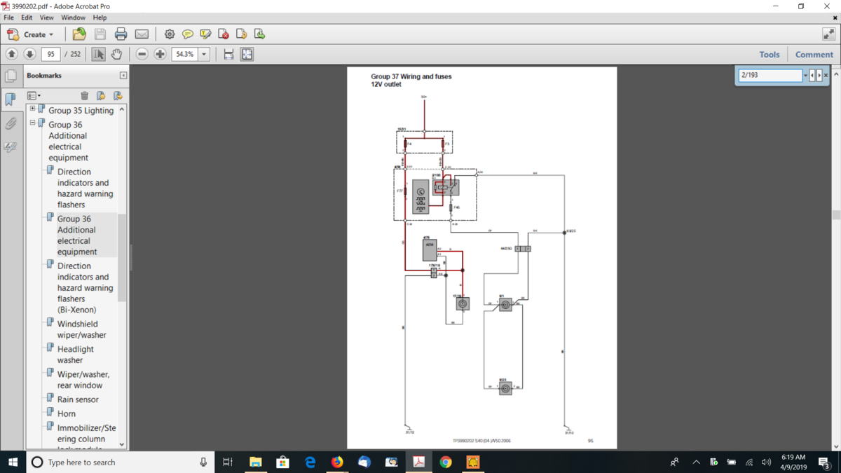

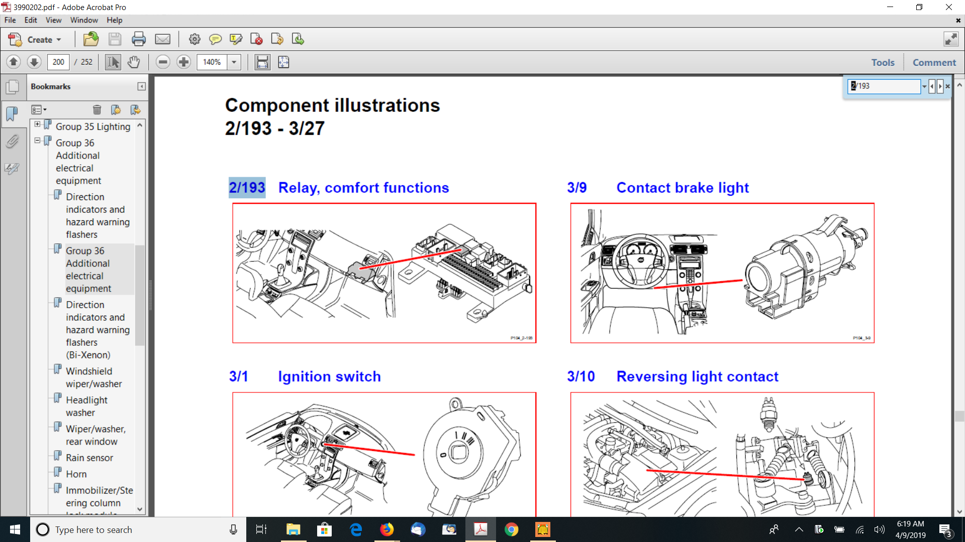

I can’t get my interior cabin 12v plugs (female) to take power. Both the front and rear are dead, but the trunk works just fine. I’ve check every single fuse in the car, literally. Every fuse has power, just not the outlets??? Has anyone experienced this, or know of a common cause? I’m hoping there’s a plug somewhere that’s come loose. I’m trying to shorten my search, before I start taking the interior apart chasing wires.

Fuses F3, F45 and relay 2/193 Comfort Function which is on the CEM under the dash.
9/1 & 9/25 are the cabin 12V outlets.
High resolution screenshots, click to zoom in.
