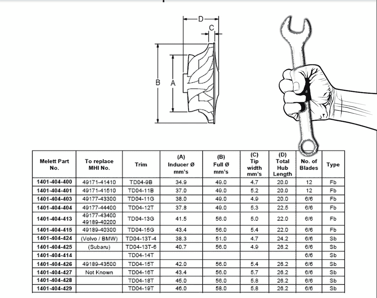

Anybody know if the 13G and 15G turbines are interchangeable? I'm looking to keep a stock 13G and install a 15G output turbine for hopefully quick spool and higher boost than stock 13G.. is this even possible?
The car I am building is a 98 V70XC lpt I'd like to run it till it blows then install a beefed up version 2.0

I've never done this, so I can't speak from experience that it'll work. Not all the specs are the same between the two.
Size/measurement chart and info on 13G, 13T, 15G, 16T, 18T, 19T
FCP has good general info here, but nothing specific about your plan.
US market P80 turbochargers:
- 15G: 94-97 Volvo 850 Turbo, 850 R
- 13G: 97 Volvo 850 GLT, 98 S/V70 GLT, 98 V70 XC
- 13T: 99-00 S/V70 GLT, V70 XC, 99-04 C70 LPT
- 16T: 98-00 S/V70 T5, 98-04 C70 HPT, 98 V70 R
- 18T: 99 V70 R
- 19T: 00 V70 R
