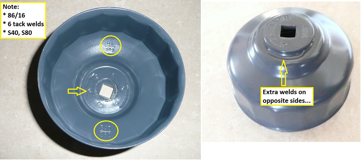

Update,
Just ordered another Lisle 61660 86mm16-Flute Tool from FCPEuro for $7.60/ea.
- It is now painted grey, not black.
- Still made in Taiwan.
- Quality very high.
- Six (6) tack welds on the inside.
- On the outer side: 2 extra welds on opposite sides.
So, if you do minor repair at home and don't have the 21-mm socket for the Assenmacher tool, then the Lisle
tool is excellent bc it uses standard 3/8-inch ratchet.
Avoid the tools (? forgot the brand) that don't have the extra welds on the outside.
They usually break at the tack weld spots.
The newer Lisle tool seems to be a bit tighter, so you may not need to add a bit of rubber on the inside.
Trick: during filter removal, no need to separate the oil filter cap from the device, just leave it there
bc it may be tight. Then during re-installation, once it is snugged and GENTLY tightened, just twist the device
a bit CCW, it will come out.

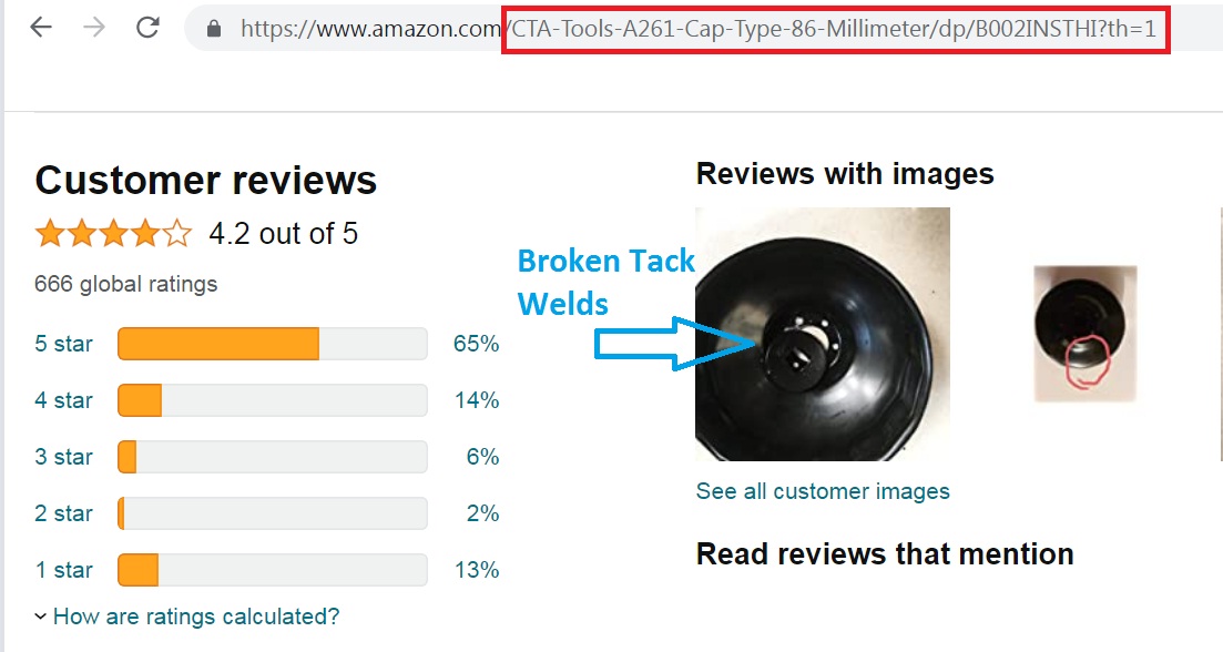

I do not own the CTA A261 tool, but the reviews on amazon are mixed...
The CTA tool does not have the extra welds around the round disc, only 4 tack welds.
So, if your filter is not over-tightened, you may get away with it.
Otherwise it may break.
Or if you have a welding machine, you can add some extra weld on the inside, around the edge of the round disc...
Here is a pic from amazon reviews to show the broken welds on the CTA...

This is an oil filter wrench. If you do your own filter work you will never come close to using enough force to break those four tack welds, especially if you don't whack on it with a hammer or anything. So don't sweat it if you have the CTA tool (I do! Hasn't broken yet ...).
But I do agree with this point: buy the Lisle over the CTA if you don't yet have a tool for this purpose.
