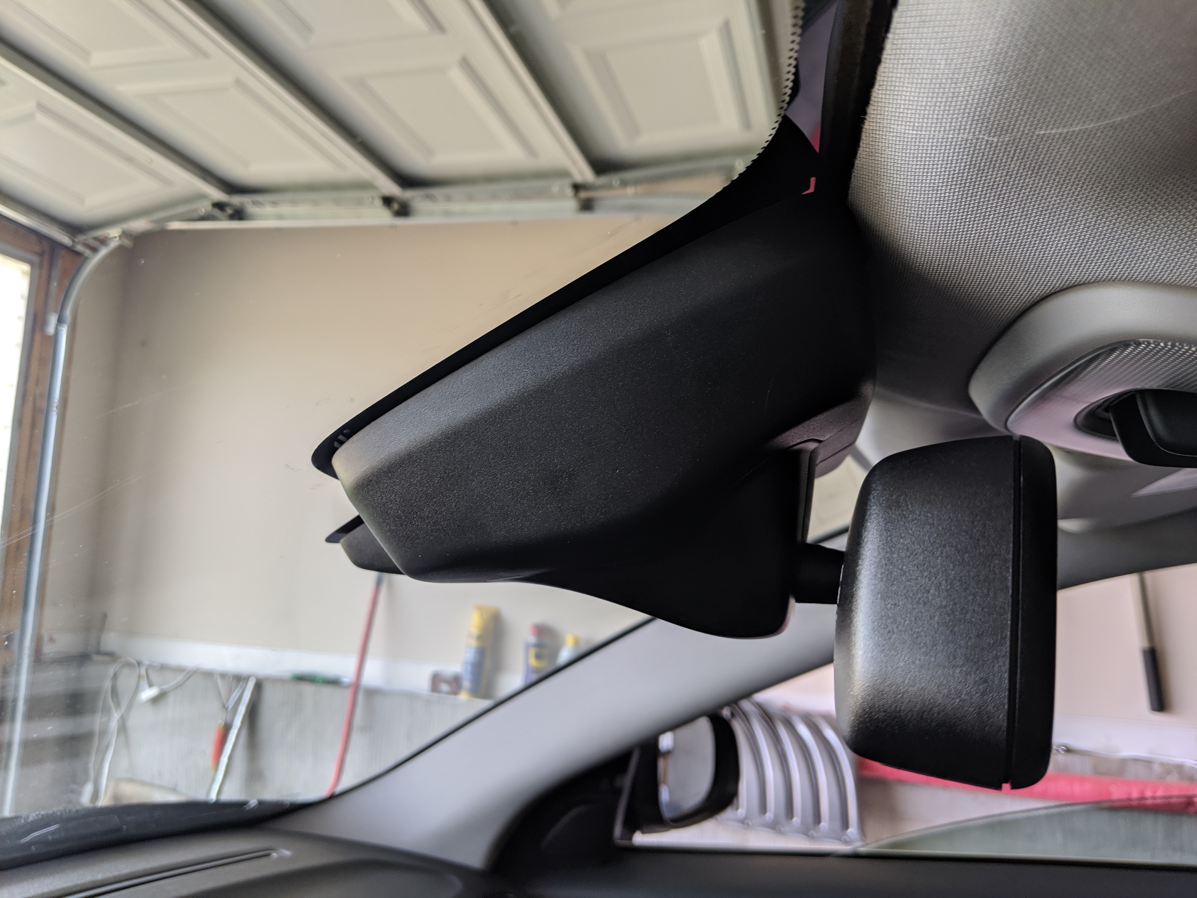

how do you remove this cover
what I am trying to do is get a power tap for my radar detector
I got rearview mount hardware, so I can tap into the power source
with a short wire harness
to get a clean result like this in the second photo

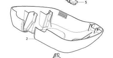

This maybe of help but even when the picture is enlarged it's still hard to tell where it is clipped on?
https://parts.volvocarslisle.com/a/Volv ... 77635.html

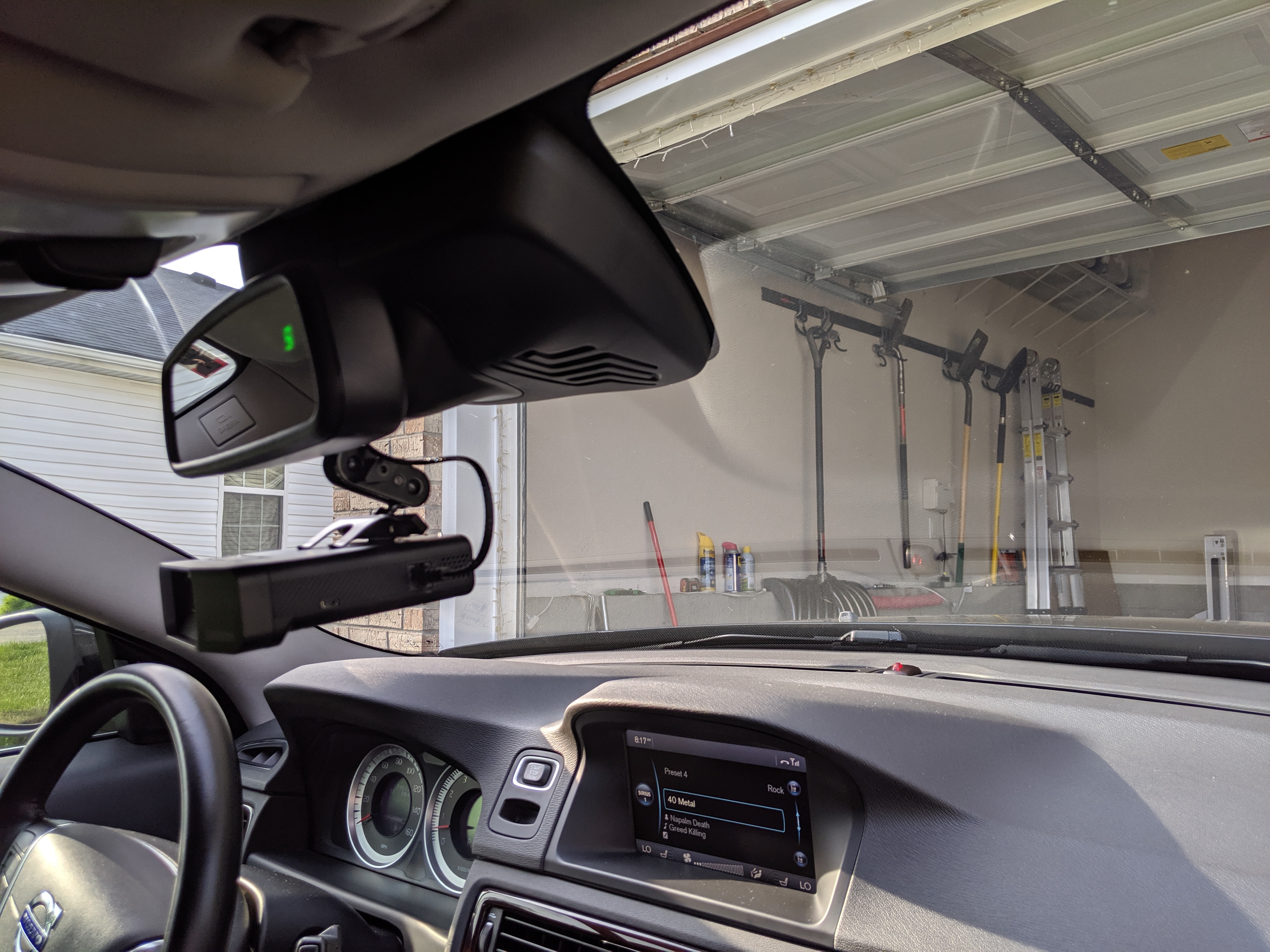

I got this done

HOw I did it
I put my finger inside this part pulled it towards me

Post by nevw »
the pulled this down and towards me
nevw
Posts: 5
Joined: 25 May 2019
Year and Model: 2013 S80
Location: KY
Has thanked: 2 times
Post by nevw »
at this connector stuck the pins black into black wire, red into a blue wire and checked with a multimeter
