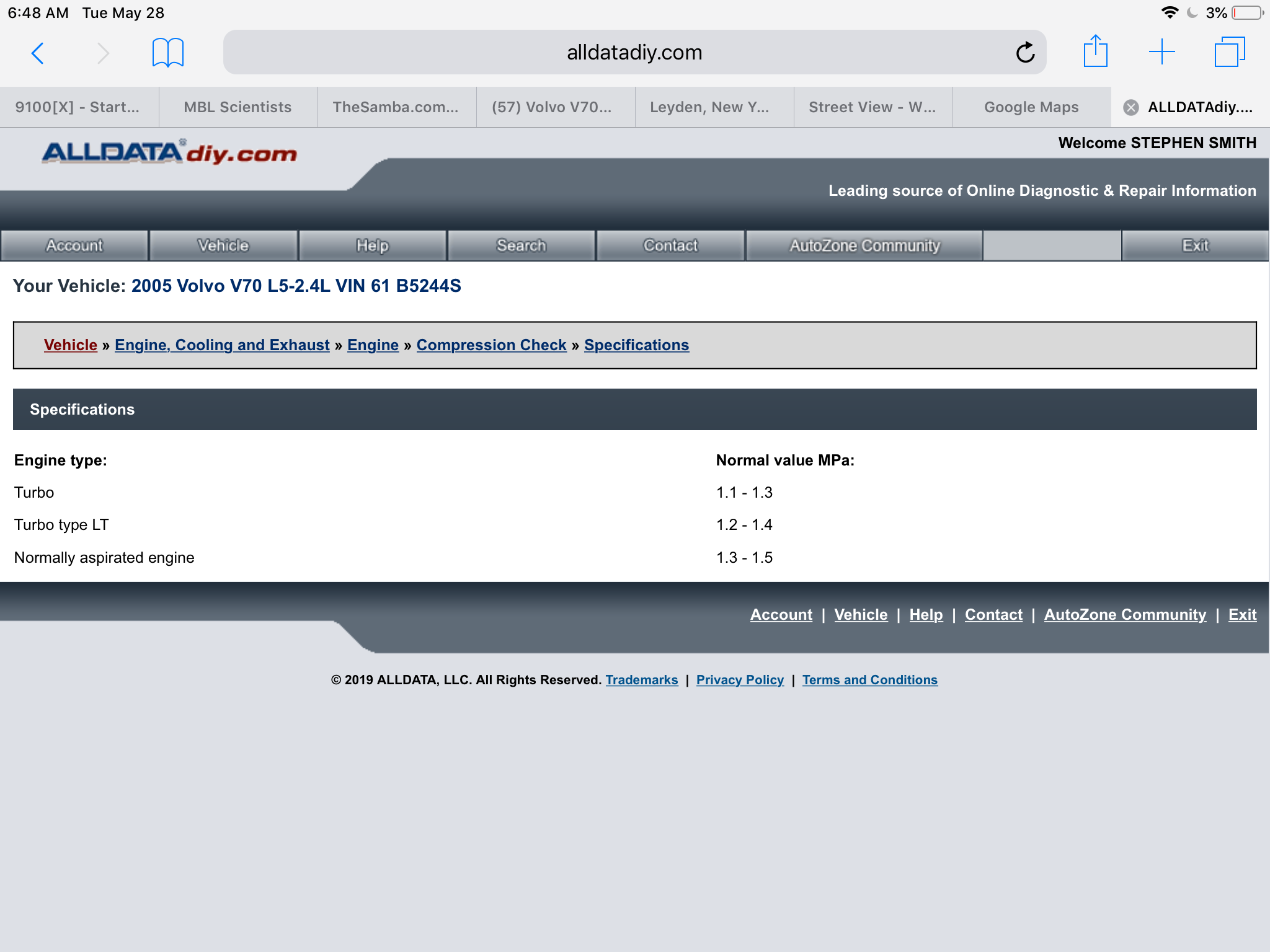

So if I go the used mill route, what kind of compression test numbers should I be looking for in the used unit?

Should be in VIDA , isn’t the R engine unique in stroke/bore.....and therefore compression, too?
Found this in All-data, your science trained lawyer can do the MPa to psi conversion

Don't even know what units MPa refers to.

So roughly 160-190 psi.

- Posts: 36149
- Been thanked: 4068 times
Pascal’s are SI units of pressure.
MPa is 10E6 Pascals
1 atmosphere is 101,000 Pa, so 1MPa is about 10 atmospheres pressure.
I get the same numbers as you in psi
MPa is 10E6 Pascals

Megapascal (MPa) = 1 Million Pasacls = 10 Bars.
1 Pasacl = One Newton per square metre.
1 Megapascal = 1 million Newtons per square metre.
1 Pascal = 0.00014503773801 pound/square inch (PSI)
1 Megapascal = 145.03773801 pound/square inch (PSI)

Would it be catastrophic or too dangerous to just try tightening the head bolts in sequence a quarter of a turn to see if the leak goes away or is minimized a great deal? Years ago I did that with 3 cars but each were leaking oil rather than coolant. 87 Acura Integra, friend's 88? Mitsubishi Galant & 88 Camry. Budget, time and mileage prohibited doing anything else but that. Did work for all 3 cars.

Neither but that is not going to fix a blown gasket. Once they blow they get damaged , so squeezing won’t fix them
It’s also wasted work to get to the head bolts, too.
