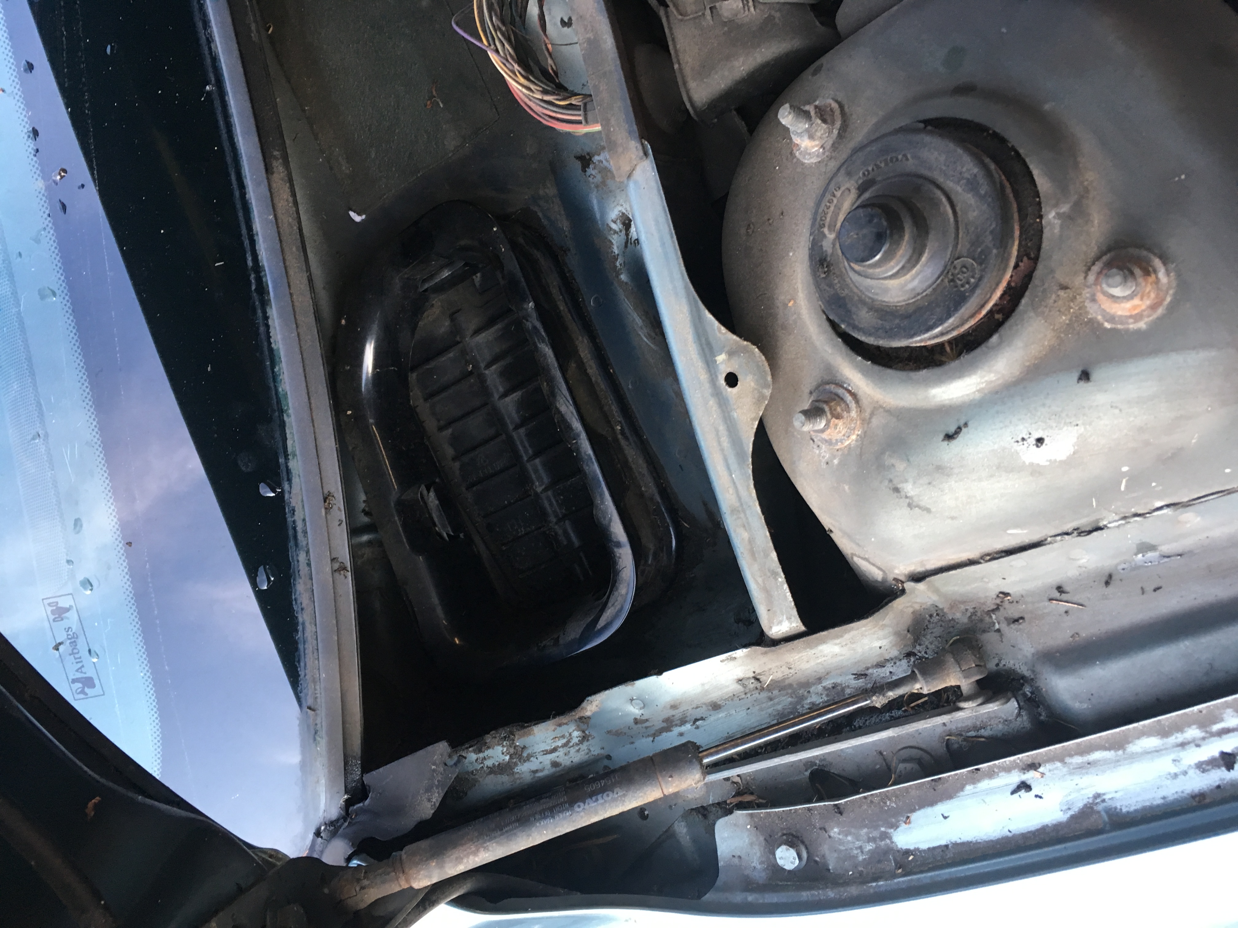

I just came upon this thread which sheds light into my hearing of the record flap opening and closing on its own BUT......I had a big problem with water coming into my passenger and rear passenger wells - thought it was the sunroof but turns out, after the climate fan blew, upon opening the blower motor - it was full of water. Removed and replaced but searched out issue - ever time it rained, water.
Removed cowl and the recirc flap was open but even when closed - water could still pour in - right into the blower. There must be a part missing - a cap or tent like thing, housing - over the black frame of the recirculation flap doors. Anyone know this part # or name or where to get. Guess I could go to a junkyard and check out some v70s.
Pic attached
Pic attached
- Posts: 36142
Yes, you are missing the frame and air filter, but at least you get to smell all the great pizza down in Brooklyn as you drive.
Wait on a P2 I think the filter is down low, let me go look at mine.
