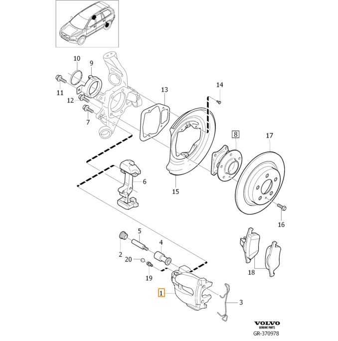

Post by ggleavitt »
Visuals for reference-
XC90 Rear Brakes.JPG (48.66 KiB) Viewed 3521 times
XC90 E Brake.JPG (61.88 KiB) Viewed 3521 times
Emergency brake shoes are not de-laminated and I'll assume they have some material left so no metal to metal there I'll guess. The wheel rotates so I'll further guess the e-brake cable is not an issue.
Only so many parts can make a metallic screeching sound and when I've heard it to a degree it's annoying on either of my cars, the culprit has turned out to be a dust shield contacting a rotor or a heat shield rubbing against an axle (V8 pass side as example). Metal to metal contact is key to this sound in my opinion.
I would get under the car and walk the dust shields on both the front and rear wheels and don't be shy to bend them back some, make sure the outside lip as well as the entire back plate are completely free from contact with any rotating part.
I'll be interested in seeing what this turns out to be. Good luck !
